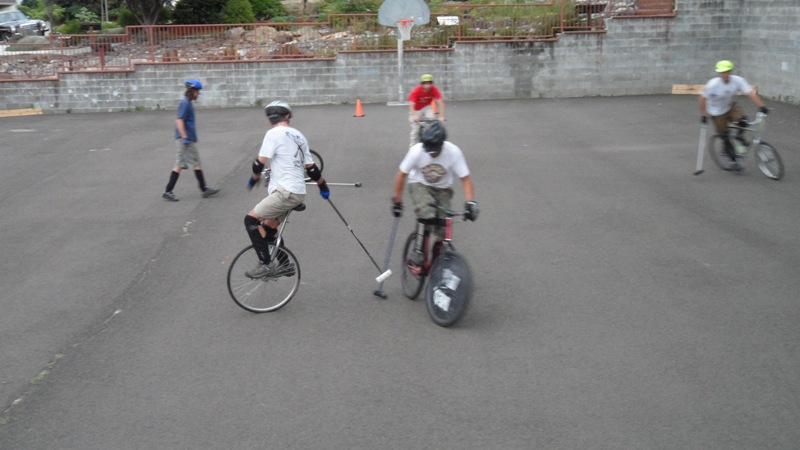

I’ve been having a blast this summer playing bike/uni polo. A bunch of us meet up on Monday night and smack the ball around. There are no hockey sticks involved, just regular home-made polo mallets.
The bicyclists tend to like the shorter mallets (46-48"), I prefer longer ones either 50" or my 52" “cherry picker”.
The bicyclists have a higher top speed but I’ve got better maneuverability, and excel at extracting the ball from the corner dog fights. Having a free hand, I’m better at pushing the bicyclists off their bikes. It took them a while to get used to this, but their ok with it now.
I use a cheapo Sun unicycle with a 700 wheel and a skinny tire. At first I used my KH 26" with a 3" Duro Leopard, but I found that it was sluggish compared with my skinny and agile 700. Also, the fat tire is more likely to run over the ball causing a UPD. Playing on an asphalt court is the quickest way I know to wear out a tire. I need to rotate my cranks about every third or fourth week.
The past few weeks my 13 year-old daughter has been joining us on her uni. She’s a quick study. My 10 year-old son is now getting the itch to play too. Despite the size of the bicyclists they are a pretty gentle bunch. Most of them are dads, so they don’t crunch my kids. In fact, I seem to be the one to want to push and body check my opponents more than anyone else.
Here’s some pics:
Geoff

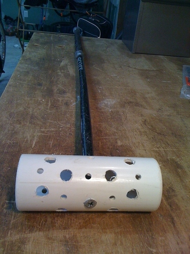

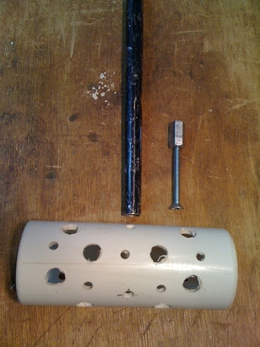

Mallet construction: Maybe I’ll post pics later, but here’s a start.
Get a 52" ski pole. You can always cut it shorter later if you want.
Remove the grip and basket. You may want to cut off an inch or so off of the tip.
Cut a 6" length of 2 & 1/2" inside diameter PVC or ABS pipe.
Drill a hole in the middle of the side of the pipe just big enough for the ski pole to fit in snugly.
On the opposite side of the pipe drill a small hole just big enough to get a screw through. If you make these holes just a tad small, then the assembly with be tighter. You don’t want anything rattling around here. You can always use a rat tail file to increase the size of the hole a smidgen if you need to.

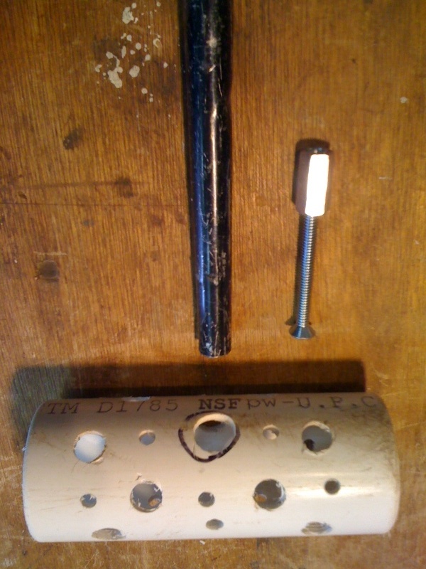

Go to the hardware store and buy a coupling nut and a screw that fits it. The screw should be about 2 & 1/2 to 3" long. A coupling nut is just like a regular nut except that it is really tall, about 1/2 to 3/4".
Drop the coupling nut down the ski pole until it gets caught inside the tip. You may need to experiment with different sized coupling nuts. The more of the ski pole tip that you cut off, the larger the inside diameter of the ski pole tip. That will necessitate a larger coupling nut, otherwise a smaller nut could fall through. Conversely, if you get a large coupling nut and don’t cut much of the ski pole tip off, then the nut will lodge too far away from the tip of the ski pole for the screw to reach it. Make sense?
Put the pipe onto the ski pole and insert the screw through the small hole of the pipe and into the tip of the ski pole so that it screws into the coupling nut. Tighten it up.
Drill lots of holes in the pipe to lighten it.
Cap the grip end of the ski pole with a nickle so that it won’t gouge anybody. Put on a golf club hand grip or make a grip on the ski pole out of an old inner tube and duct tape.
There you go. Have fun kicking bicyclist ass and beating up your friends. :smiley:
Geoff
Here are some pics of the pole, Swiss cheesed mallet head, that funny elongated “coupling nut” with screw and the assembled mallet.
Geoff

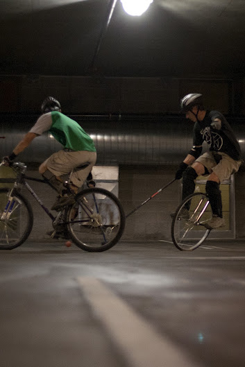

We got lucky and a local photographer wanted to take some pics of us at our new winter court, the local and only parking garage. Here are three of the better ones, including one pic of my daughter tapping back in. If you want to see more, go to:
Geoff
