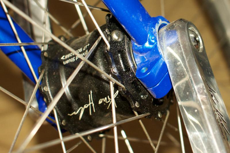

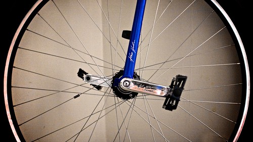

I learned the hard way that ISIS-cranks need crank stops as the left crank started to eat away the paint on the frame on the very last part of my ride home from work :stuck_out_tongue: When I had the cranks off I found I might as well switch from 125/150 to 137mm :sunglasses:
My latest ride.
It is not advised to use crank stops with the KH/Schlumpf hub (which it looks like you have).
Okay…now I am confused. The attached picture shows what my uni looked like after my last ride without crank stops. Mind you it was only on one side…the other was fine.
Edit : after some more searching I guess you are right…I will be removing them now, hoping my new cranks don´t do the same as my old ones…
Lunicycle has had material removed from his cranks to help with the same problem: http://unplannedismounts.com/2009/09/09/milled-moment-cranks/

Lucky for me I have never had issues with fitting KH Moment cranks onto my KH/Schlumpf hub, but I have always used brand new cranks, not ones that I have used on other hubs. Were these cranks off a non geared hub and had they been used before? Sometimes there can be slight deformity and due to the high tolerances of the hub, everything basically needs to be perfect. Other riders (lunicycle) have had issues like the issue you have pictured so he had to machine off some of the crank material to make them fit.
Out of curiousity, when did you get your hub? Is it an older KH/Schlumpf version, or a newer one with the 4mm longer axle (2mm more clearance on each side)?? I tried other cranks out, but only the Moments fit correctly on my hub, the other cranks I tried looked like your picture.
As far as I know these cranks (Moment 125/150) were brand new, mounted to the stock KH hub in the KH36 that I bought to use with the Schlumpf hub. The 137s that are on it now were also brand new.
The hub is the newer type (post M 0200) with the Schlumpf-designed bearings, so I guess it also has the longer axle. I got it in April this year.

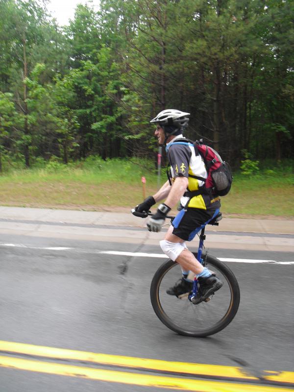

Here’s a photo from yesterday’s Black Fly Challenge race, taken by Rob Jacob, a fellow racer. This was the at the start, where a couple paved miles led to the race’s dirt roads. I was getting a lot of skeptical looks at this point.
