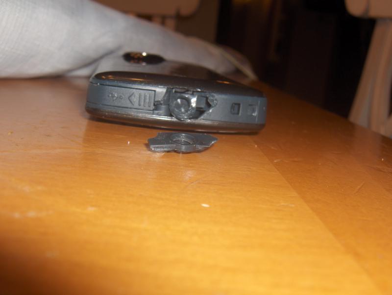

Hey, so a few weeks ago I broken the bottom part of my camera off that allows it to connect to the tripod screw. Just to repeat, it’s the camera connector that’s broken, not the tripod connector. Yes, part of my tripod is broken but tape easily fixes that but it doesn’t help my camera. I have to put tape on over and over again on my camera to keep the broken part on so I was wondering: Has anybody else had this problem and what should be done to fix this? Pictures are at the bottom here to explain what happened to my camera.

I can’t see quite well enough, but is that the part with the threads lying on the table? If it is (and I think it is), then go to Lowe’s and buy a small, 2 part epoxy kit for about $2. Looks like the empty spaces behind the broken piece contain no electronic parts, which is good. Mix up the epoxy and gob it into the void. Thread a screw into the broken piece and stick it in hole and hold for a minute - presto - camera fixed. Epoxy is much better (stronger) than Super Glue. Try to keep the epoxy away from the screw because it will forever be fused to the camera.

Cyanoacrylates like SuperGlue have a shear strength of about 2000 psi and good, 24-hour cure epoxies (Armstrong A-12 for example) have shear strengths of about 6000 psi under ideal conditions. Epoxies are strong on their own but cyanoacrylates only have the capability to bond, they can’t be used as fillers. Thousands of psi of shear strength sounds like a lot but let’s look at your camera.
The area you can bond with a cyanoacrylate looks like it might be about 1/8 inch square or 1/64 of a square inch. Say it’s about 1/50. Then your 2000 psi cyanoacrylate will yield with about 40 pounds of shear. Still sound like a lot? Let’s say you mount it on your tripod and apply a force at the top of the camera 4 inches from the glue joint. The lever arm from the glue joint to the center of the tripod stud is about 1/4 inch. You have a mechanical advantage of 16 and all of a sudden a 2.5 pound bump on the top of the camera pops that glue joint open.
The epoxy will be somewhat better because the fill has integral strength. It’s harder to handle but if you can get some of the epoxy to undercut the break zone of the camera it is no longer just bonding. It’s now forming a piece that grabs the bottom surface of the break zone like mortar and it bonds the break surface as well.
The best solution, and the ugliest, was already mentioned by AlisterBurt. Epoxy a 1/4-20 (standard thread for a tripod) nut onto the bottom of the camera…or anywhere you want to on the camera. A flanged nut would be even better because it has a large surface area.
