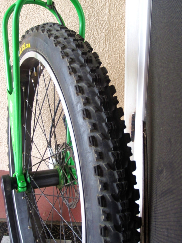

Oregon "Lite"

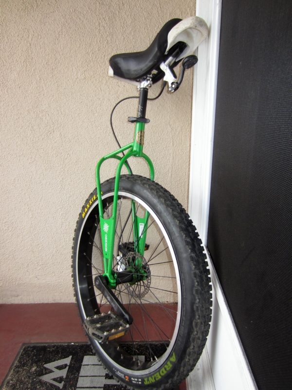

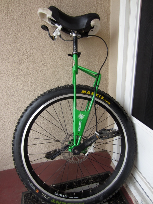

The super fat 3.8 Larry tire is great for snow and sand; not so good for MUni because of its propensity to “self-steer”. So I had an Ardent 26x 2.6 that I wasn’t using, and now I have a 26er for extreme MUni!
Although this tire is 1.2" narrower it’s still plenty wide and stout to take on tech terrain and do sizable drops. And the difference in handling is dramatic! And it’s way easier to maneuver than the Larry and feels as solid and stable as my 24 with LM rim and 3" wide tire, and it’s faster too!
That’s a great looking uni, how big does that ardent measure out to be on the LM??
Almost exactly 2.6".
I tried that last year, works okay, it’s about the narrowest tire that’ll run safely on the LM rim, but it’s not all that great for muni due to being stretched tight between the sidewalls, so it’s very flat and not particularly “supple”. It’s so strtched that the sideall are vertical and don’t really protect the rim.
I liked the Duro 3" on the LM better, but then it’s twice as heavy.
As Terry commented in the Knard thread, it be cool if we had a 26 x 3" Kard like tire :slight_smile:
I’m hoping Surly and others see the “shoulder season” and dry weather opportunities for fat wheels to run mid fat tires, it could really expand our 3" tire choices, esp in the lightweight tire genre.
In the meantime you can get a 29" wheel for an Oregon and run a 3" Knard :smiley:

I see how well it flattens the tire, but it looks like you loose some of the cushon for a flatter profile
I’m on the fence about wide rims (KH - Surly) - in some ways I prefer Nimbus rims even though you can’t get them drilled.
Took her out for a proper MUni test, and it performed like a champ with the Ardent 2.6. No self-steering issues like I had with the Larry and there is plenty of volume for drops and negotiating technical terrain.

How much does the Ardent weight in 26 x 2.6 ?
Do you know the ETRTO for this tire ?
I don’t find it on the Maxxis site there is only the 2.4 in 26 and 29 :frowning:
I had some good success on a LM rim with a Specialized Purgatory UST 26x2.40 (only 790g) and I have a Continental Diesel 26x2.5 on the way that should be the same weight…
