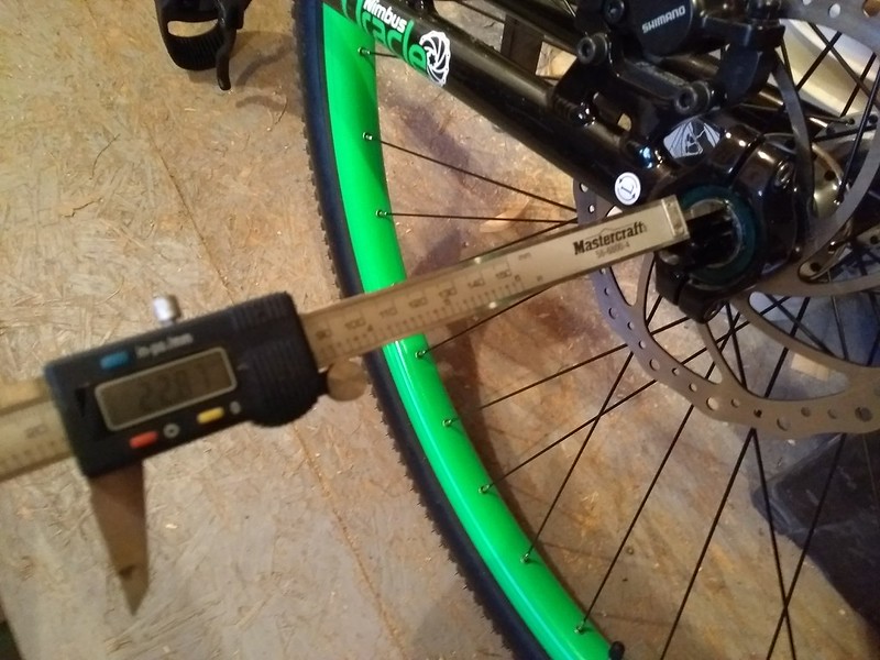

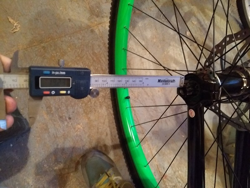

I torked my crank bolts like hell and went riding again, my right foot is definately rocking back and forth a tiny bit. I disassembled the crank at home and im not too happy about the results. Disc side : Crank held in place against the spacer = no rocking. Right side : Crank held in place against the spacer, its rocking a lot, seems like it needs to go further in about 2.5mm according to my digital caliper.
The bad news is ; Measuring from the axle end to the bearing inned race on the disc side i get 22.8MM , Measuring from the axle end to the bearing inned race on the right side i get 19.23MM.
Is that normal to have the hub sides sticking out 3.5MM further on one side ?
Both my spacers are 7MM, putting the right crank on without a spacer to the point it stops rocking, i would need a spacer about 4.5MM, The Disc side seems ok

Sounds like you may have found your problem. When using aluminum cranks the ISIS standard says that there should be about 3 to 6mm of space between the crank and spacer washer when the crank is pushed on by hand. If the space is smaller, then you need a thinner spacer washer.
I just measured the axle I took off my new Nimbus Stealth. First, as it came new there were different thicknesses of spacer washers, 2mm on the right and 2.5mm on the left. I also measured the distance from the end of the axle to the bearing as you did. On the right is was 20.68mm and on the left it was 19.89mm. I also noted that the thicker washer was installed on the left side, that is the opposite as one would think. So I think rather then the distance from the end of the axle to the bearing as an indication of how thick the spacer washer should be it would be best to go to the standard recommendation above.
