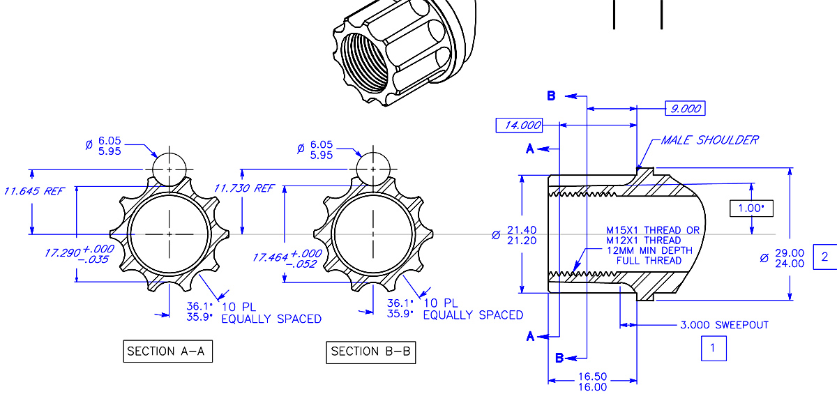

Pierluc,
It would be interesting to see if your axle is under sized. Here is a drawing from the standard:

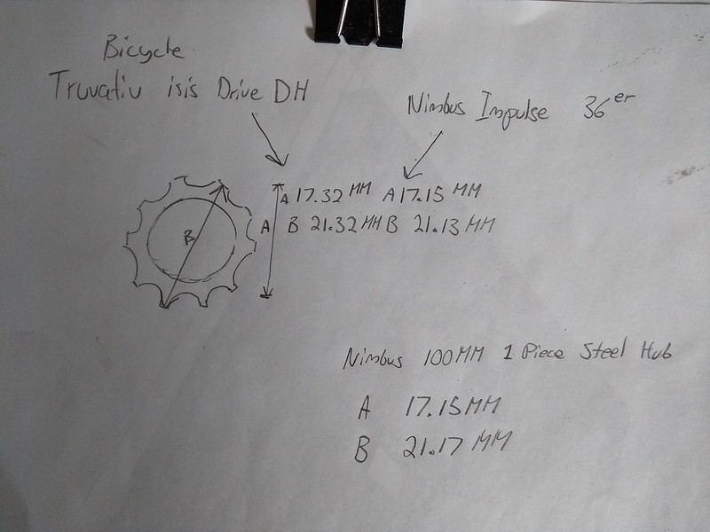

A bit undersized compare to my bicycle hub, but quite similar to my other nimbus hub that is working fine with 7mm spacers and same crank :sunglasses: Ill put locktite on that isis screw and stop worrying about it.
Isis bolts are still loosening after a long ride , never need a crank puller to get the cranks out :roll_eyes: I dont think i can shave my spacers more than that because my isis bolt dont have much to push on the crank arms already. Didnt loctite yet.
Even trying cranks on without spacers on either size, crank snug by hand can only get .5 to 1mm maximum of press fit from the bolt ( same result with 3 pairs of venture 2 cranks that i have ) Waiting for answers from municycle.ca
Pierluc,
Did you measure your axle at section B-B of the above drawing. This measurement would tell you if the taper is correct on your axle. The measurement should be 17.412 to 17.464mm at a point 9mm out from the male shoulder.
Your measurements are within the spec if they were taken about 2mm from the end of the axle but that is only half the story.
After using loctite on the isis bolt and tightening it really hard, it seems to hold better but still loosen after a while. Municycle is sending me a pair of VCX crank and different size of washers to try. Aparently those cranks hold more tight on the axle. Cant wait to be riding without hassle :slight_smile: Its a great ride other than that!
