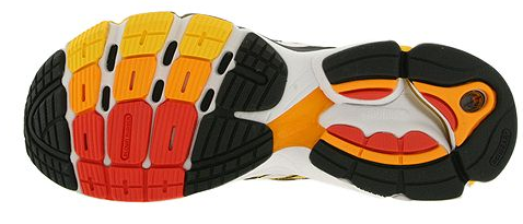

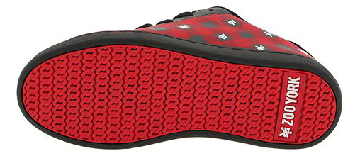

Skate shoes will grip the pedals much better than running shoes.
How come? And do skate shoe’s soles wear out very fast? I don’t wear skate shoes but my running shoes are pretty battered from the pins in my pedals and especially the right one from gliding :stuck_out_tongue:
Running shoe:
Skate shoe:
Skate shoes are made so there is quite a bit of sole touching whatever your standing on. You can move your foot to many different positions and angles all while keeping contact with pedal or deck or such. The whole shoe is usually pretty soft allowing you to move your foot in many unnatural directions when needed. The grip is covering the entire sole making for less slippage.
Running shoes are designed so contact is concentrated to the ball and heal of your foot. This makes for less frictions and a smoother more powerful step. They are also stiffer and designed to flex in the way your foot should flex while running. There are dead spots on the sole which will not grip a pedal well.
As for wear: Shoes are gonna wear out no matter what kind they are when you use metal pedals. I find that my shoes are pretty evenly used when the sole is toast. Meaning the cushion, the the stitches, and the sole all keep up with each other. I get knew shoes more for fresh flex and cushion then flex grip… tho all are needed in about 2-3 months of moderate to heavy ridding.
