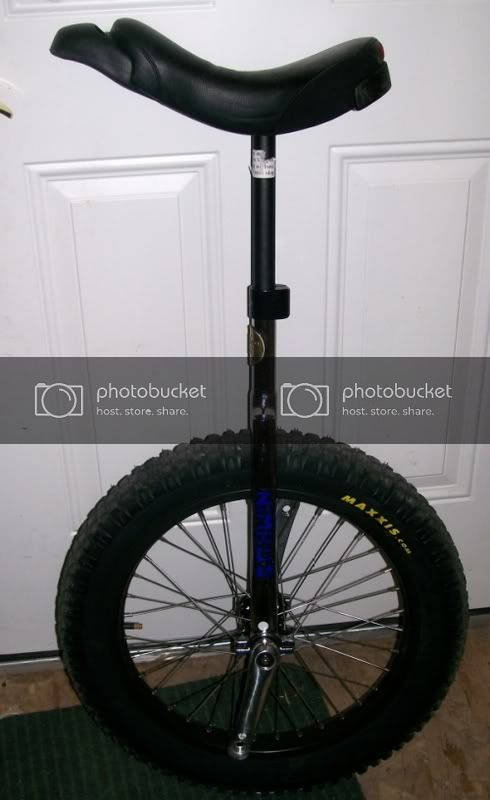

Nimbus ISIS (upgraded) Review
I’ll bet It’s light! I love your seat/seatpost.

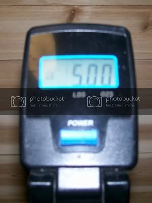

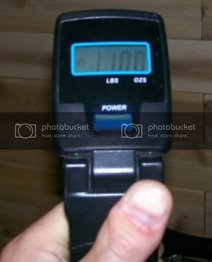

Okay, I’ve verified everything.

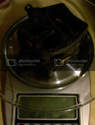

Calibration with a 5lb bag of sugar.
Weight of Nimbus Trials ISIS without pedals. (11 lbs).
Weight of Plastic LX pedals (it says 12.75 oz) so closer to 11 lbs 13 oz (or 11.8 lbs, 5.35 kg) for the uni with plastic pedals.
Awesome uni so far!

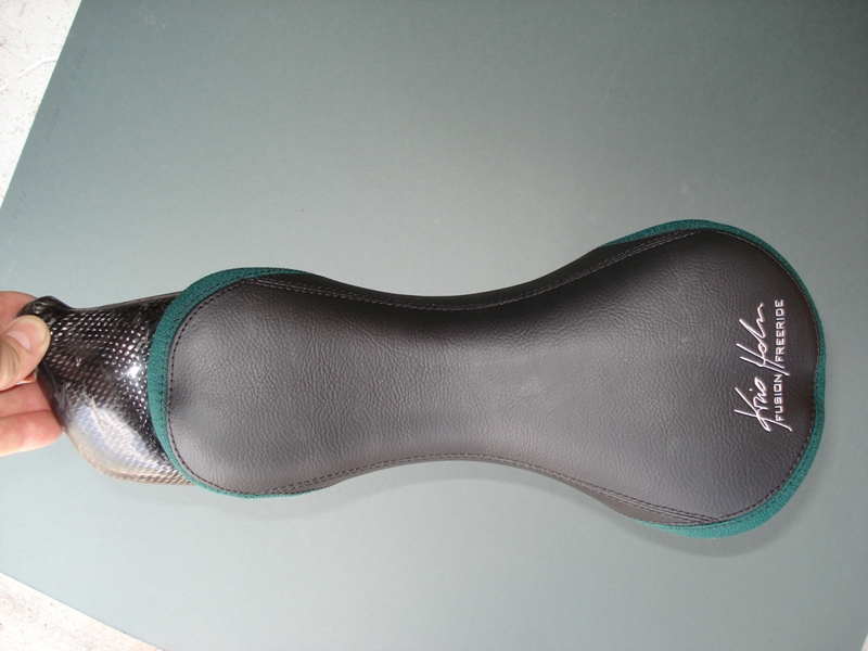

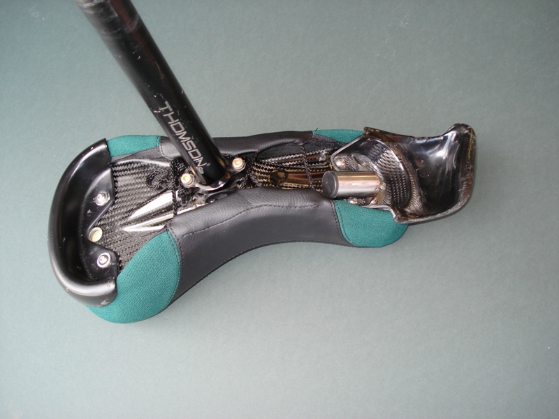

Hey Brian, can you please post some pics of the seat without the cover, I want to see how the kh foam fits. That would be cool.
i’m getting the Nimbus ISIS Trials with Moments ordered tomorrow!! It’s gonna be torture waiting a week for it.
Ask for a steel seatpost instead of the aluminum which comes on it. Go for cromo steel if they have it in stock. It comes with the aluminum post to conserve weight but that post is so weak, you want steel for sure.

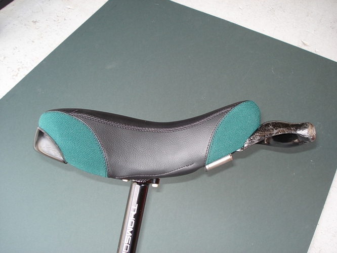

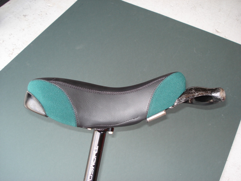

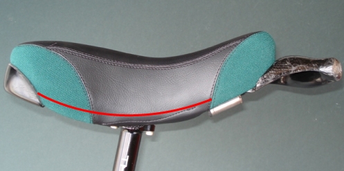

Luke, the KH foam does fit but not perfectly, Its a bit too short in the back and the base is wider so you need to tighten down the cover to hold everything together. I ended up just chopping the top of an 04 fusion foam off and putting that on top of the base, though I’m probably going to go back and try and fit a street fusion foam back on.
Heres some photos Scott sent me of the fushion freeride cover and foam fitting on the base:
Here we go, I drew a line about where the side of a KH foam ends on the derail base - it doesn’t reach the bottom. It ends at the bottom of that red line not the top. Good luck getting a SW base too, I’m pretty sure he said I got the last one for a long while.
