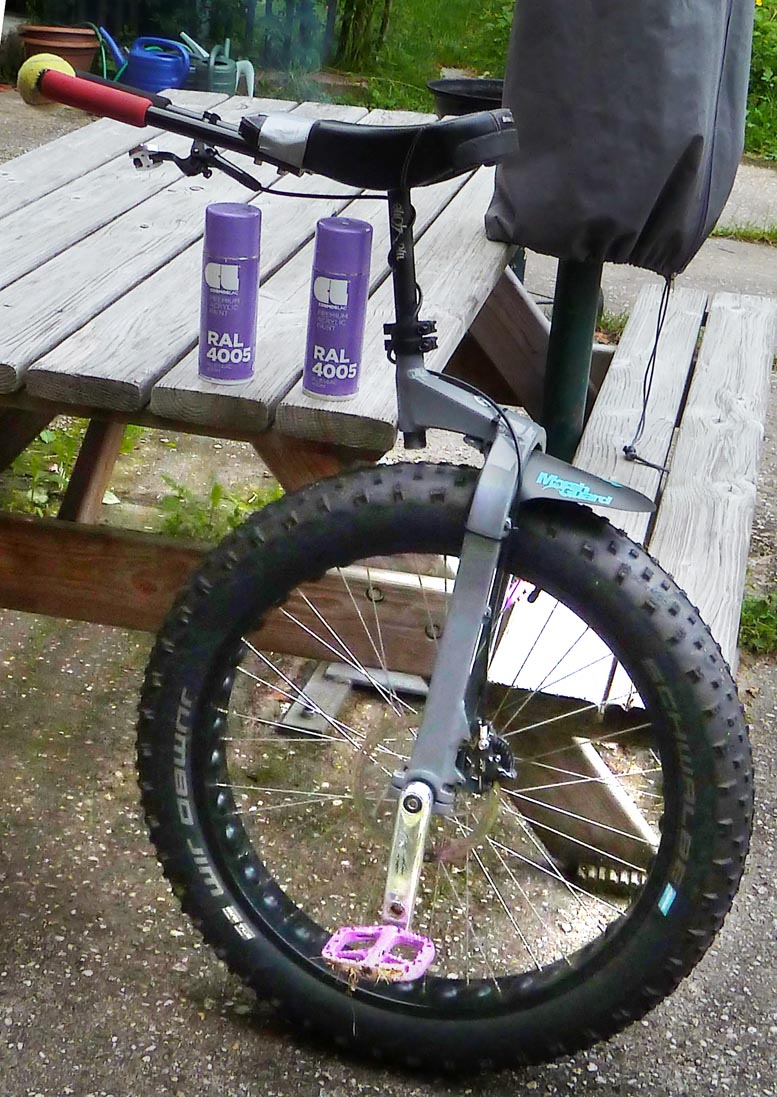

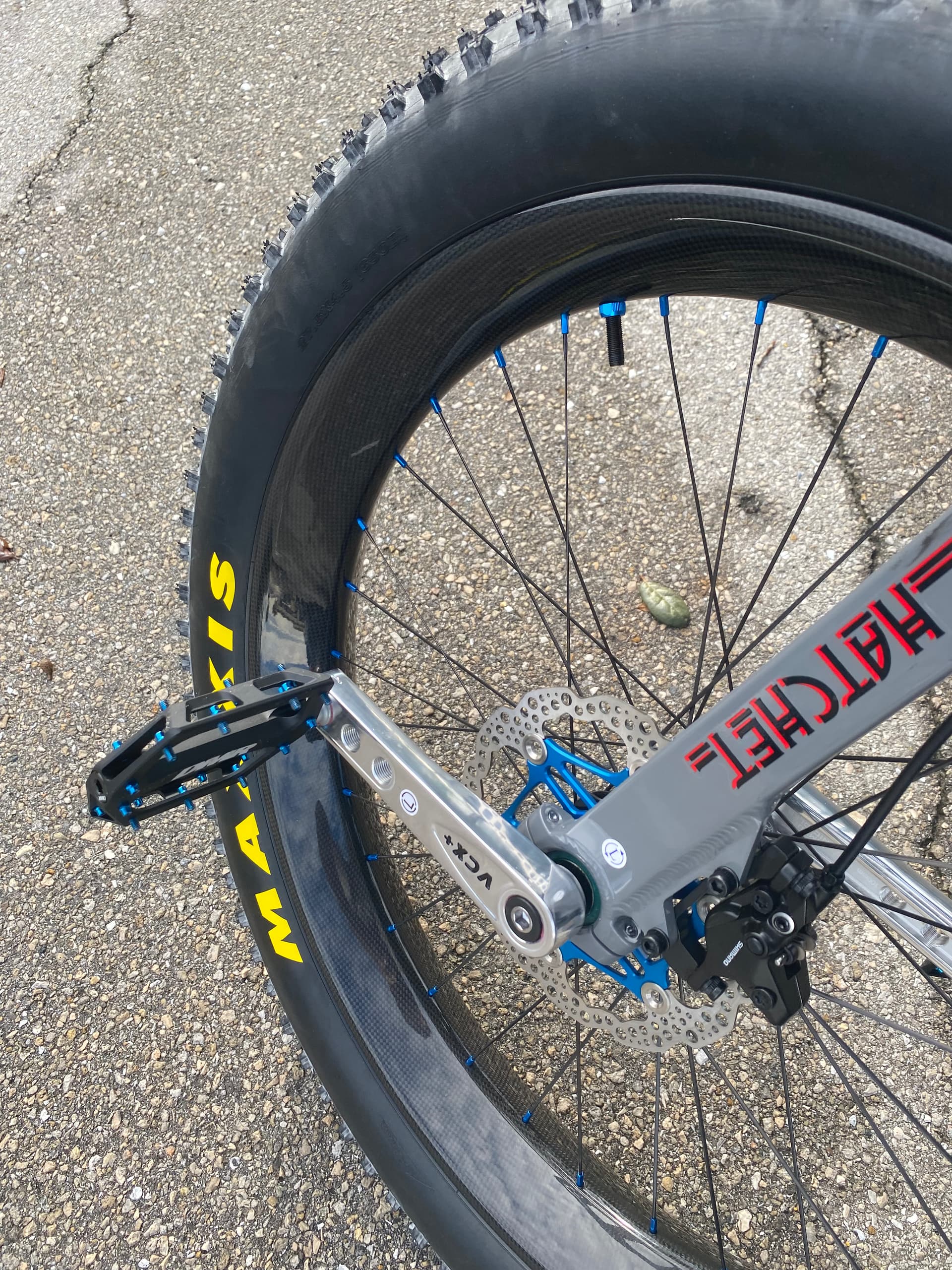

There are too many boring grey hatchets around. I think they are so much fun, that they deserve a more friendlier colour. What do you think about RAL 4005?
Looks like it would clash terribly with those pedals… Neutral (black/white/silver) frame, colorful rim, pedals, seat (when that was possible) and seatclamp has always been the winning look in my eyes.

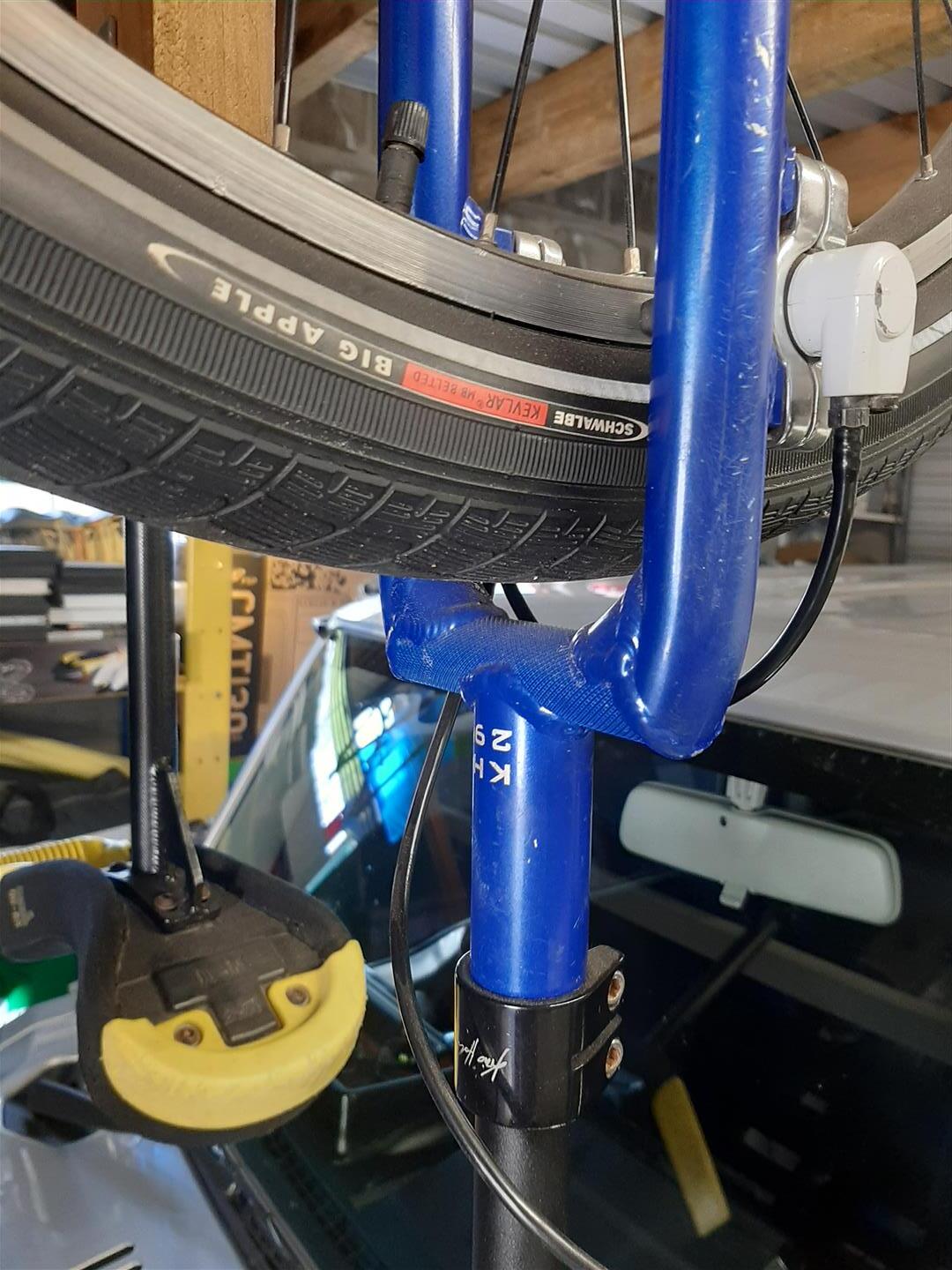

I have one on my KH 29er and it rides beautifully, I’ve never had any camber issues with it, though in fairness I don’t ride it anywhere near as much as my 36er

I`m sure, the colors will clash and I will see if I like it or not. It is easy to swap the pedals onto another unicycle.
