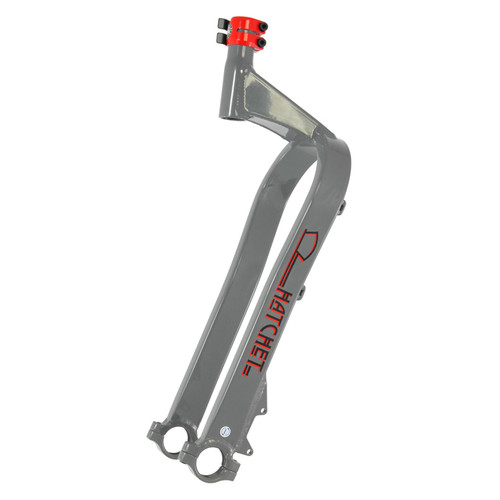

The Nimbus Hatchet builds on the amazing platform that the Oregon created, and moves it onto the next level. The frame comes with the brake installed on a new precision IS mount. The hose is also clipped in place with special red aluminium clips. The main challenge with “Fat-Uni’s” is the requirement for a super wide frame. This can make it uncomfortable to ride as it catches the riders’ legs. To resolve this the Nimbus Hatchet moves the frame behind the riders legs giving maximum clearance. This also means you can run some of the largest tires on the market, which includes the Snowshoe 5.05" tire.
This frame will hold a tire up to 26" x 5.05", 27.5" x 4", 29" x 3.0" and a 32" x 2.125"

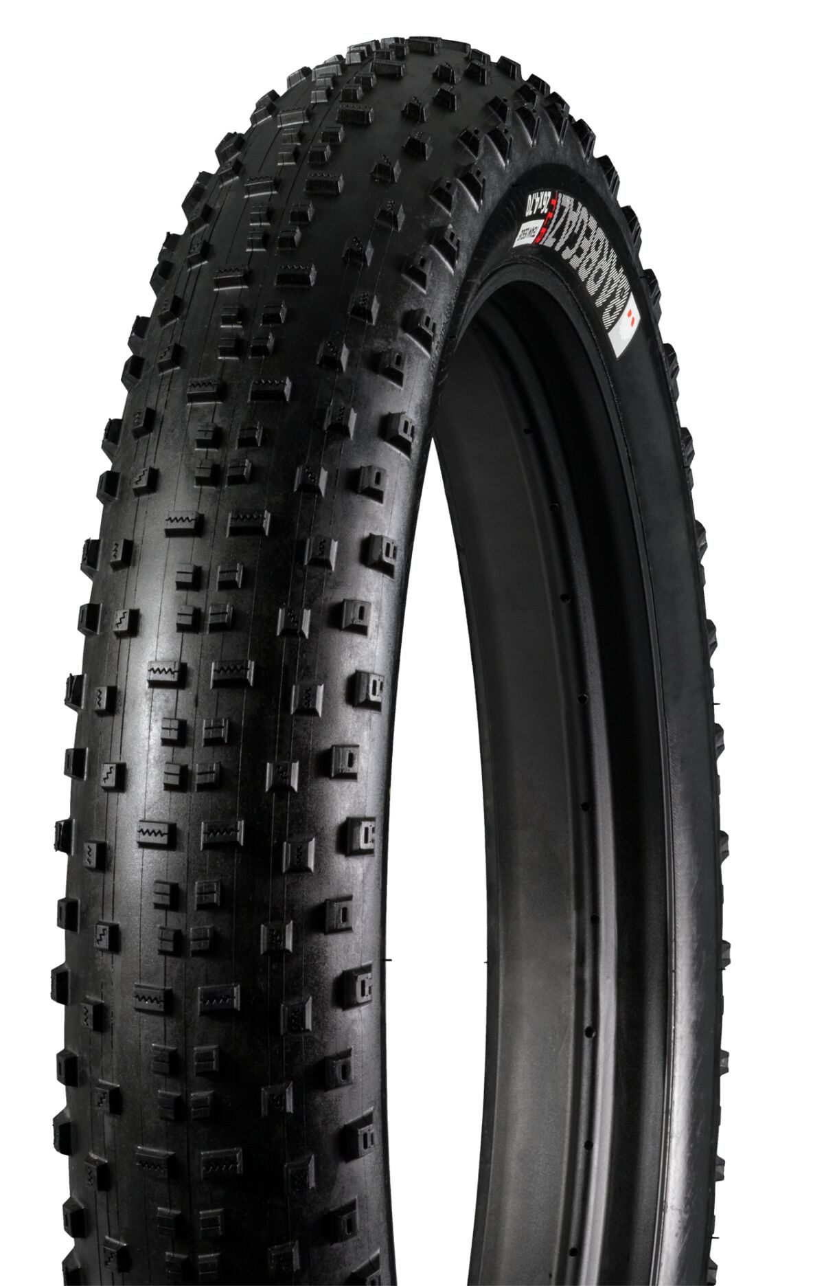

My observation is that real world tire diameter and fitment varies by manufacturer and setup. Ideally I’d love to run one of the new 27.5x4.5 barbagazi/gnarwall tires from bontrager but I fear that they exceed the suggested tire specs by to significant of a margin.

I don’t know the tire myself, but concerning the 27.5x4.5 barbagazi/gnarwall tires, you just need to ty and find the width and true height measurements on a given rim width (I found similar stuff for lots of tires on the fat mountain bike forums). Also the bead-to-bead meaurement can help with estimates too if you don’t find the exact combo tire/rim you want to try.
My gut feeling says that the 4.5 width should fit and your only real limitation should be the frame height. For example the Surly Lou 26x4.8 has a total height/diameter of 778mm and bead-to-bead of 260mm and fits for sure. Sorry no links, but I am pretty sure the Lou 4.8 fits as it was on my list for my possible setup for the Hatchet. Oh, if I remember right, I think the Bud 4.8 is a touch bigger and is fitting in the Oregon (from post here).
So check if you can find the bead-to-bead, effective diameter/height and width numbers and see what the widest rim that will fit.

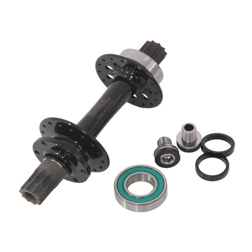

32 hole Nimbus hub
Don’t know anything about 27.5 rims.
But another option should be a 32 hole rim, as UDC has a few 32 hole hubs. About 2 months ago they were available in the US and after my inquiring UDC-Germany (Roland) had 2 or 3 shipped to Germany. Not sure where you’re located, but I think in USA or Europe there should still be some available.
At least that should allow you to simply search for the best rim and then choose the hub accordingly.

Bontrager 27.5x4.5 Barbegazi Tire:

I will need to measure the clearance on my 26x 4.0 tyre to the crown of the frame for you (probably tomorrow morning).
The larger diameter 27.5 rim, plus another 1/2 inch on the tyre is going to make it a very tight fit for height clearance on the frame.
Reverse engineering the other tyre sizes suggests that 4-inch might be the maximum 27.5 tyre size.
Someone with a 5.05 inch VeeTyre Snowshow 2XL will be able to make a better guess on whether you will have the extra 0.4-inch clearance required.

27.5x4.5 is actually in the vicinity of 31" diameter. It is slightly larger than a 26x4.8 Surly Bud as the Bud just clears a Bluto fork, but the 27.5 Barbegazi rubs.
The whole 27.5 fat is pretty much a marketing gimmick as it is only slightly larger (.75" or so diameter/ .375" radius) than a 26" fat tire. It is nowhere near as big as the 1.5" size difference suggests. In fact the 27.5x4.0 Hodag is so undersized it is smaller in diameter than some 26x4.0 tires.
Personally I’d go with 26" fat as it will allow you to run a lot more different tires and you aren’t stuck with a few options (three Bontrager and one Maxxis) that may or may not work well for uni. Unicycle handling is way too tire dependent especially with fat tires to limit yourself to a few choices.
Ooops, I forgot to subtract the standard 2.0-inch tyre size.
So a 27.5 wheel (outside diameter with a 2.0 tyre) will have a rim ISO size of 548 for the rim and tyre bead diameter, according to the UDC (UK) website:
27.5 inch = 548mm, which is 21.9 inch, plus 4.5 tyre (x2) = 31 inch overall diameter.

[on a 65mm Nextie rim] diameter at 20psi is more or less 770mm and the width of the casing is 115mm, with a few extra mm of knob.
770mm = 30.3" so you should be OK in the Hatchet frame.

The hatchet frame has 40mm clearance between the Kenda Juggernaught 26x 4.0 tyre (98-559), to the top of the frame.
35mm of that extra height should be usable.
Across the top of the tyre, there is 135mm width (=5.4-inches so plenty of frame width), increasing to to the widest point a little lower down, appx 6-inches wide at 150mm.
So from what I’ve gathered, 27.5x4.5 Barbegazi fitment on the hatchet frame shouldn’t be an issue.
