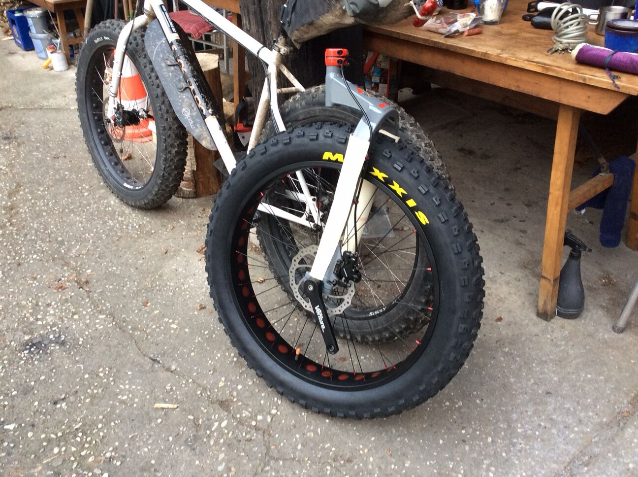

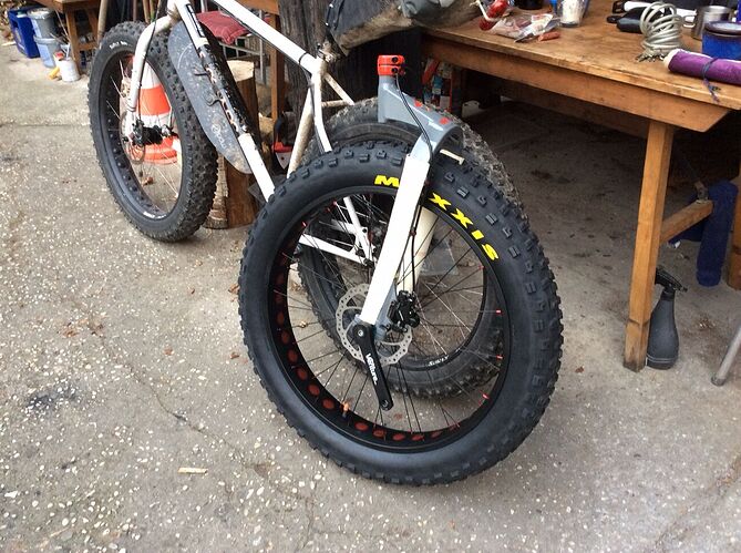

It was shortly before the old forum shut down for a while and I thought you didn`t noticed it. Here is a photo of my hatchet the day it arrived not yet completely assembled. I hope you can see the non offset spokes.
