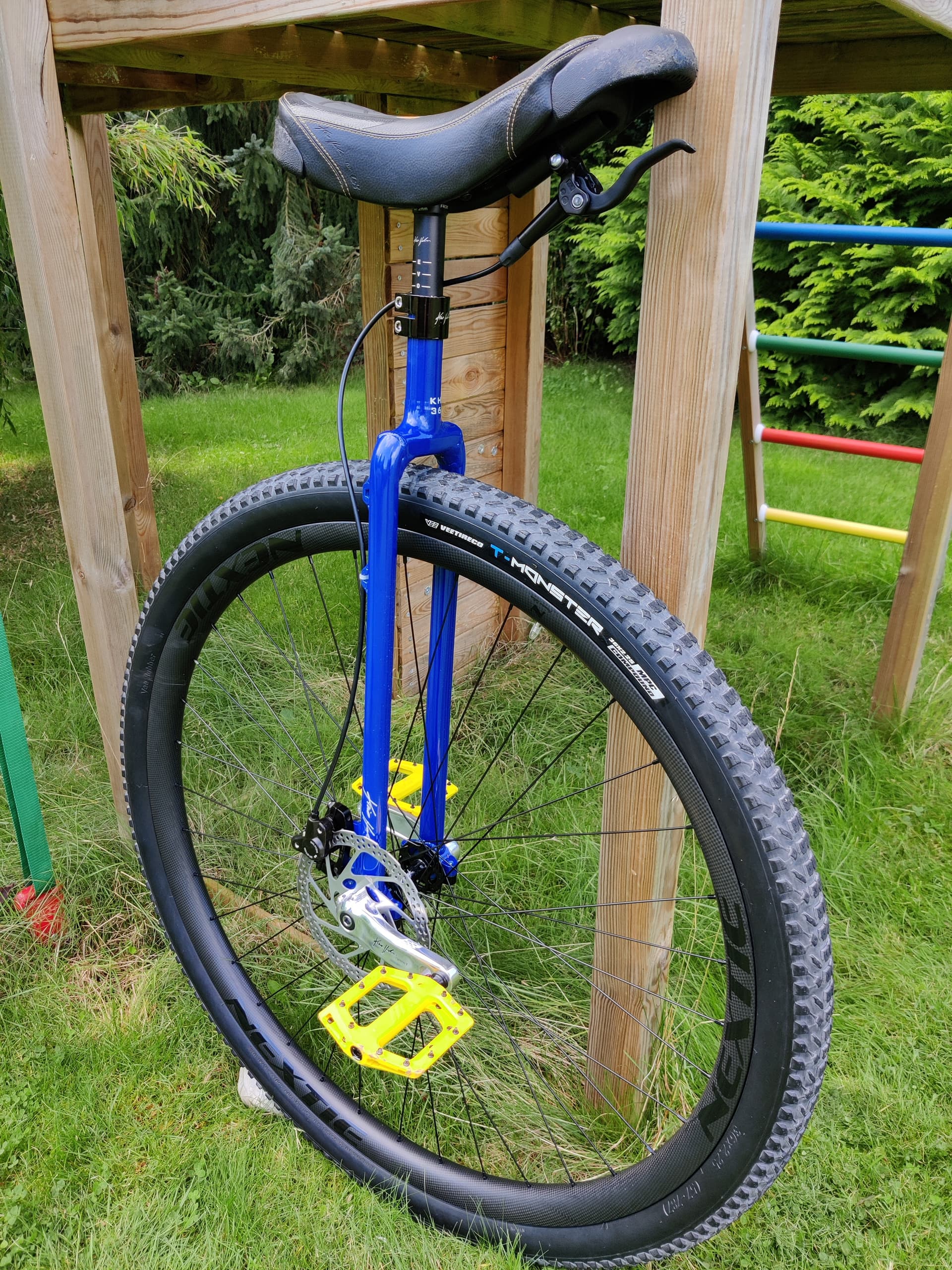

Nextie 36" carbon rim
Dang that thing looks sexy! Can’t wait to have mine too!

Weight as pictured 6,3kg
It’s my first 36" so I cannot do any meaningful comparisons of how it rides but I really like it! Fast, very smooth and quite maneuverable.
I (obviously) started out using a wall to get the feel for it but after a few short rides + planned dismounts I tried (static) free-mounting and succeeded in the third attempt :grinning:
I was expecting it to be something that would require a lot of work to learn but fortunately it seems quite natural and not that difficult. Of course my success rate is nowhere as good as on my 27.5 but it’s good enough that I can just ride off without the need to think about if i can re-mount after an UPD.
It’s not the final configuration as I (as expected) was missing a proper handle after a few mins. My 27.5 has a Handle Saddle that I really like. For the KH36 I will add reinforcement plate to the QX Eleven saddle + a M4O Ursli bar and see how it feels.

Wow, nice, but 13.9 pounds seems impossibly light for a 36er, even with a carbon rim. Is that a carbon saddle base? The weight of the Vee Track monster tire is 3.1 pounds according to their website. Btw, what psi are you running? This rim is hookless but I checked with Nextie and they said you can run up to 60psi. This is with a tube since no current 36er tire is TR.
I admin the claimed weight of 6,3kg is using some cheap scale found on aliexpress but it seems like a reasonable weight for this setup. Also note it’s without any handlebar.
Here I’ve assembled the list of components and their claimed weights by their manufacturers.
The nipples/spokes I’ve weighted myself (I’ve got four left after the build) and the shortened seat post is a guesstimate. Uncut 350mm it’s 220g.
Qu-Ax brake lever mount is also a guesstimate.
KH website states the Spirit Hub is below 580g. Unicycle.co.uk claims it’s only 495g.
Item claimed weight in g
KH36 Frame 828
KH seatpost 190mm 150
KH Seatpost clamp 68
QX Eleven saddle 820
Qu-Ax brake lever mount 50
KH Spirit Hub 580
36x Spokes 367mm+nipples 360
Nextie carbon rim 620
Schwalbe SV19 tube 220
Vee Tire Monster 1400
KH Spirit Crank 110/125 378
DMR V12 pedals 430
Shimano MT400 hydraulic brake 300
180mm disc brake rotor 120
TOTAL 6324
I put ~50psi in the tire and left it overnight. Then I reduced it to ~35psi for my first test drive as I’m used to ~30psi on my 27.5 as I wanted to initially have a similar/comparable feel. I will obviously experiment a bit with pressure going forward.
