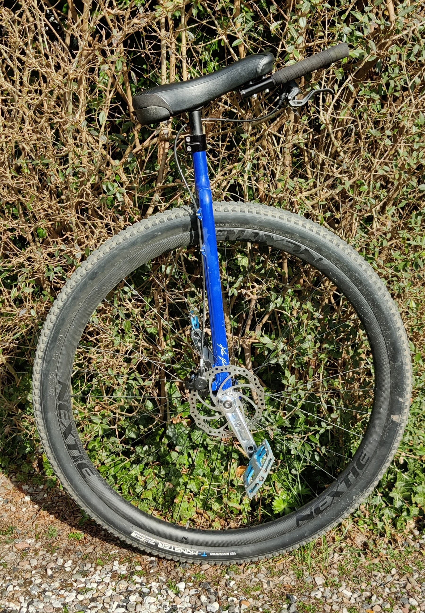

Out testing the hooked Nextie on the road & gravel with 35psi. So far it seems solid but it’s hard to shake the thought of a blowoff at 12mph or going downhill! 35psi still feels decent and rolling resistance is still low. It’s a bit more sensitive to road camber, but not that much. Overall it’s been a nice ride…so far. :+1:
Appreciate the update. Hope you will continue to post your riding experiences. Gives me some reassurance after purchasing two Nextie hooked rims. yesterday! Looking forward to hearing from others once the T-Monsters are available.

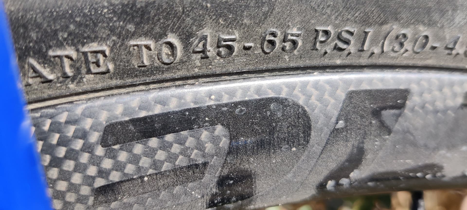

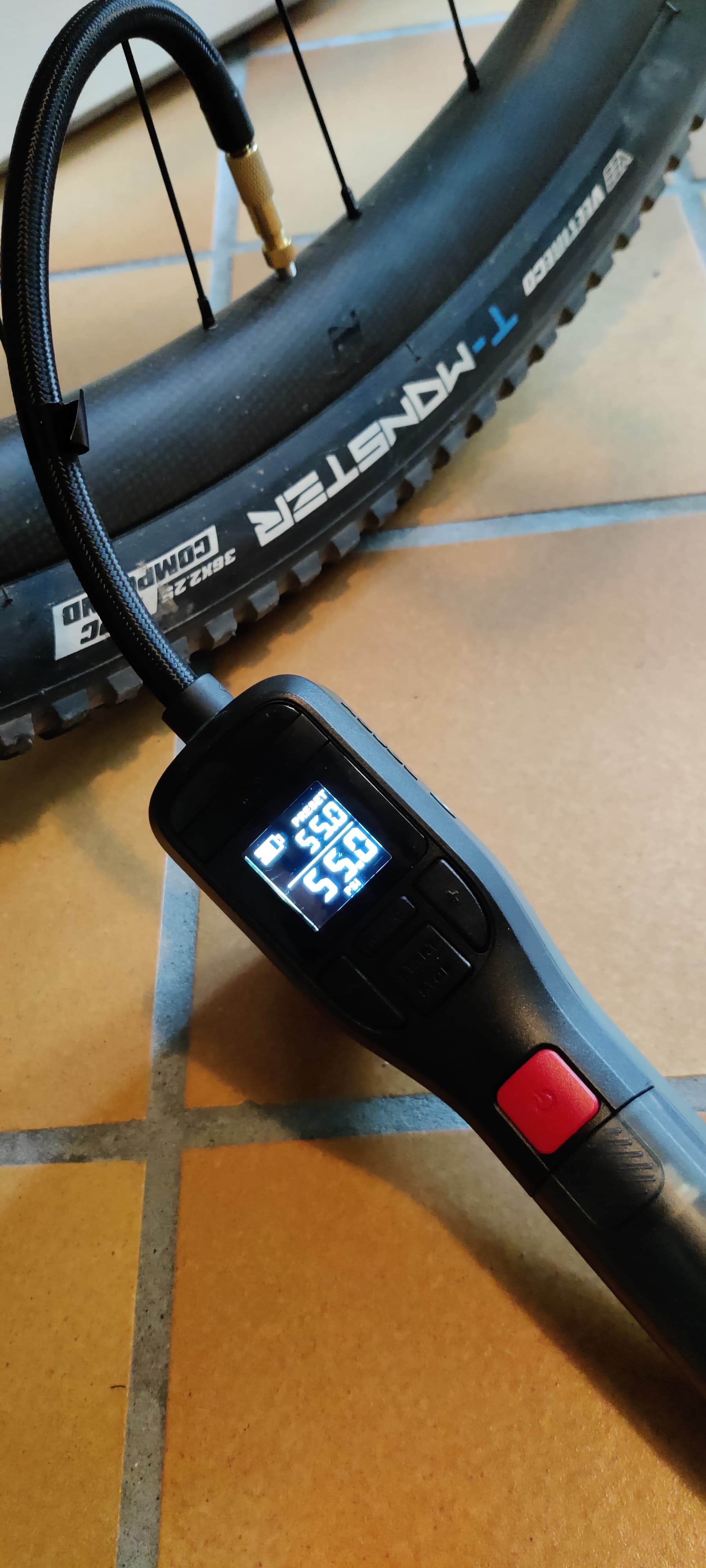

As I had a conversation with @mindbalance about higher pressure I tried increasing it to 55psi and went for a short 2,5km test ride. It obviously reduces rolling resistance and makes for a more nimble and twitchy ride. I will need to “adapt” to it for sure. Also the 117mm holes will likely feel more appropriate than the current 137mm holes in the crank.
Note this is the hookless Nextie rim (36h).
The Vee Tire T-Monster seems to still fit nice and evenly to the rim just as it does with lower pressure.
