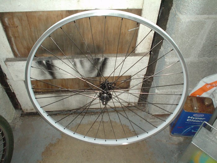

OK, Roger’s spoke supply arrived and I got my wheel yesterday.
Haven’t had time to put it on the unicycle yet, but here are a couple of pics of the wheel FWIW. It’s certainly noticably lighter than my old wheel. I’ll weigh them when I’m doing the swap and see what the actual difference is. I’m guessing about 400-500g (the spokes alone save 200 I think).
Rob
