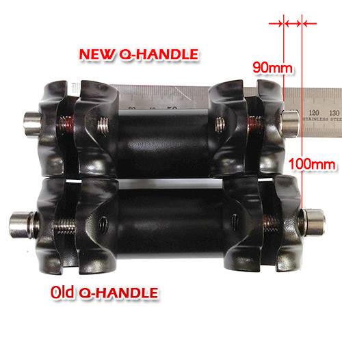

New Version
Qu-Ax just released a new Version of the handle and it follows the same concept as yours.
wow, what a coincidence!
The good news is that you can buy only the new (and longer) stem and the new t-part if you want to use your old q-ax handle loop, it’s compatible.
Edit: at least I hop you can, but the 2nd pic makes me wonder if you really can as the two tubes of the loop may be too far one from another to enter in the two clamps of the new T part.
Yeah it looks like the new t-bit is a bit too narrow to accept the old loop! I’d gladly give it a try though, I’ll have a look at the pricing!
EDIT: Can’t find it anywhere… Which site are you looking at to get the seperate parts? :smiley:

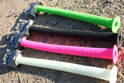

My brother pointed me towards another idea that I’ll be exploring - extra-long handlebar grips for cruiser bikes! They’re usually made of pretty hard rubber so should hopefully withstand a UPD, and even have a little thumb-stopper ridge on one end I can put at the front of the handle to take some further impacts.
I went for a pair of these bad-boys:
One on each side hopefully! Pictures soon :smiley:
I did something similar on my 36er. It works pretty well.
Make sure you have lots of hairspray or deodorant to get the grips to slide on, even with them its a bit of a pain.
I’ve tried this, but it leaves your hands all black after a ride.
