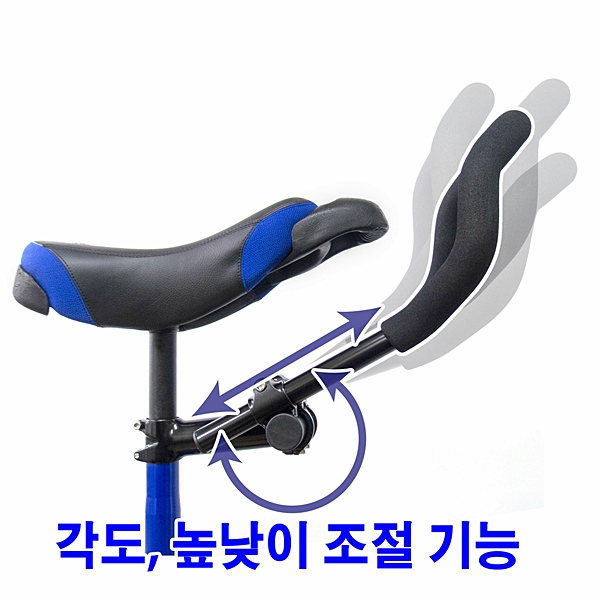

Qu-Ax just released their all new “Q-handle” handlebar.
See here at jugglingshop.co.kr

I guess if this looks complicated the KH t bar must be more so. This design offers the same adjustments with one fewer pivot point. I like the post mount on this, but I’m not sure about the stem acting as the seatpost clamp. I think it puts it all a bit too low, unless it’s on a 36er. It looks like it has a bunch of shims that would allow use on a variety of frame/seatpost sizes.

Maybe I’m just missing something but it seems to me that your basis of one fewer pivot point is wrong. The KH uses a pivoting mechanism where it mounts to adjust height and extends off of that pivot. So two pivot points. This quax sucker has one clamp to adjust the height and extends with two clamps off of that so once again two pivot points or even three depending on how you count it. You can add another pivot point in there for the quax that is going to be a huge pain in the neck, the seatpost clamp. No one wants to fight to get their seat AND their handlebar straight at the exact same time. With this weird clamp pivot where it shouldn’t be it looks like adjusting saddle height is almost a two person job. That totals 3 or 4 pivot points for the quax including the one that just plain shouldn’t be there.
So unless you are counting the bar ends as a pivot point they have the same amount. It doesn’t seem logical to me to call this design simpler on that basis alone.
This thing has two clamps that must be adjusted to extend the bar, not just one which seems like a bit of a waste of weight and effort.
I can see why you would want one of these for the one piece handle but the rest of the design looks like a clunky overcomplicated design with way too much that could go wrong. And on a unicycle handlebar everything that can go wrong does.

Maybe if you’re really short and have your 36er seatpost right down, you could put this bar BELOW your seatpost clamp (instead of replacing it), but if you did that without being short, it’d be far too low probably (Unless it extends a lot further than it looks. If I get one, i’m probably just going to shim it up and put it on my actual seatpost… though that could get ugly if it starts slipping down… :smiley:
