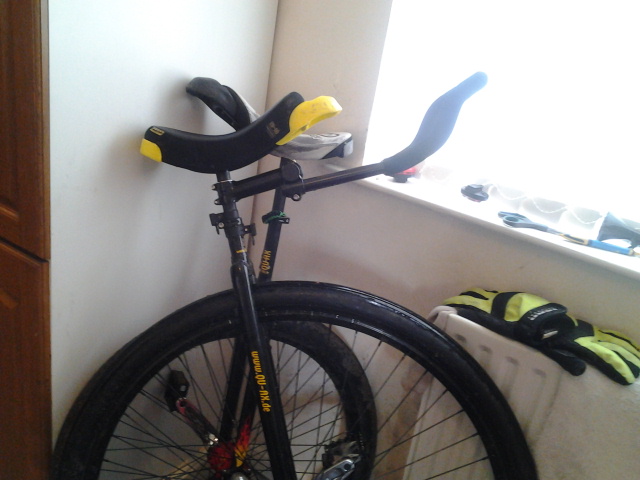

Got me a bubble-wrap envelope through the door today. Mum thought it was a pannier rack… Even when I started assembling it she kept asking me if it’s a bag-rack. No clue why!

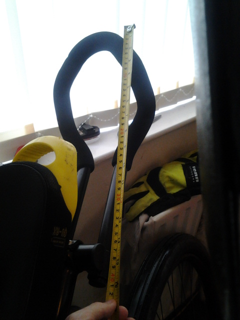

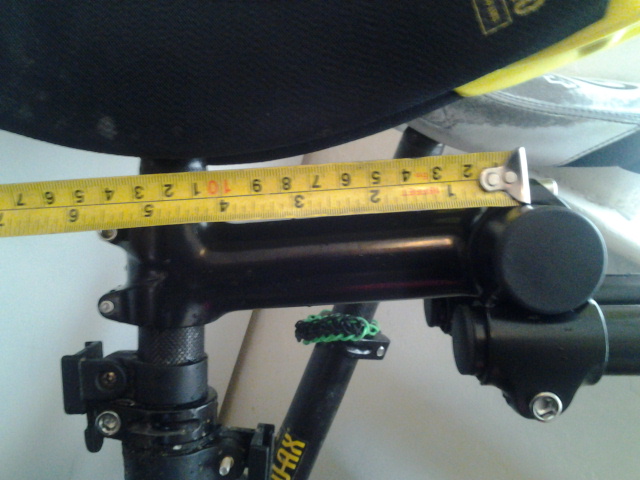

The bar’s a bit longer than I was expecting. The whole thing is about 52cm long (The stem that attaches to the seatpost is a 5" one, and the U-bar is about 40cm from the bar-ends to the apex of the loop). I haven’t tried messing about with the adjustability yet, I basically just set it to maximum length and ‘more or less straight’ from the seatpost, and well, I took a quick test-ride and it felt great, so I dunno if I’ll be adjusting it much anyway.
Annoyingly, the T-bar from the stem is slightly too wide, so my knees tapped it every now and then. Not sure if this is something I can learn to get over, or if I’m gonna have to take it down on the seatpost a bit (Or even do as they suggest and use it as a seatpost clamp).

The weird rubber foam noodle that goes round the bar was REALLY tight. My mum recommended I soak it in hot water to make it expand, which allowed me to (slowly) slip it on. It moves around a bit, but hopefully once it dries out it’ll cling on a bit better. Otherwise I might just tape it down using some leftover gorilla-tape from my failed tubeless experiment :wink:

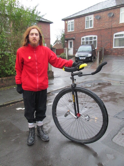

EDIT: Didn’t realise that picture would be rotated. It’s not rotated on my computer, so god knows what happened there. Turn your heads over! :smiley:
Alrighty I’ve had the bar a week now, and I’ve got an annoyance with it that I can’t seem to get rid of.
The T-shape the loop clamps to? It’s too wide. It rubs the inside of my legs no matter where I put it. Can’t cut it down, because the loop bar clamps are welded to it, not like I can slide them in a bit!
I did try mounting it low-down (As a seatpost clamp) But this resulted in the bar being, well, too low. I like the positioning of having it far out front, and on the same level as my saddle - this gives a good forward lean for powering down.
It’s not a major rub, I just sort of feel it. It doesn’t really bother me, but I’m sure eventually it’s gonna wear through my pants!

Not sure it will make much difference, but you realise you can reassemble it with the loop bar brackets above the t-bar stem rather than underneath?
And then maybe angle grind off the lower outside edges so your legs aren’t nudging a corner.

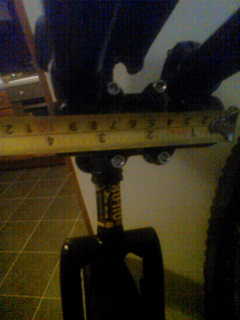

Also, any chance you could measure the width of the t-bar (cross bar)?, I’m thinking of getting one. cheers
The annoying thing is, the brackets are pretty much the same width as the T-bar bit. Shaving the ends off would probably gain you 2mm at most.
The T-bar is 4" across.
And yepp, I have it arranged so the T-bar is on the bottom now (as opposed to the pictures from earlier). It’s made the rubbing a bit less annoying (You’re rubbing a slightly rounded surface as opposed to an edge) but not gotten rid of it. I really want to try bringing it down a lot further, but I’ll have to mount it onto the seatpost clamp location to go any lower. Plus I like the hand position of it right now, so it’s sort of a toss-up between a nice hand position and annoying leg-rub (which only really happens if I wear baggy pants anyway).

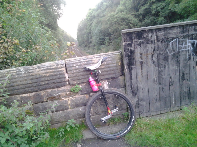

On my 29er i just attached a bottle cage to the frame, so it’s pointing upwards with my seatpost:
And on the 36er I attach it to the underside of the Q-Handle, as the seat tube/post is too short to fit a bottle in (At least, being able to get it back out again…)
Both setups end up with a bottle flying through the air upon a UPD. I busted my bottle by cranking up a hill and failing to crank hard enough - I fell forwards, my handlebar hit the floor, and my bottle fired out, smashing the lid up. They both allow me to drink while riding (With a bit of practice in the case of the 29er setup) so that’s not a problem though. Still getting a backpack though - I tend to take an extra 2 water bottles in the backpack to refill the frame one, so I still end up getting the bag off to sort all that out!
