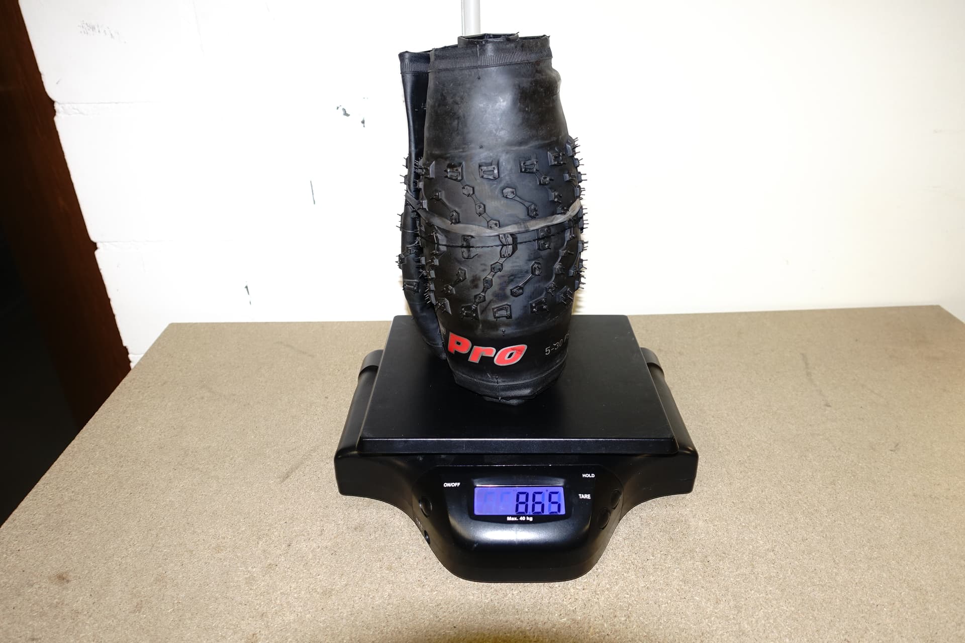

Today the Kenda Juggernaut Pro 26x 4.0 arrived. It is sensationally light at 865g. I will test it extensively next week during my holidays. I’m very curious how it drives
After being impressed by the good driving characteristics, this tire will be included in the range.
It is very easy to steer and insensitive to lateral slopes. And the weight is just WOW. You notice it especially when accelerating, braking and driving uphill.
The tire will be available in about a week at the introductory price of CHF 79.90 (instead of 89.90)

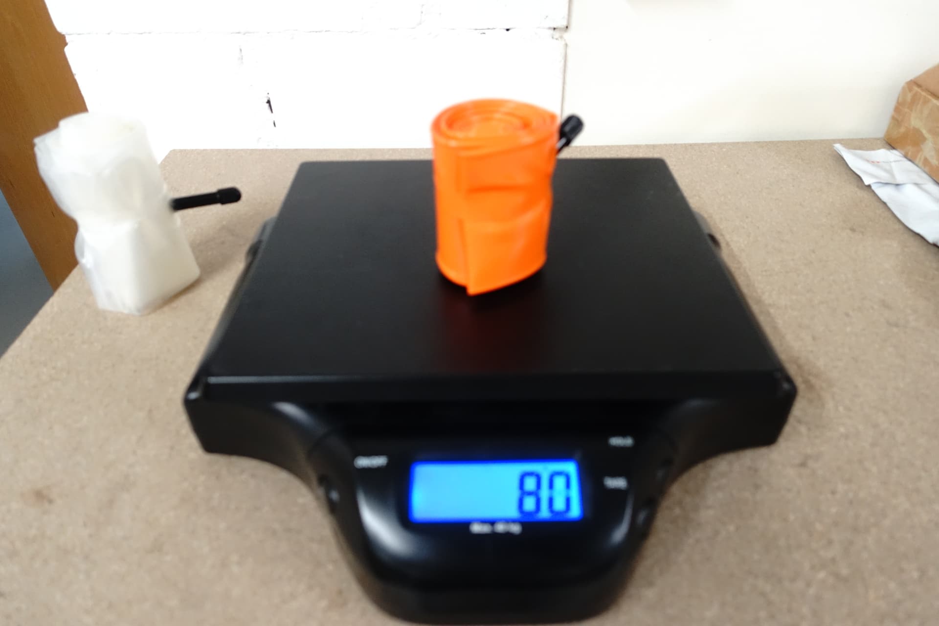

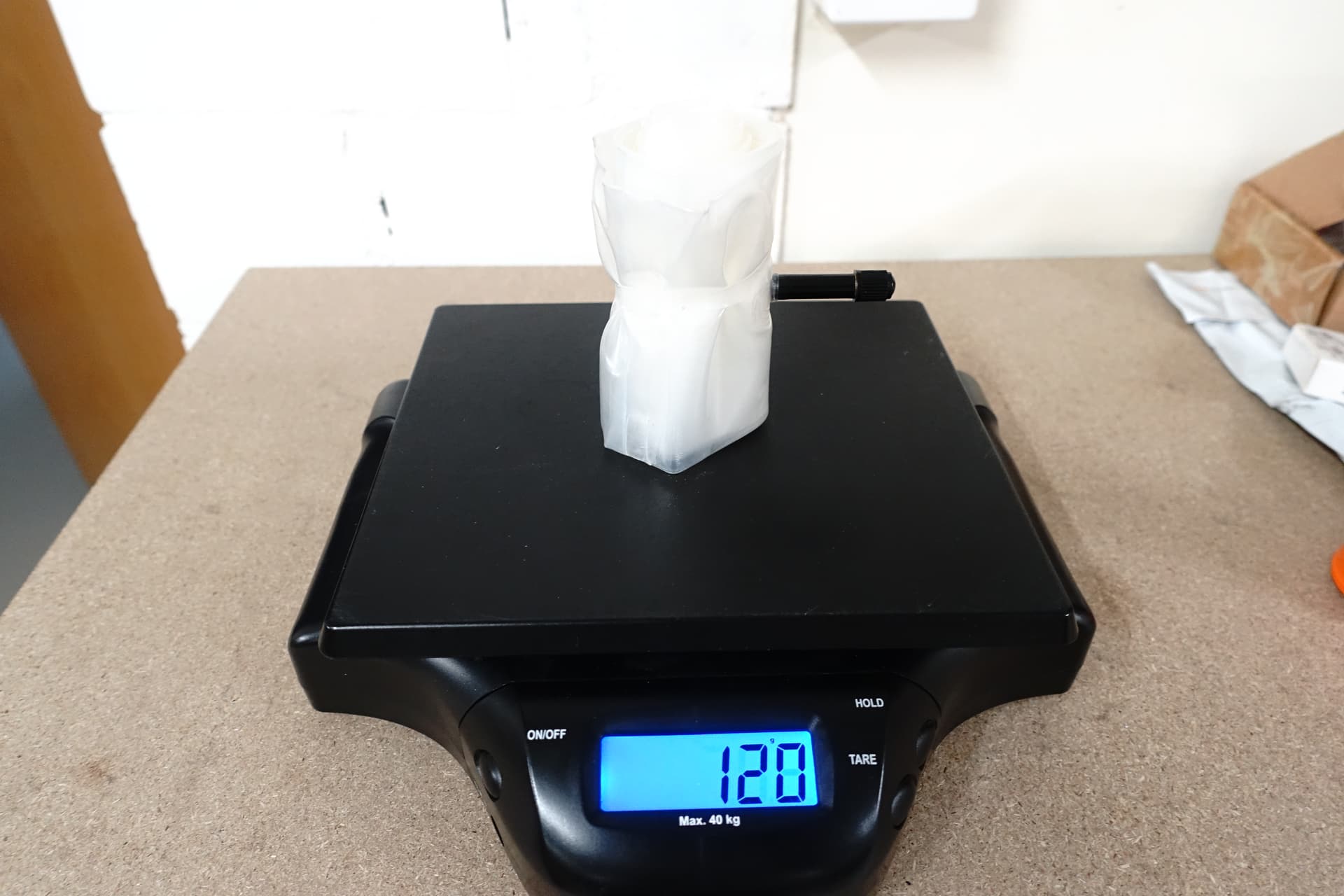

I have spared no expense or effort to have custom made samples of TPU Tubes.
TPU Tubes with AV valves are almost impossible to find. I had two tailor-made samples made: For 26x 3.0 tires (80g !) and 26x 4.0 tires (120g!) I’m curious how they ride and will test them 1 - 2 months before they go into series production. If there is a MUni driver from Switzerland who would like to test them intensively (with 26x 3.0 tires or 26x 4.0 tires), he can contact me, because I have 2 of each. The condition is that he actually drives it and gives me feedback. If everything is positive and the tubes have no defects, I will have them made in all sizes
I have now completed the tests. The TPU Tubes convince me. My two 26 inch unicycles (Fatty and 26x 3.0) have now completed a few kilometers on them and I will probably stick with these tubes forever.
I have now commissioned the production.
The following hoses will be available by the end of the year:
20x 2.4 - 3.0 AV
24x 2.4-3.0 AV
26x 2.4- 3.0 AV (80g)
27.5x 2.4-3.0 AV
29x 2.4 - 3.0 AV
26x 3.0- 4.0 AV (120g)
I deliberately chose AV valves because, in my opinion, they are more user-friendly and less vulnerable. It has happened to me more than once that I have snapped off the top part of an FV (SV) valve with a hand pump. Rims with a narrow valve hole can be easily drilled out (aluminium, but not carbon).

No, I have a 26x 4.0 Fatty tube, only 120g (!). I deliberately chose this size because it suits my range. My Fatty unicycles all have 4" tires. If you are looking for larger tubes, I can recommend the Revoloop. The fact is that the Revoloop, combined with my 4" tires, was always a bit complicated to install because it is almost too big . With my 26x 4.0 hoses it’s quick and easy. That’s why these hoses only go up to 4.0. It is so small that if necessary you could also use it for a 3.0 tire if you install it carefully. But I only tried it briefly. Would still have to do a long-term test.

I have now found one disadvantage compared to the many advantages: As with latex tubes, TPU tubes have to be pumped more often compared to butyl tubes. I didn’t notice this at first because I was testing different tires and none of them had been installed for a week.
Well, I’m going to have these tubes made anyway, I can live with having to pump them up more often. Since they are only in the waiting loop for production, I have now contacted the manufacturer again to find out whether this point can be improved without losing the low weight.
It seems to depend on the manufacturer. I find the 36er tubes to leak more air than the Schwalbe Aerothan tubes. I have to pump my G36 every ten days, whereas the Aerothans hold the air way longer.
There are probably different materials and I think Schwalbe has been working on this for a long time. My Fatty hose keeps the air constant for a long time, but the orange one for 26x 3.0 doesn’t, but it’s just a sample and I have two of them. I have now installed the second hose and measure the air pressure every day in order to then make a report. To be honest, I would prefer it if I didn’t have to have all of these hoses made myself; it’s always an investment and an entrepreneurial risk. However, I haven’t found any such hoses for 20,24,26 x 3.0, especially not with an AV valve. Only the 27.5 and 29 seem to be available from Schwalbe now, but even then most suppliers don’t carry the AV version. The same with the fat tubes, I only know the Revoloop.
With butyl hoses the difference is extreme. Among the normal tubes, the Schwalbe standard tubes seem to hold air the longest. This was the result of a test by the Swiss consumer magazine “Kassensturz”.
I have now tested the tubes again carefully:
Within 7 days the 26x 3.0 hose lost 0.3 bar, from 2.2 bar to 1.9 bar. In the same time, the Fatty hose lost 0.1 bar, from 1.5 to 1.4 bar. I assume that with lower air pressure, the air loss is smaller becomes. It’s not as bad as I first thought.
