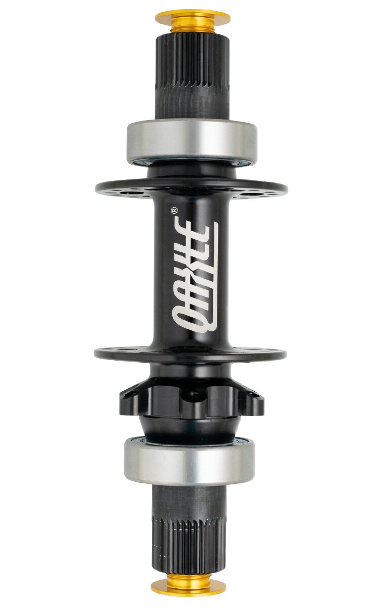

Thats a great weight. It’s nearly half the weigth of the ligthweight Q-Axle 32h disc hub. If it offers the same strengt, it’s a really great product.
This design looks like it would not allow fpr a disc version without gaining a lot of weight.
Are you sure? It looks like the 318g announced by Qu-ax are including the bearings and spacers.
  • (w bearings, screws, spacers): incredible 318 g
As the bearings seem to weigh ~60g each, that makes the hub ~200g. A bit more than this new Ti hub, but not twice the weight.

The Mad4One Ergal Hub weights around 315g total incl. Bearings and Screws
They are not really ready to compare. The Q-Axle hub is indeed only a little bit heavier than ours as @Maxence has pointed out, which is respectable since it’s aluminum vs titanium; but it made a lot of compromises to achieve that weight. Aluminum is already not a strong material for hubs, it was made even worse by hollowing the axle out, so its strength won’t be on the same order of magnitude with our (solid) titanium product. In fact, the official page says:

The center of an axle only adds little to nothing to its strength. A bigger outer diameter (what quax did) with a hollow center can be stronger than a slimmer full axle.
When you have two axlel with the same outer diameter, one is solid an on is hollow and the inder idameter is 1/2 of the outer diameter then the hollow shaft has 25% less weight but only has only 6.25% less strength. Q-Axle uses a bigger outer diameter than ISIS (24mm vs 22mm) which then also allows for a bigger inner diameter without loosing strength.
Thanks for clarifying that. It doesn’t change the point though - it’s for mild use only.
