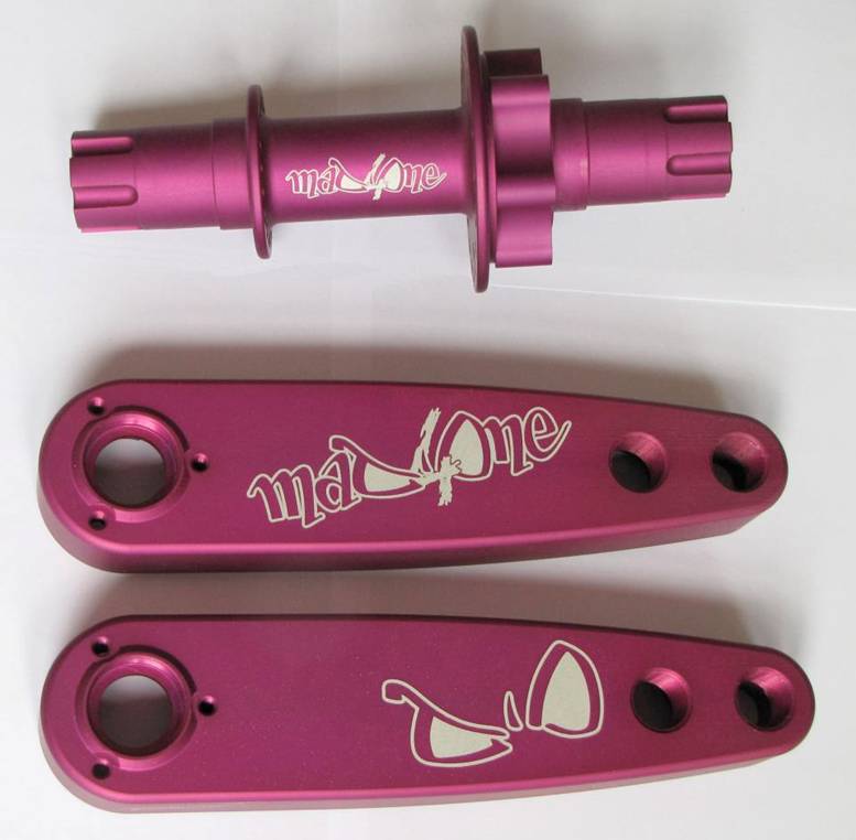

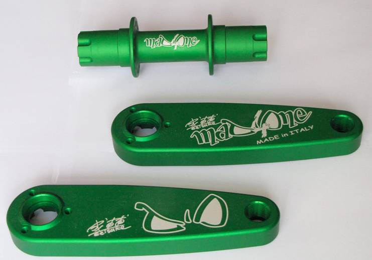

The Seisuke Kobayashi Signature race kit is in green, and the disc brake hub and double hole cranks are in pink. Soon, you’ll be able to customize the color of all your Mad4One parts. For more info, check out the facebook page and website.

I think its a mistake moving away from ISIS. I would have bought a disc hub, but I want to use my own cranks.
Same. I love the hub design, but would use different and lighter-duty ISIS cranks in my own build.
Glad to see the company expanding offerings, which implies growth. I imagine this is a very hard market to thrive in. Best of luck to those at Mad4One.
Not ISIS? What were they thinking?
If it was ISIS, I’d consider buying a disc hub, oh well
The hubs are made of ergal, that is why the ISIS pattern is different. The entire hub and crank are EXTREMELY light and strong. I am using the non disk hub on my 24inch street unicycle and I have yet to bend or break the hub or cranks.
Yes it does seem kind of odd to have a different ISIS pattern but after you feel the weight difference between all the other hub and cranks you seen realize the MASSIVE benefits of having a light hub. Your control of the uni goes up, hiking/walking with the uni is a lot easier (I rode my uni on campus both semester this year and the light weight made it a joy for riding through crowded hallways and walkways, also made it nice for when i had to carry my uni in class).
These hubs and cranks are quality, each and ever hub is made one at a time in a small machine shop in Italy that machines parts for the Bugatti super car. Yes they are expensive, “you get what you pay for.”

I an guessing that the pictures shown here are just computer models. Please tell me if I am wrong but it looks to me like the splines on the hub don’t match up with the splines you can see on the green cranks suggesting these aren’t the real deal.
Ergal is just another name for 7075 Aluminum, no reason for a new crank interface.
They’re prototypes I believe, not computer models. You’ll be able to see them at unicon. ![]()
On the question what the type of spline is it they answered on fb:
It is a MAD4ONE system developped by us. With this spline is possible to have Ergal hub strong as CrMo Hub with 30% of weigth.
