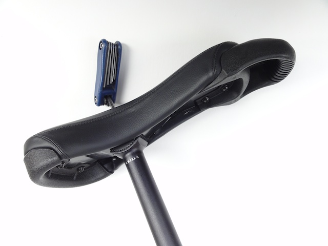

With bolt access through the top of the saddle, it takes literally less than a minute to install a seatpost. If you’re travelling, it’s really easy to leave the post in the frame and just take the saddle off the post.
I don’t have a closeup of the bolt hole but the attached shows the basic concept.
