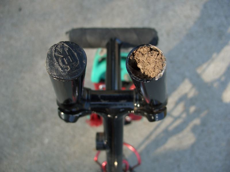

My Wyganowski setup has a pair of bar-ends on the front, attached to what was intended as a bumper. When I took that Coker off-road, it became much more likely that I’d drop it and after chewing up a few end-caps I finally figured out to loosen the bar-ends and flip them up and out of the way for MUni. I don’t think the bar-ends ever shifted position in a drop though. And this is with being dropped hard enough to pick up big clods of dirt (picture below).
But on pavement, I hardly ever drop the unicycle so I wouldn’t worry about that for myself. A long and low handle is going to be the first thing to hit the ground in a forward UPD, unless you add a further bumper in front of/below that (heavy). So we have to get used to the idea.
