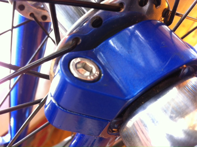

I found this old thread on an issue that doesn’t seem to be discussed that much considering how annoying it is. Although there is plenty of discussion on how tight to turn the bearing cup bolts which I have digested and experimented with over a couple of years of loving KH muni ownership, only Loctite has been suggested to prevent the inevitable loosening of the bolts over 10 or 20 kilometres or so. (Unless there’s a thread on the blog that I didn’t find). The split washers that come standard don’t seem to do much to prevent loosening.
For the last few months I have had blue Loctite in the threads and this slows the loosening to every 50 kilometres or so but makes removing and replacing the bolts somewhat of a trial. It also gives enough resistance to turning of the bolts that you lose the feel of how tight you are snugging them up.

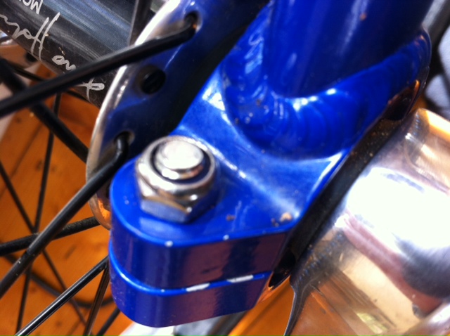

Now there’s no way my understanding or experience of a unicycle would come anywhere near to that of Kris Holm. But over the months I have not been able to put out of my mind the idea that bolts with locknuts would solve this problem. So eventually I decided this was an experiment that I had to undertake for my own satisfaction.
So, I cleaned out as much of the Loctite as possible with Loctite Glue Remover and acetone. I bought some 6mm x 25mm metric stainless steel bolts that protrude on the topside and some Nylex style locknuts (for their rounded profile). No washers or split washers. I tightened the bolts up just enough to stop the bearings moving around. There was nice free rotation of the wheel. Then I tightened the locknuts up nice and tight. There was no alteration in the bearing cup tightness with tightening the locknuts.
Went for a ride. Developed some creaking after a few ks. I figured this was the residual Loctite in the threads or some dirt or paint flattening out. Tightened the bolts again. Did about 10 ks of muni yesterday and no creaking developed and the wheel still turns freely.
So this is my experiment, and if I post this today it will be a prospective trial. I’ll report progress every month or so. Main outcome measure: frequency of the need for tightening of the bearing cup bolts.
Here is a photo of the new bolts with locknuts.
Not sure if you need to do that on a KH frame. Unlike other unicycle types, where the two halves of the bearing holders don’t meet, you have to limit your tightening so it doesn’t put too much pressure on the bearings. But on a KH (or other types of machined bearing holders) the two halves are meant to press together. If this is the case with yours, it’s okay to crank them down nice and tight.
However if tightening the bolts a lot does cause the wheel to not spin freely, the locknut approach seems like a great idea. On lesser unicycles, with non-meeting bearing holders, locknuts have historically been a sensible upgrade. Those already had bolts that stuck out, so you only had to buy new nuts. It’s slightly more involved for unicycles like the KH where you also have to get some longer bolts.

Is that true? Doesn’t that conflict with the Schlumpf hub instructions to only tighten to <5Nm? And once the caps are in contact with the frame, how will tightening any hard have any effect?
I’ve found this to be a problem in the past and ended up using a belt sander to remove the paint and perhaps a few microns of aluminum from the surfaces between the caps and frame. I could then tighten correctly (to my judgement), with a tiny gap, and I’ve never seen it as a problem.

An update on my experiment putting locknuts on the bearing cup bolts on my KH26:
Creaking developed 3 times over 2 weeks and I tightened the bolts each time, after which the creaking stopped. This may have been loctite in the threads squishing down.
For the last 2 weeks no creaking has developed, no tightening of the bolts has been necessary. The wheel spins freely.
I may have solved bearing cup loosening on my KH26.
Let’s see what happens for the next month.
Locknuts have solved the issue. A month since my last post, riding muni 4 days a week (how did I get so lucky!). No adjustments to the bearing bolts have been necessary.
