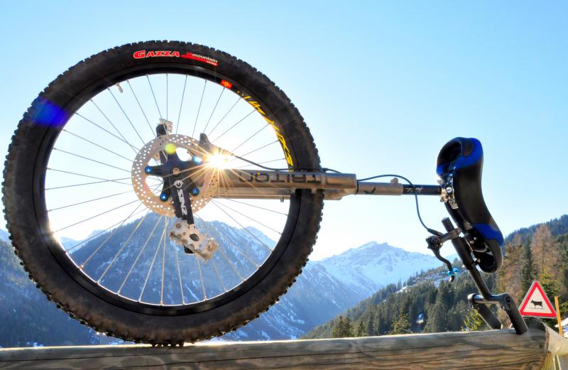

Now that’s a whole different beast. The mountainUni version can use un-modified hubs whereas the prototype one that UDC has shown off has a custom hub to mount the disk brake on.

There may not be enough room inside the stock frame for a disk. You need to buy or build a new wheel with a hub flange that accepts a disk. The frame needs to be wide enough to clear the rotor and you need a mount… typically the cost of a new wheel, frame, and weld on mount. All homebrew disk brake set ups to date have custom frames.
Until recently, no unicycle specific hub existed that received a disk. the only unicycle that comes with one stock was engineered ground up to fit the disk wheel. That unicycle is $1000+ and probably cheaper than purchasing the wheel and building a one-off frame to utilize it.
Mountainuni.com will solve that at a third the cost by selling a kit that will bolt on in the form of cranks and a bolt-on caliper mount to receive the disk brake. the lateral strength of the wheel will also be maintained since the wheel will be evenly dished, while not increasing the q-factor, which a wider frame likely will. Our aim is to make a kit that just bolts onto your current uni without modification.

the problem is not the disk, the problem is not enough space for the caliper to the spokes.
I ride Large marge rims because Koxx and KH rims do not resist my style and / or weight. building the disk inside will weaken the wheel - so I would not do this, apart from all the other benefits kb1jki says
since the Q faktor is no more than without disk there is no disadvantage in outside disk. the distance between pedals is even larger with an inside - as you see at the Nimbus impulse disk.
the inside disk is not protected any more than the outside, if you hit the disk hard enough it will bent - the same problem you have with the even more unsheltered Maguras exposed near the frame shoulder. besides the Mountainuni disk system is build much more solid than usual bike disks.
my intention is to build the best and most durable muni, that is why I reanimated with Dmitry the Triton projekt. I created, build, and designed a lot stuff by myself, but the MountainUni system was the best and that is why I combine the Triton frame with the MountainUni brakes.

PS: I forgot: its the only Schlumpf hub combatible disk brake system!
Jogi - this is huge! Let’s not forget that little piece of info!
Are there cranks that work with Schlumpf and the disks?
the Sinz cranks which are added in the MountainUni brake set work perfect with schlumpf, I am rinding this setup since last summer
Schlumpf hub is also available, so you can oder a whole Schlumpf / MountainUni / Triton setup…

It’s just amazing! would never go back, easy to change wheelset (1 minute including changing seat height), doesn’t need a lot of power even going very steep, perfect in wet and cold conditions (ok it wasn’t really cold yesterday), don’t have to adjust before going uphill (Magura rim brake: I had to mess around all the time: going downhill turning it closer to the rim, but then going a little uphill it touched the rim…). if it works like yesterday, it’s like my muni-dreams are coming true ![]()
