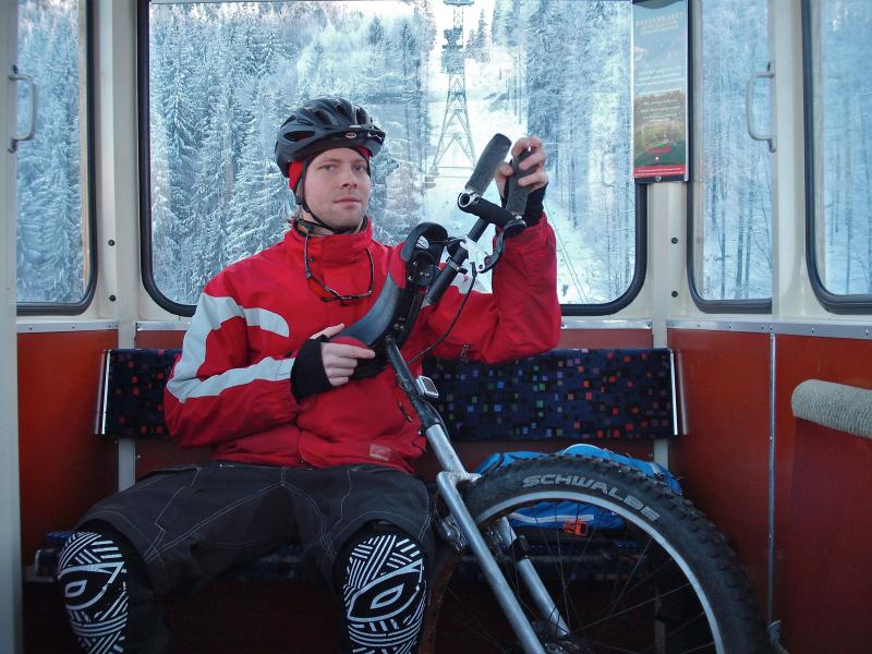

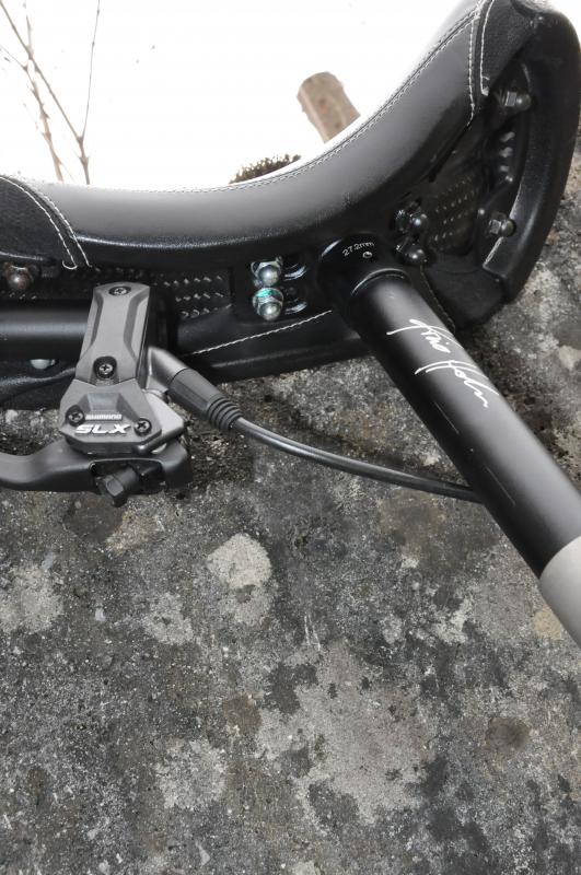

by the way, dear mister holm, how about making the T-bar more suitable for the brake at the (normal) handle, something like this or even closer:

About the brake lever positioning question I have this recommendation, it isn’t directly under the seat but I got very comfortable with it also in technical muni conditions (the spooner might not fit for those levers though):

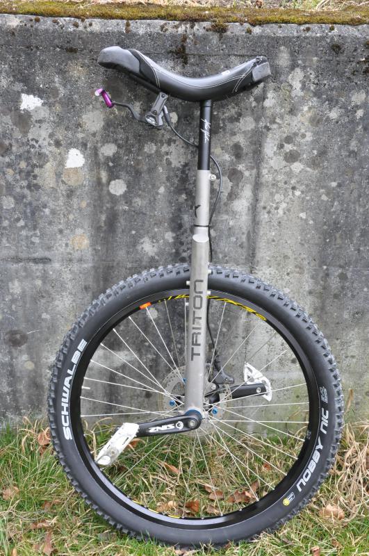

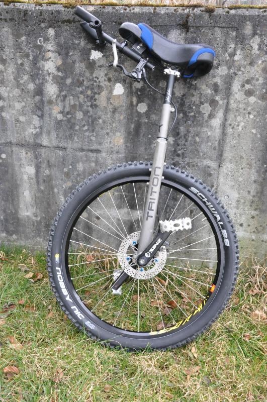

my “new” setups:
Pic 1: XC plus
Pic 2 & 3: XC pure (5.4 kg)
(there is still a DH version and the 29" geared, pics will follow later)
I wouldn’t think it would be too difficult for some company to just design a different brake lever, not talking about a brake system, just the lever itself, to be better suited for grabbing on a uni. Because turtle, that lever solution you have with your t-bar uni seems to be sacrificing quite a bit of leverage, are your brakes just really sensitive so it doesn’t matter?
Are there issues with designing parts to fit into other companies equipment? Like patent issues?
yes, that would be cool. but why do you think my lever is sacrificing quite a bit of leverage? i don’t think so, it so far it works very well, also because for the dinsc brakes there is way less force necessary
edit: do you think i’ve got less way to move the lever? thats not the fact at all, its quite the same way when you look exactly to both pictures

It’s nice to see you are posting the pics! I like how you are using a single frame with multiple wheels. Looks like you have all the spacers between the rotors and cranks, are you using different hubs on each wheel? Have you changed the spacing between the rotors and cranks to get each wheel to consistently align the rotors into the caliper on the frame? It seems that after the initial set up, the wheel swaps take very little time.
I like the Schlumpf hub on the 29" wheel! Have you tried the geared set up? I will warn you that braking while shifting is not ideal with this system, release the brake during shifts.
The crank arm lengths seem long. How long are the cranks? Were the 155 Isis cranks not available? If you drill and tap at a shorter length, which has been done before on the Sinz cranks, I do not advise doing drops while riding the longer pedal position, as the cranks may stress and crack at the shorter pedal position. It’s best to drill and tap the Sinz and cut off the rest. I’ve been running dual hole 150/125 on my 36er with no issues for a year, but I have not been doing drops more than curbs and I don’t Muni it.
