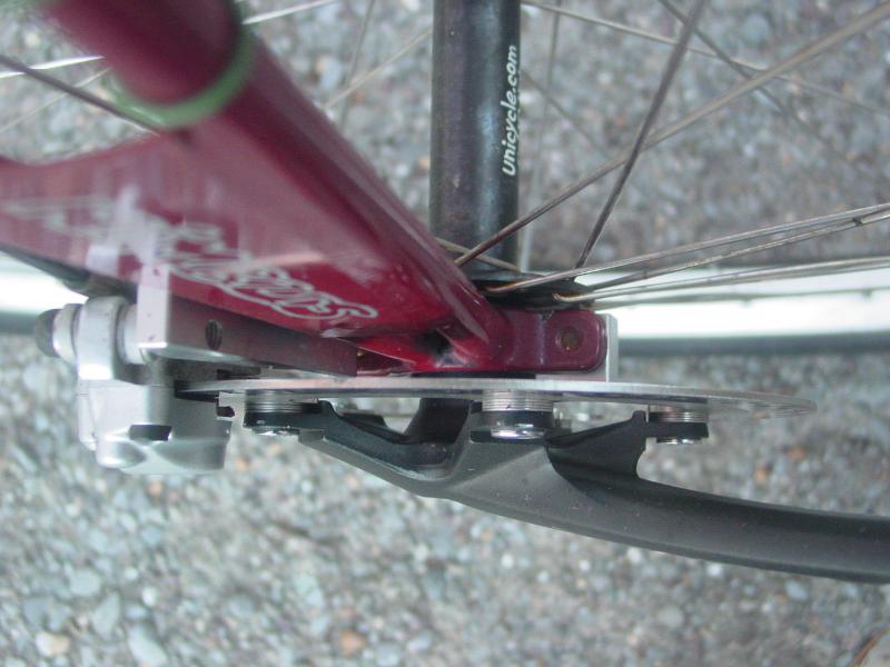

this is how it looks on my 29er, with a welded on caliper mount and sinz cranks:
you may have to take it to a bicycle shop, like a pro bmx shop to get the spacing on the axle right. do you do your own work?

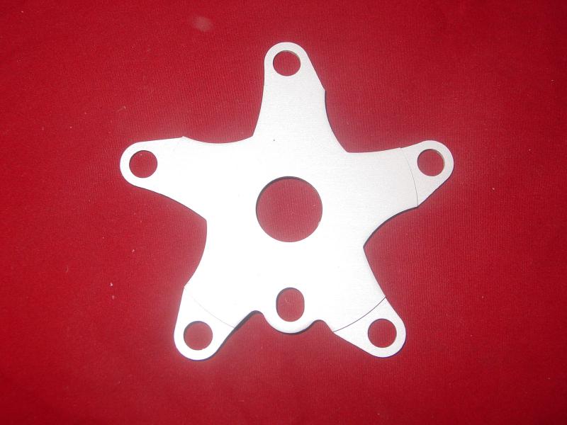

This is the type of spider that will work on most spline type bmx and torker uni’s…

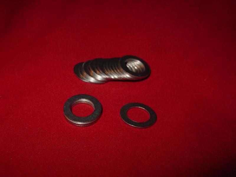

these are 20 military grade stainless 1mm thick spacers that are produced to exacting standards. Unlikely to find anything like this at the hardware store or even a bike shop. 4 spacers go between each spider arm and rotor. they compensate for the difference between isis 8mm and 6mm spacers as well as any difference in spider arm alignment as well as spuare taper crank creep as they wear from repeated tightening. These spacers are as important to the system as the Sinz cranks, chain ring bolts, and the mount system weather weld on or bolt on types.
Once my bearing moved a bit and existing 4mm spacer was not enough, then I took a copper pipe and pipe cutter and prepared my own spacer that fits ideally. So I think this part is not that crucial.
possibly less so with your ISIS cranks, but more so with Schlumpf or square taper cranks. I have found that when I assembled the rotor with them I can take one out if the rotor rubs the pads because of the crank arm spider… the spider arms can be off a mm. we’re going to be selling them for as little as $8-10 for all 20. What brand is your unicycle, will you be welding on the caliper mount?
The spacers are critical to the reach of the bolt on, and can be removed if the cranks creep inward. you will use less with the bolt on and 6mm Isis crank stops, and even with a weld on, square taper cranks should have them too.
OK, I’ll see how it goes with the spacers. Still generally I prefer to have one spacer than four of them, but that I will handle myself when everything is in place.

I understand. I have to assume that folks don’t know how to do things themselves, even though this is more of a do it yourself project! I just try to replicate what I know to work, I expect people to experiment and innovate with these kits. I hope to see success and not hear a bunch of “it didn’t work”… but I have faith in this crowd! please, use whatever spacers you like or what makes sense. if you weld on the mount, since you have isis the crank won’t move and you won’t even need spacers. if you got a bolt on though, you would. I’m just trying to be uniform for consistency’s sake. I can’t wait to see what you do with it!
