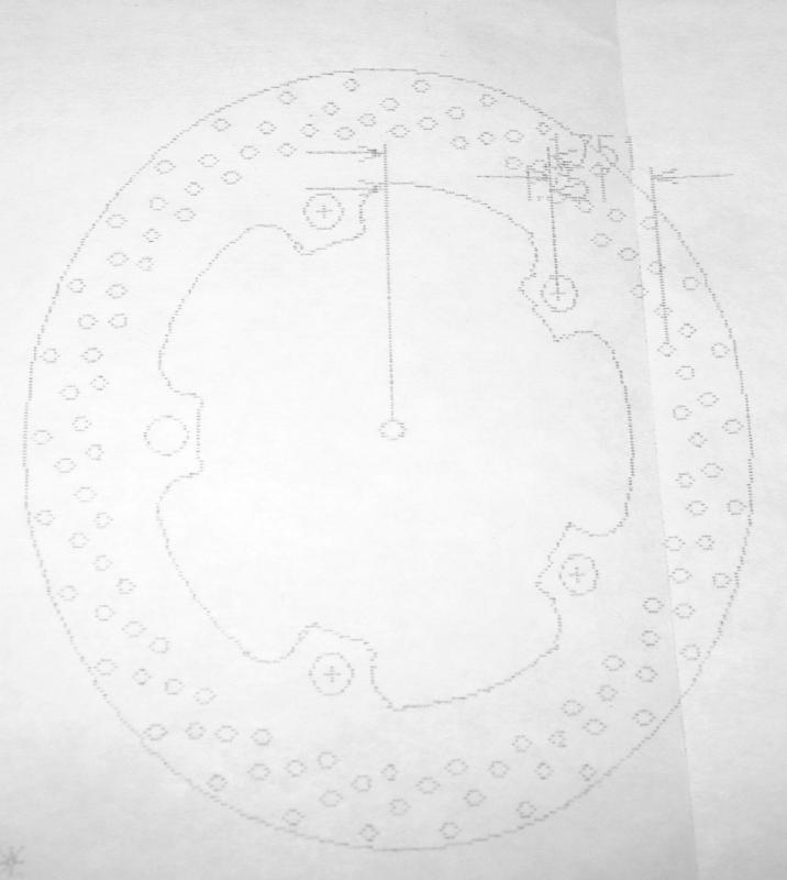

We also met with the machinist who will be carving the bolt on into an I-beam! this will eliminate much of the 215g that the prototype weighs, while remaining as strong and stiff. the difference between the KH and nimbus bearing caps is ever so slight and we may be able to make a universal bolt on between them. We’re getting quotes for the bolt-on and the other project next week.
Hopefully, by the time we are looking at the second half of the rotors, we may have some Bolt-on caliper mounts for KH and Nightrider folks! this may take 3-4 weeks, but that’s not very far off is it? we may even be able to restock 155mm cranks by then!
this is the new hole pattern for the rotor…
