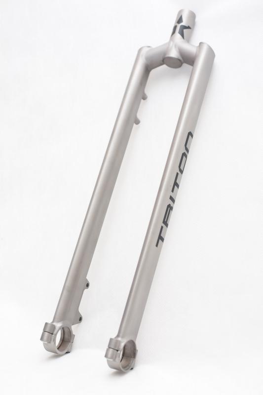

I love how you guys are teaming up with Triton. Seems like the perfect combination of small companies.
I am patiently waiting for my triton frame to arrive. Hopefully by winter.

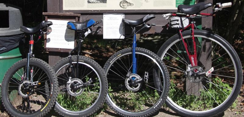

some of the second generation prototypes… (like the Rhino’s and Yogi’s)
we’ve got some milling to do…

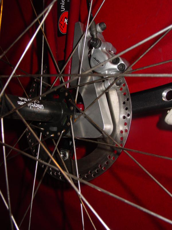

This is the bolt on caliper mount prototype… it is working very well and we intend to make one that bolts to a KH rig since welding to aluminum will ruin the heat treating and lead to premature failure. Besides, it’s nice to just bolt the system on and go! We are thinking of making a universal bolt on caliper mount that fits Nimbus, KH, etc… bolt patterns. Our intention is to only release them in ISIS 42mm bearing size, because the crank stop dictates the position of the rotor and the bolt on positions the caliper consistent with that spacing. Ultimately, however, it would be nice to see mount tabs on KH and Coker frames on the right leg for 180mm rotors… For now, there are lots of folks that already have KH frames without disk mount tabs that wish they had the option of upgrading to disk brakes. Please speak up!
This is the bolt on caliper mount in context with the crank, rotor, and caliper mounted. We’re meeting with the machinist to see how much we can mill out of it today…

That bolt-on mount is really tidy - nice design.
Rob
+1 from my experience with bicycles.
In addition, rim brakes (more or less depending on type) can get misaligned to the point where they rub the tire, which can cause premature tire wear and potential failure.
Question re the bolt-on:
Do the screws for the caliper through-bolt to a recessed nut we can’t see in the picture, or are they just threaded into the bolt-on mount? If the latter, is it aluminum, and if aluminum, how durable do you expect the threads to be?
