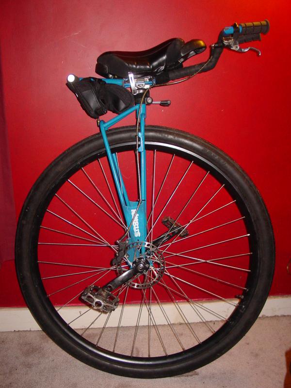

Forgive me if I am posting in the wrong thread. My fellow Nimbus 36" Impulse disc brake model owners must be having too much fun riding to respond to my post and I can’t say that I blame them. I am having a blast riding 15 miles a day at least 3 or 4 days per week. My question about replacement pads should be prefaced by saying I am not mechanically inclined at all which is why I opted for the turn key solution in the Impulse. Though now that I am totally hooked on that butter smooth feeling of disc brakes, I will probably be turning to Mountainuni when I go to purchase my 29er. Enough (too much) said. The Impulse hydraulic disc brake (Bengal Performance HELIX 1.1) replacement pads are part # PH02. My LBS said he has two brands (Hayes and Avid) that would fit. Now I need to learn how to do the replacement myself. To be honest, I am not even certain that it is time (200+ miles in) but shining a flashlight down in there I can see about a US Nickle’s width of orange pad remaining and I am going to park it when it get’s down to a dime’s width for fear of doing metal on metal damage to the rotor. One thing I am noticing is a clicking sound/feeling when I am really laying on the brake down one of Kentucky’s many hills. It feels almost exactly like it did when the pivotal seat post bolt on my Shadow handlebar came loose but this time only when riding the brake hard. I have read articles about DH mountain bicycles going through a set of pads in a week but I am sure they are much harder on them than I am just trying to slow down a bit to save wear and tear on these old knees. How will I know when it is time to replace my pads? How difficult (for the mechanically challenged) is the process?
The Impulse is a real cool rig, and I’m glad you get to enjoy the effectiveness and progressive feel of disk brakes on your uni! We hope to have quotes back from fabricators and manufacturers soon, so we know how much to raise and get production rolling.
It’s hard to diagnose pads without looking at them. Your LBS will best explain when it’s time to change the pads, since you’re likely getting the pads there. When you are ready, you should have a 5mm allen tool to remove your bearing caps and separate the wheel from the frame of the unicycle. Be careful not to squeeze the brake lever while the rotor is out of the brake.
Use a flat blade screwdriver to twist in between the old brake pads to widen the distance between the pads, so your thicker new pads may slide onto the disk when you are done. On some brakes there is a pin that you have to disconnect and slide out to remove the pads, and some are held in just by spring clips.
Notice a tab sticking out at the bottom of the pad and pull it straight down to remove it. If there is great resistance, figure out why and then try again. Slide the new pad in like the old pad came out, and replace the pin if there was one. Replace the wheel and fasten the bearing caps evenly so the same size gap appears on either side of the bearing to the frame.

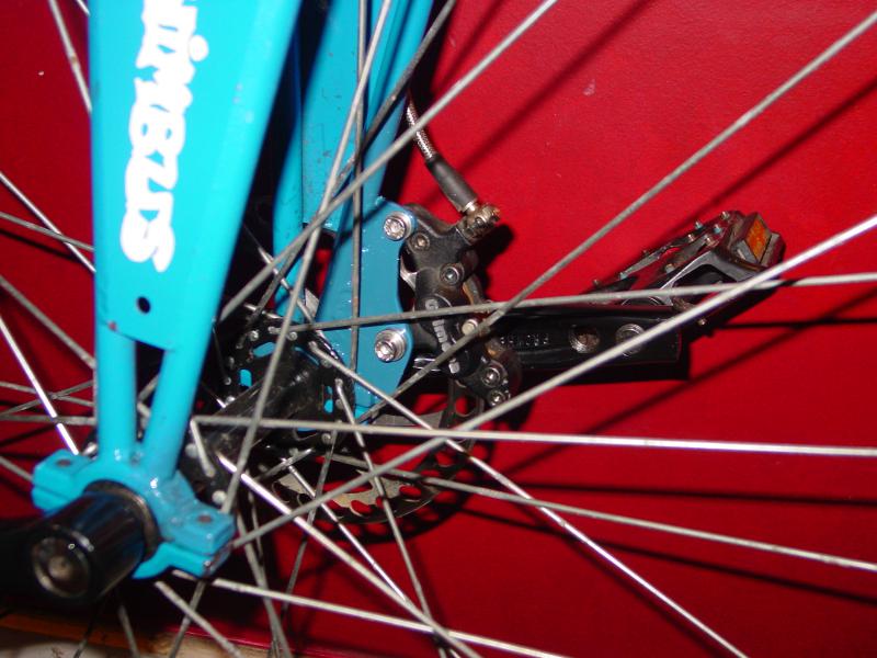

Any news on the KH frame bolt-on caliper mount?
I think all we need to do with our existing nimbus design is a different bolt pattern for the bearing holder and maybe making it match the bearing holder for KH aesthetics.

42 MM Bearing Holder
It’s my KH29er that will be the Guniea Pig for this experiment. And will be in process shortly. It’s as much about the 42 MM Bearing Holder as it is the bolt Pattern. Thanks for the prodding, we know this could be a hot item.

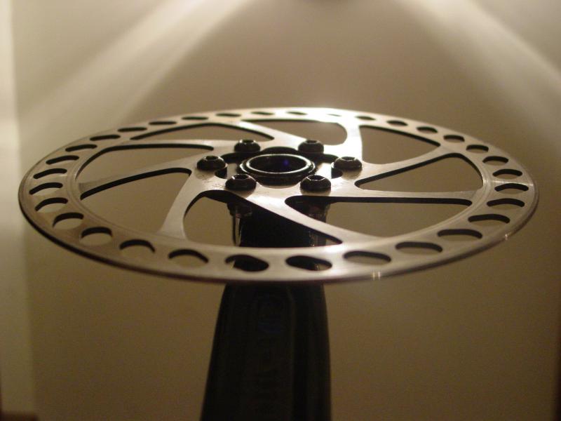

there are many sizes of square taper cranks from Sinz that will work well with the MountainUni rotors flawlessly. However, the Isis sizes of Sinz cranks are only offered in 165 and up. Who is willing to buy the cranks chop them down and drill/tap them or have a machinist do that to use our rotors as disk brakes on your unicycles?
because our crank resource has dried up, and the consumer may not have the interest in modifying the cranks we have been reconsidering the rotor concept and are designing cranks right now.
there is already a demand for the rotors and we could still have them made, but that depends on demand despite the limitation of the ISIS crank availability in unicycle sizes from sinz… we’re at a crossroads.
the current road block is the decided un-availability of a specialized broaching tool that we have to have made and are currently investigating it’s manufacture to ISIS standard.
Who still wants rotors?
