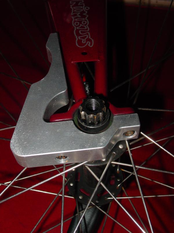

As for the mount, I think if you weld it on with the intention of putting two or three washers between the adapter and the mount that would be the place to adjust for the inward creep of the square taper cranks. As long as you move the washers from the inside to the outside of the welded mount you wouldn’t need shorter bolts as you adjusted for the creep. This might also have the benefit of placing the bracket a bit more centered on the tube rather than outboard towards the rotor.
Exactly, and agreed. The rotor is also spaced on the crank for creep, you can pull spacers from in between rotor and crank and shift them to the outside of the crank as it creeps in. So, you can space both the caliper and the rotor! the issue is that sometimes the cranks go on so deeply, that the chain ring nuts scrub the frame, and spacing the rotor can pull the chain ring nuts away from the frame. the cranks that were meant for 113, and 107mm chain lines keep the spider further away from the frame than those for 117mm bb’s for instance, and the crank can be spaced further with a crank spacer, and that modified square taper design the cranks went on further as well. square taper is cool and really won’t creep too much even with wear. the Schlumpf ISIS without crank spacers is the difficult hub with creep.

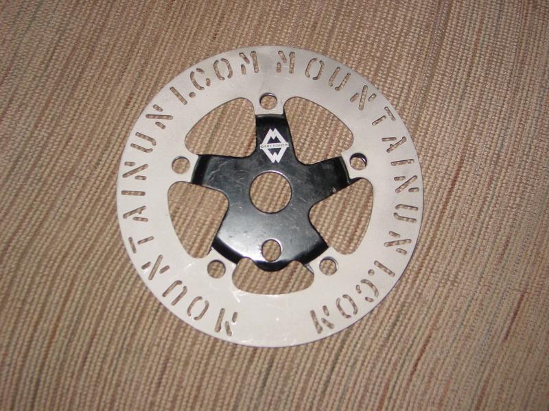

We have a specific 180mm rotor that is used in place of the stock rotor. the unique bit is that the rotor fits the crank. You get your 160mm version of brake (the 160 mm adapter works best) and bolt it to our weld on mount and install it.

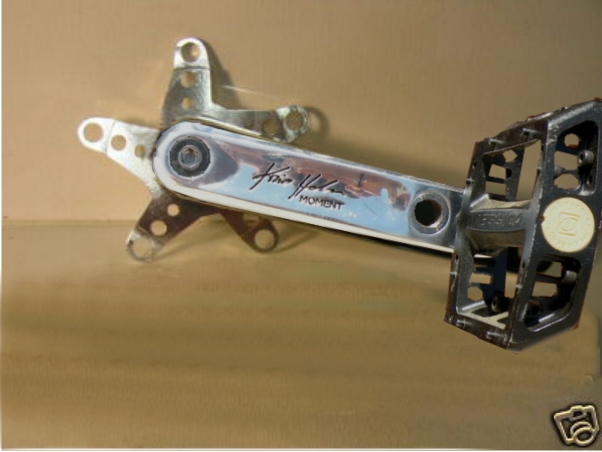

How sick would this be?
Very cool if it’s strong. Does it add Q?
It’s a photo-paint fantasy. I don’t think KH wants to forge a spider on his moments. The q on his cranks and the Sinz we use are the same. His crank is thicker, so I don’t know if they will pass the caliper anyway. It would have been cool, but he would have had to change forge tooling to do so. He could tap them for 6 bolt rotors, but that will only work on ISIS, since the bolts would bottom on the frame with square taper cranks without crank spacers. That would also lose the adjustment of the rotor on the crank with chain ring spacers like our rotors use. Getting the bolts away from the bearings allows for much more room.
Regarding that KH mock-up, it would be cool if you could make a spider that replaced the crank stop/spacer. I can’t think how you’d stop it rotating though, short of tapping a thread in the back of the crank and putting a bolt in (bit like a BMX crank). It’s a shame the splines don’t go all the way down the axle with ISIS - would have worked with the old-type splined hubs if you just made a splined spacer/spider/disc.
