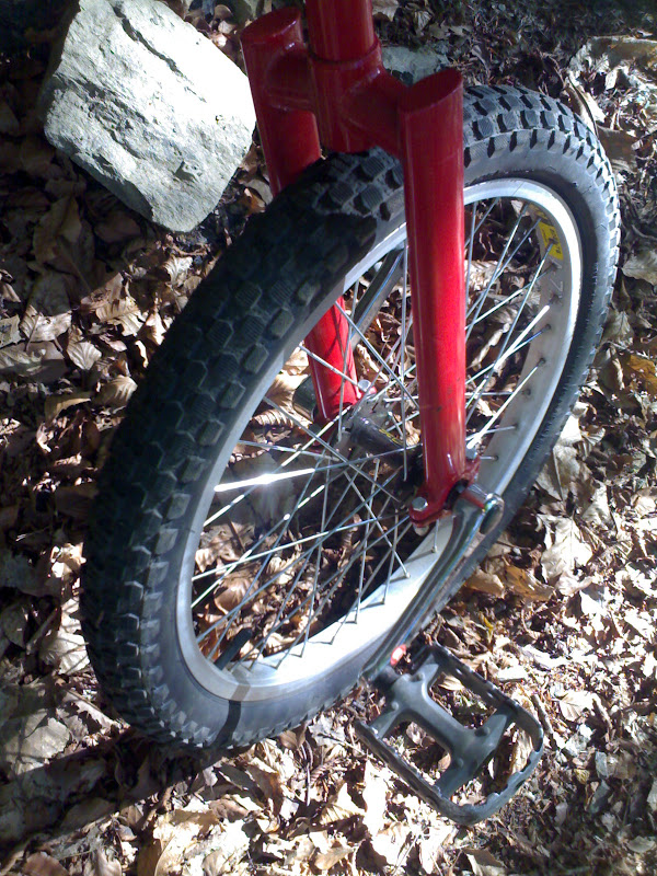

Update: I’ve bought a 20x2.125 Bmx dirt-tire for 8 euros, it fits well in my rim and there’s still more than 1cm to the fork. I think a 2.25 could go too…
But for now it’s great! it’s broader, it absorbs better and has a good grip. Now I… better feel what I can’t do because missing tech-skills or leg-power! But I’ve found a great short lap with a paved upgoing road I can smoothly run, and an offroad descent about my level. Well… is there something like the sensation of going off road on one wheel? It’s the better approximation to “freedom” I can find!
