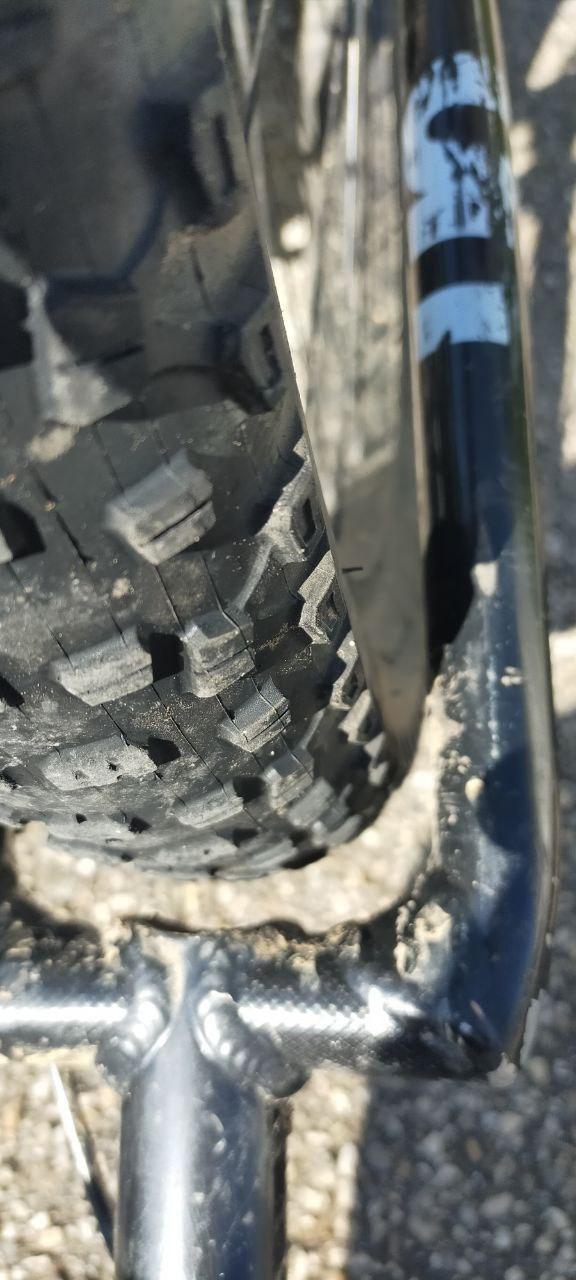

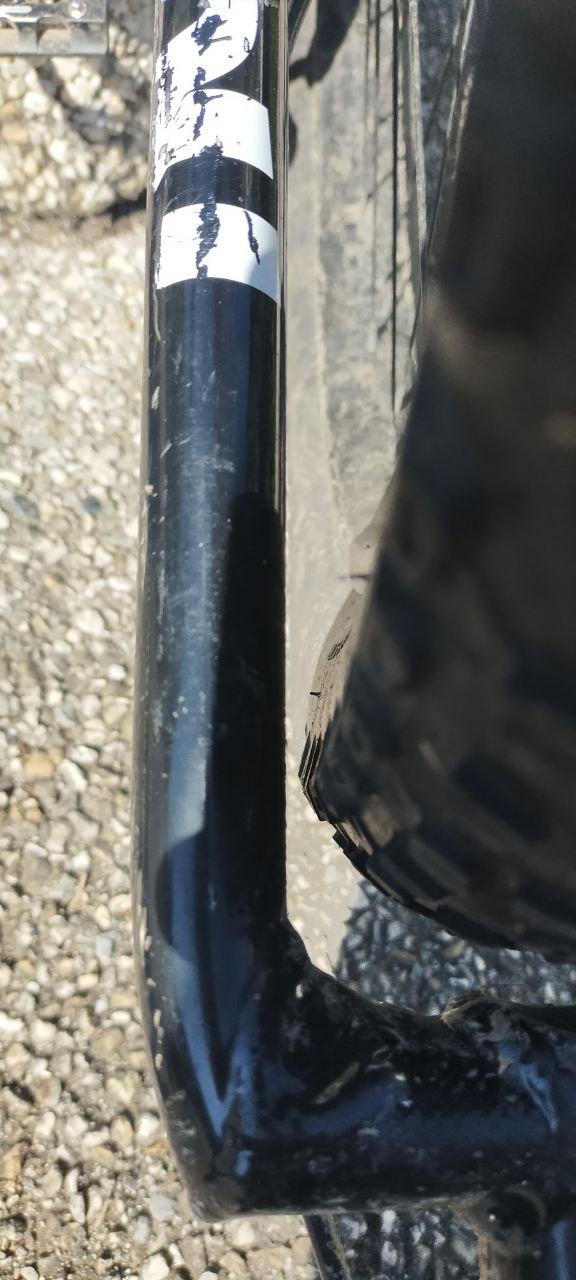

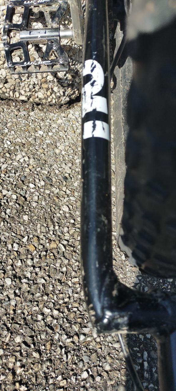

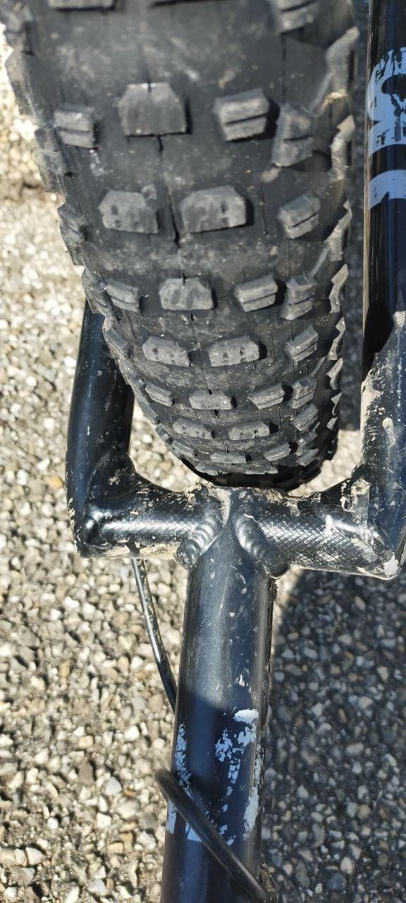

Here are some pictures I took of my set up:
I’d say there is less than 1cm of clearance on each side.
That looks pretty good. Enough space to not worry about the tyre catching and locking up.
Sure. But I’d say the Kenda Havok is a “little” 3" tire. You may expect other 3" tires to not fit.
The tire hitting the frame is really a non-issue:
