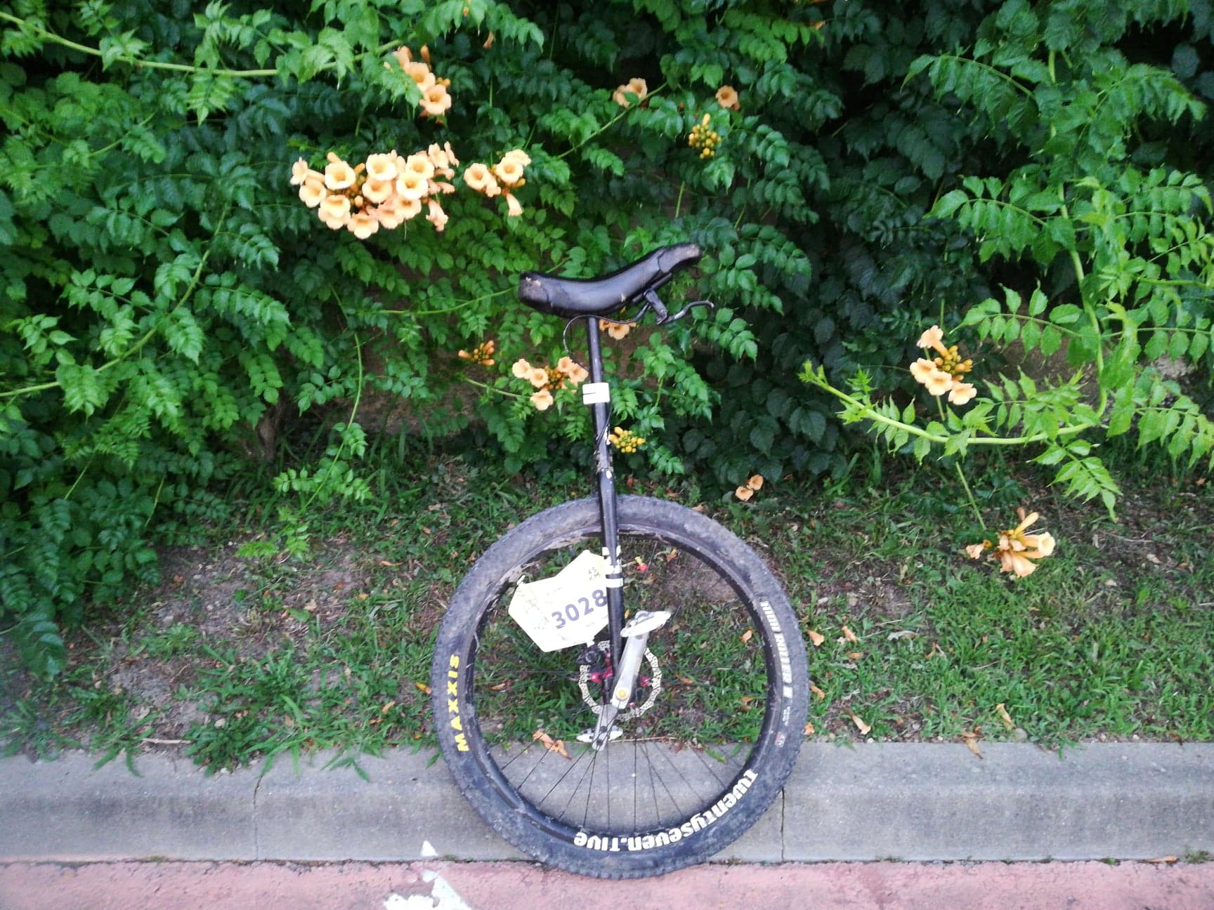

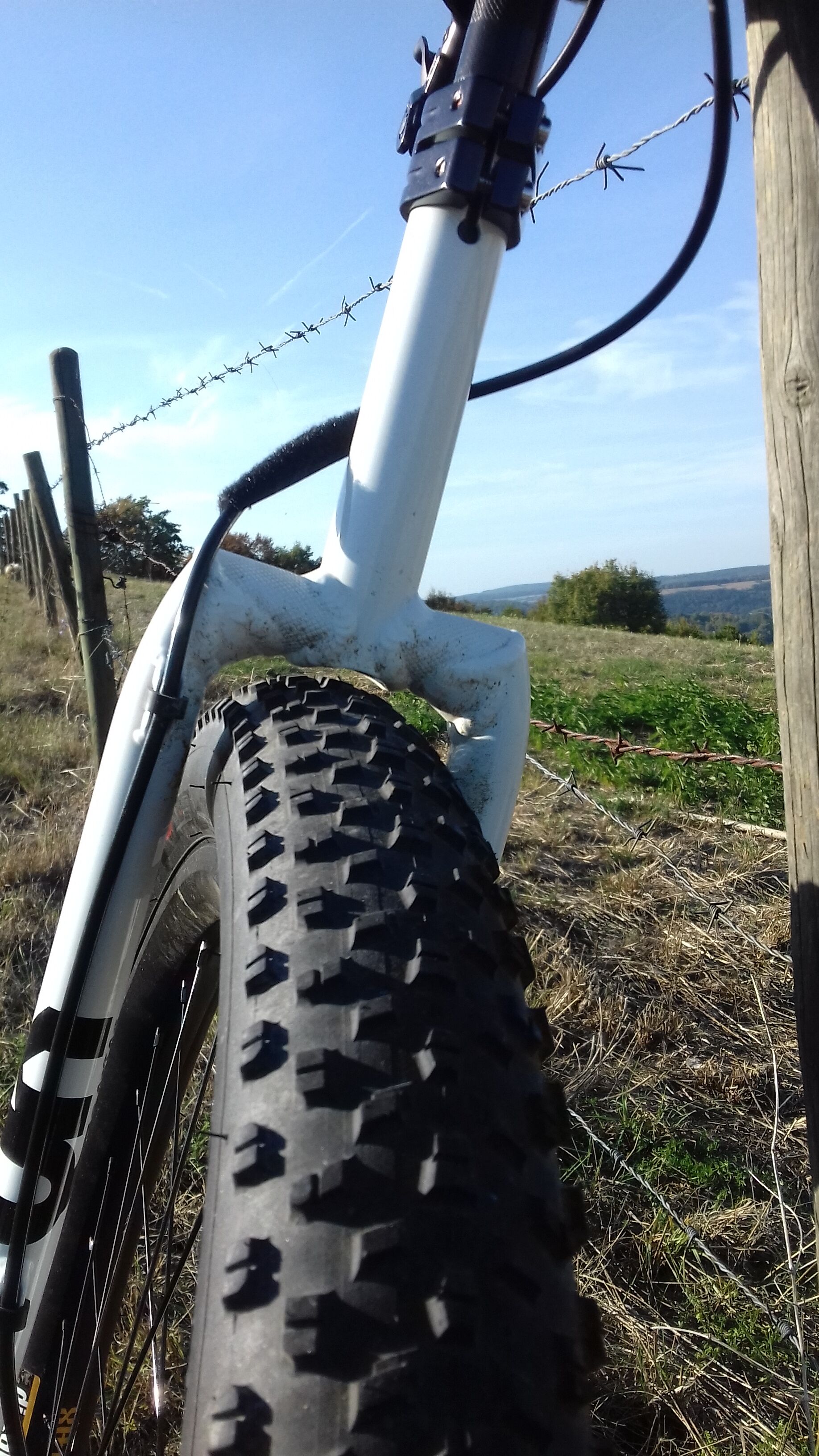

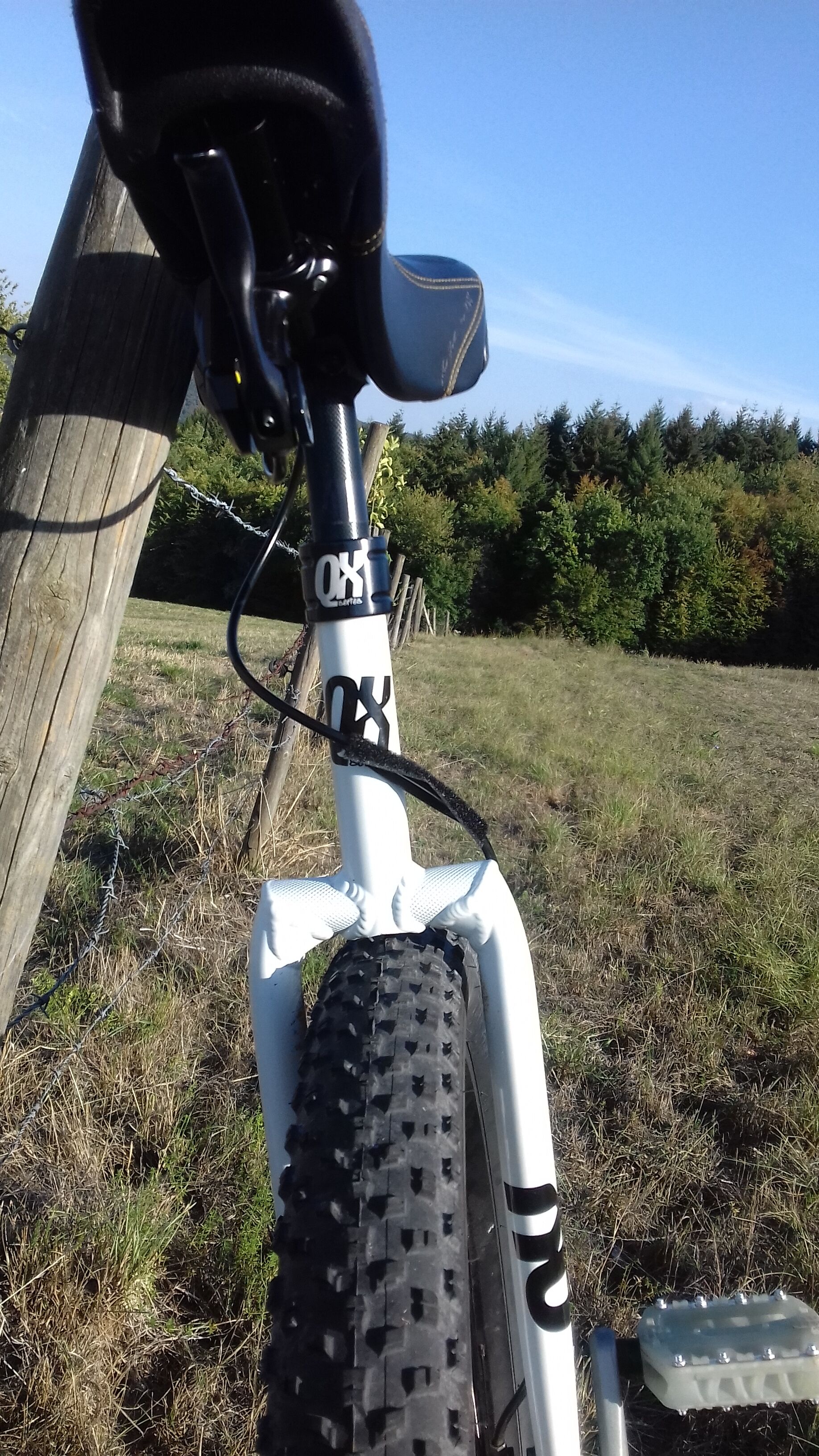

I have a Qx unicycle from 2016 running a 2"4 Maxxis High Roller II in a Qx frame - generation before the RGB model. It’s the squared frame, only compatible with disc brake. See these pics:
The tire is great for riding uphill - nice grip - but is too narrow to handle great drops. I’d like to go for a bigger tire but I can’t find how big this new tire can be. Would a 2"8 tire fit? I think a 3" tire would be too big.

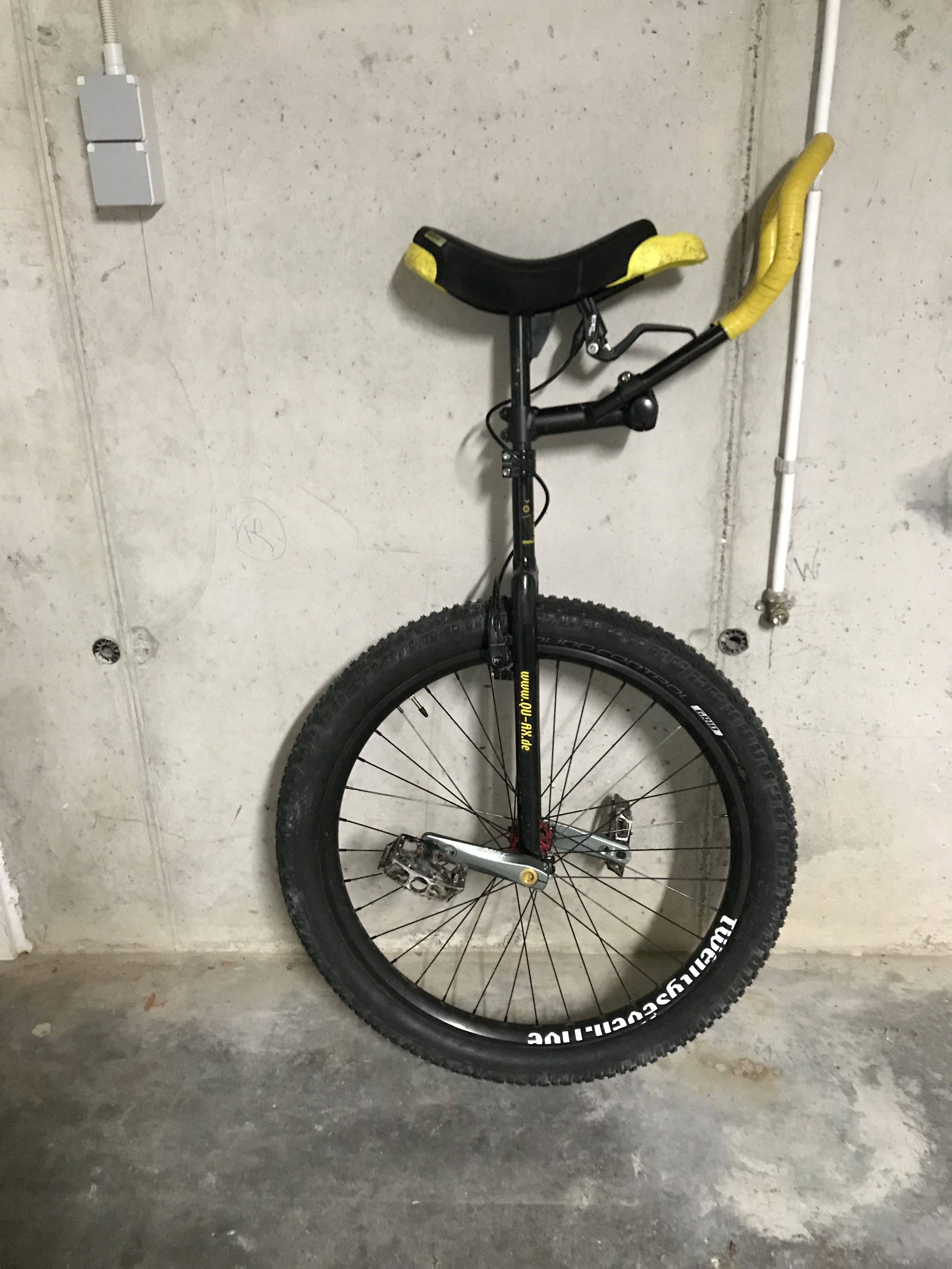

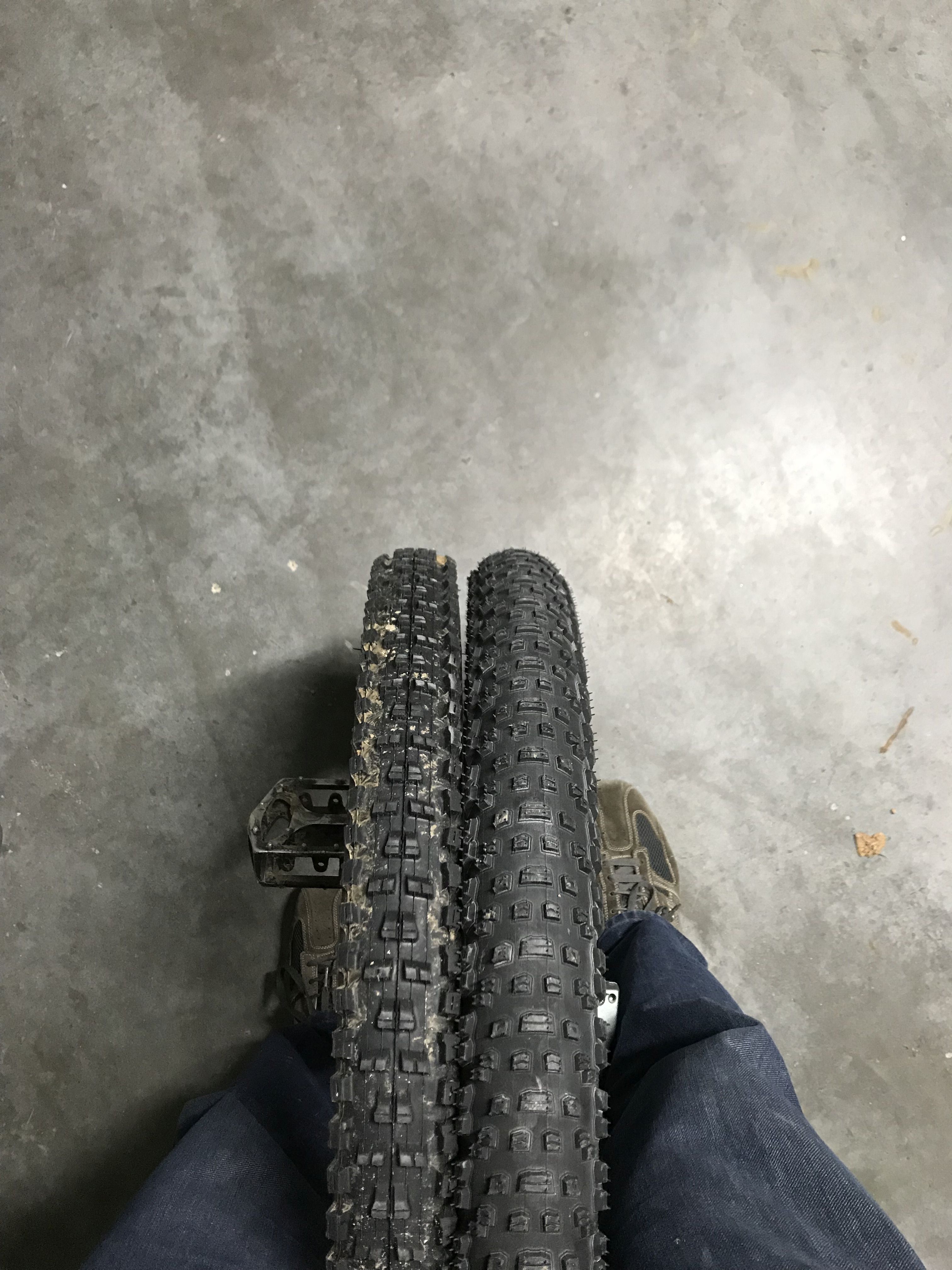

Yes, it has been centered since this picture has been taken - two years ago. However, I don’t know how I have been able to ride with this decentered wheel.
Cool. Then the next concern I have for you is the vertical clearance - I am doubtful a 2.6" tyre will fit (unless your pic has your frame at an angle). You might be at the max already.
I think there’s an angle. As far as I remember, the photographer was lower than I was so the clearance is probably greater than what we see on this picture. I sadly can’t measure it ATM.
I was hopping that some of the members of this forum have already tried to put bigger tires in this frame…

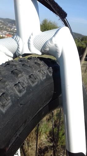

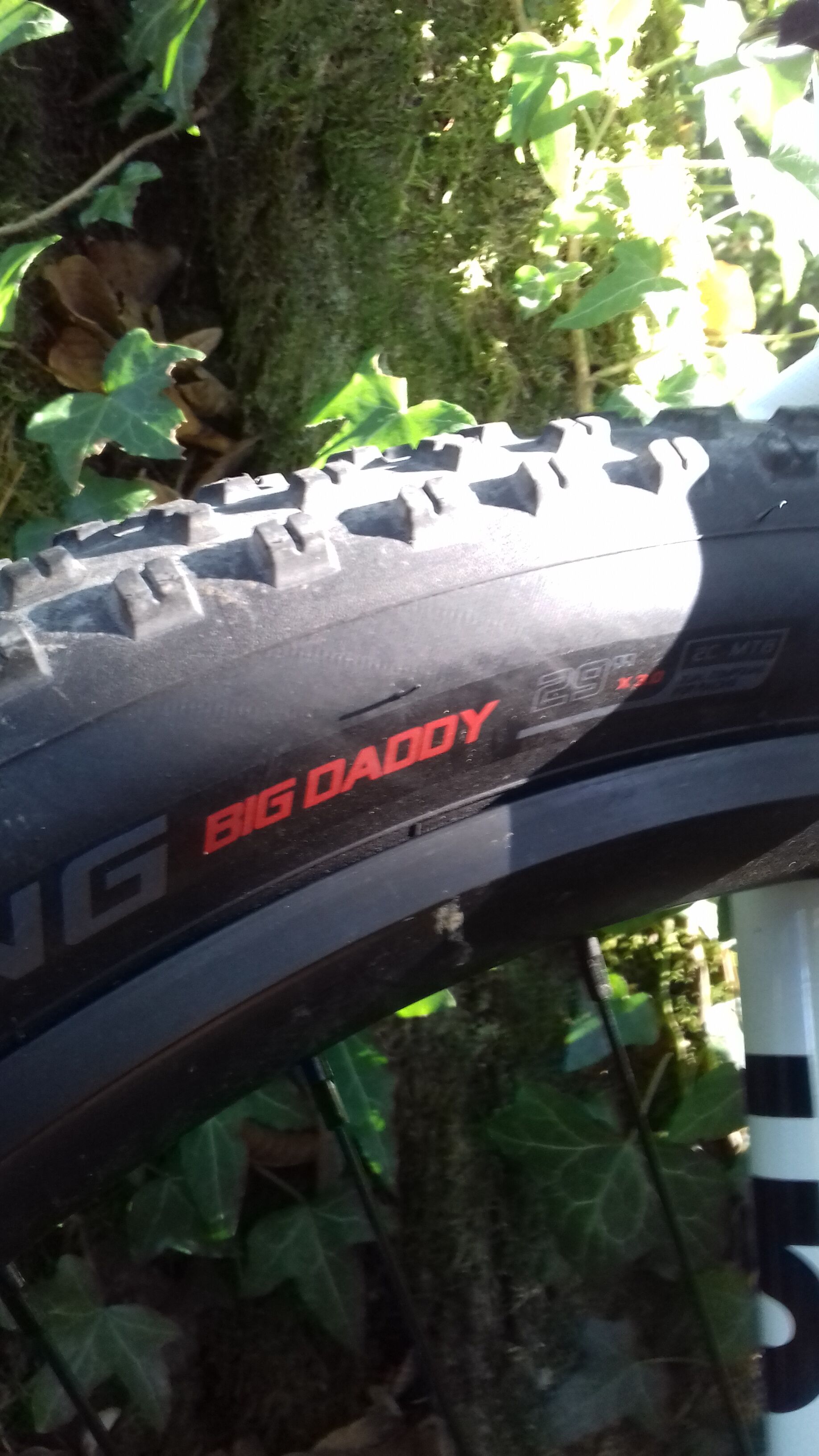

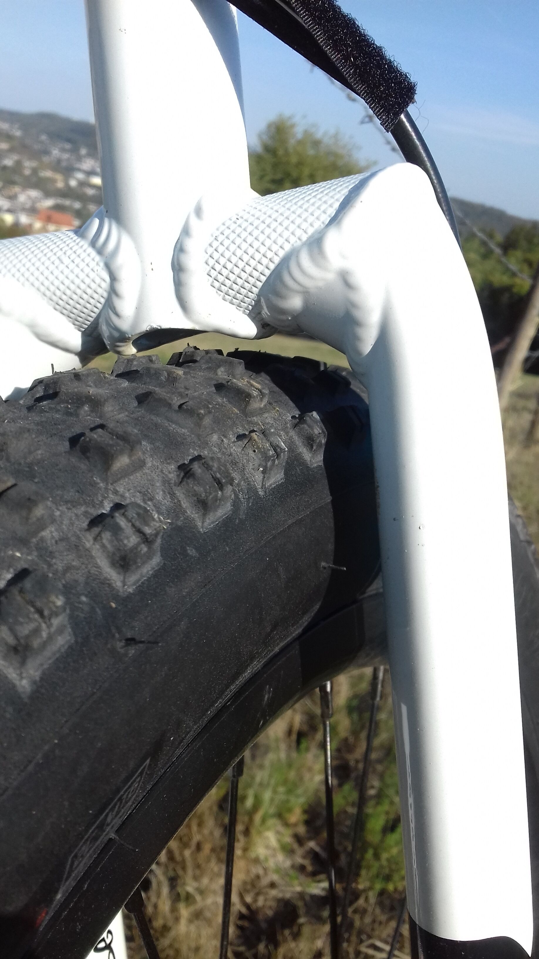

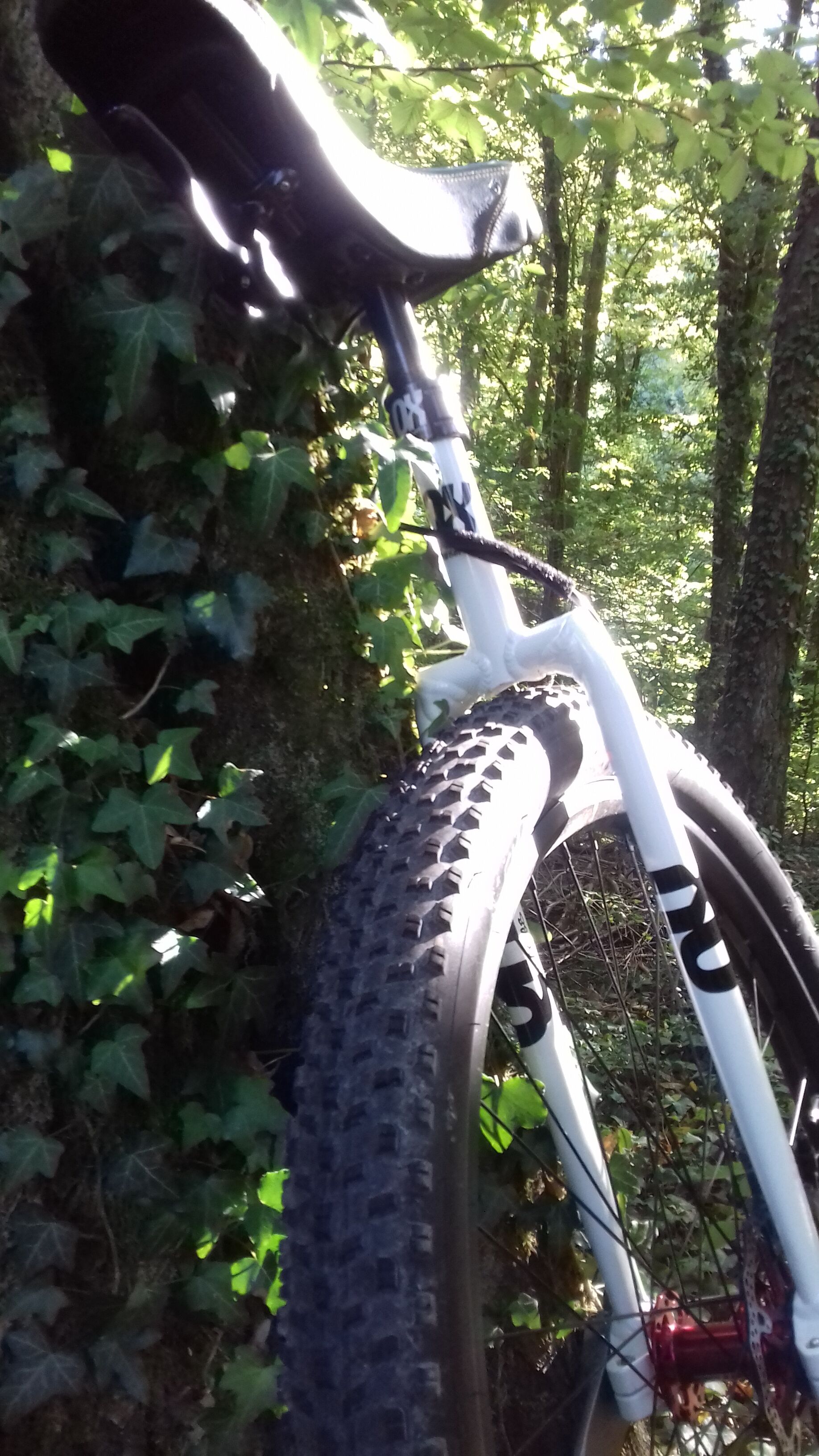

On the last picture we can see there still a bit of clearance in the frame. Not much but still sufficient. I’ll probably go for a 2.8" tire which should fit.

The width from inner leg to inner leg of frame at tire-height is 86 mm +/-2 mm.
The high from center bearing-cup to inside of frame crown is 376 mm +/- 1,5 mm on the disc! QX
