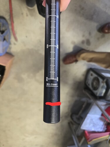

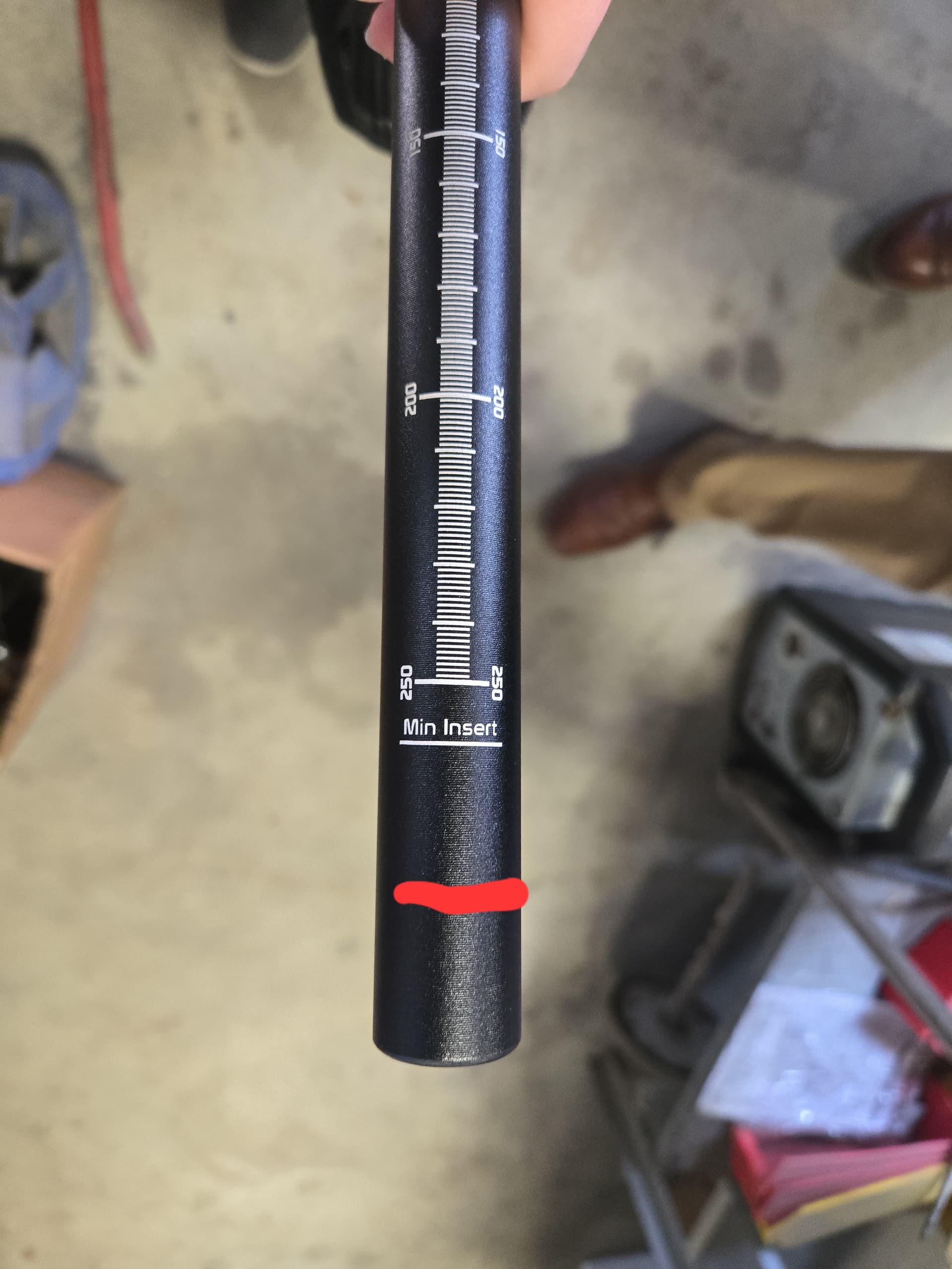

It arrived and I have put it together. I cut the post a little bit but it is still too tall by quite a lot. The red line in the picture is where I cut it. I also tried getting on with the cranks in the middle setting, not even the longest setting. The part that confuses me is how it shows a minimum line, but appears to have much more room beneath the seat clamps. Can i go past the minimum line?
I misunderstood the line so im going to be cutting it again. I thought that was the minimum line not the minimum insert length. Whoops
Yep, you could measure from the bottom to the line (usually around 10cm) and try to make sure that you have this amount inserted. That said, while the seat tube of my Oregon’s frame is longer than 10cm, the bottom part is widened, thus the “effective length” is only about 7cm. And that works fine. On my first uni I had the seat post only inserted about 4cm for many years (before replacing it). Even though that was barely more than the length of the keyhole slit, that worked fine. Was a steel frame, and a steel post, though. I think the minimum insert is more important on b!cycles where the seat tube / seat post usually doesn’t point straight up.
