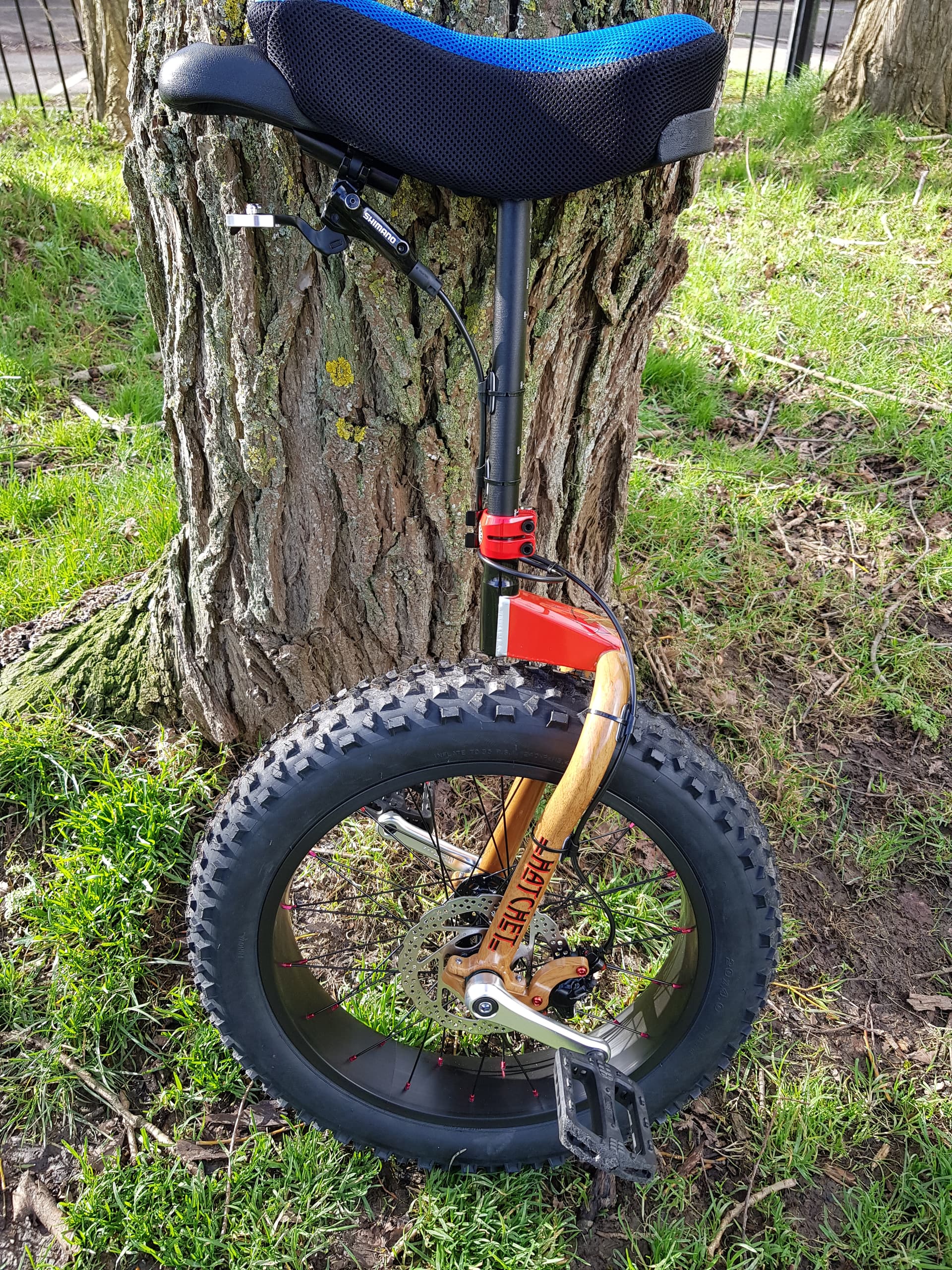

The 27.5" hatchet is 30.25" min, this is also easy. I could drop the saddles by another 3" on both the 27.5" and 29" hatchets. So if you have an inside leg with shoes of 29" you should still be able to reach the pedals with the seat dropped to its lowest position. Or you could always enjoy riding the mini 20x4" hatchet, a great unicycle, just a smaller version

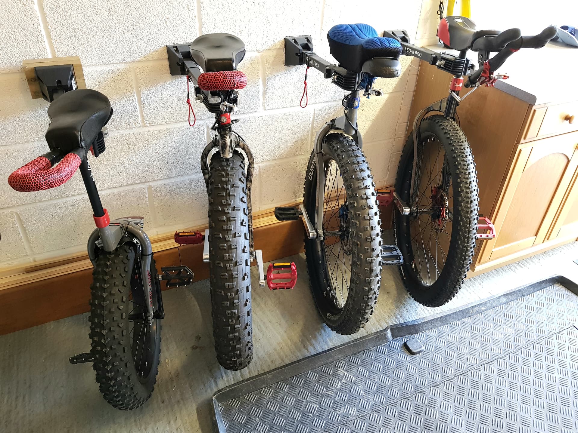

you know that you will save half of that space without the unicycle holders, like I do with piling them on top of each other ![]()
Yes it is the 26 x 4.8" version I have. It looked cool when it first came out and as it happens with me, it keeps nagging at me that I just MUST have it without spending enough time to figure out I really want it. I wouldn’t change anything about it and possibly just end up buying the 29" as well. There is still space on top of my pile.
Anyways thanks for the pictures. It gives a good idea of what is around. I never knew of this 20" fatty. It looks like fun, but I don’t think it is very functional. I’ve thought of getting a 20" muni instead.

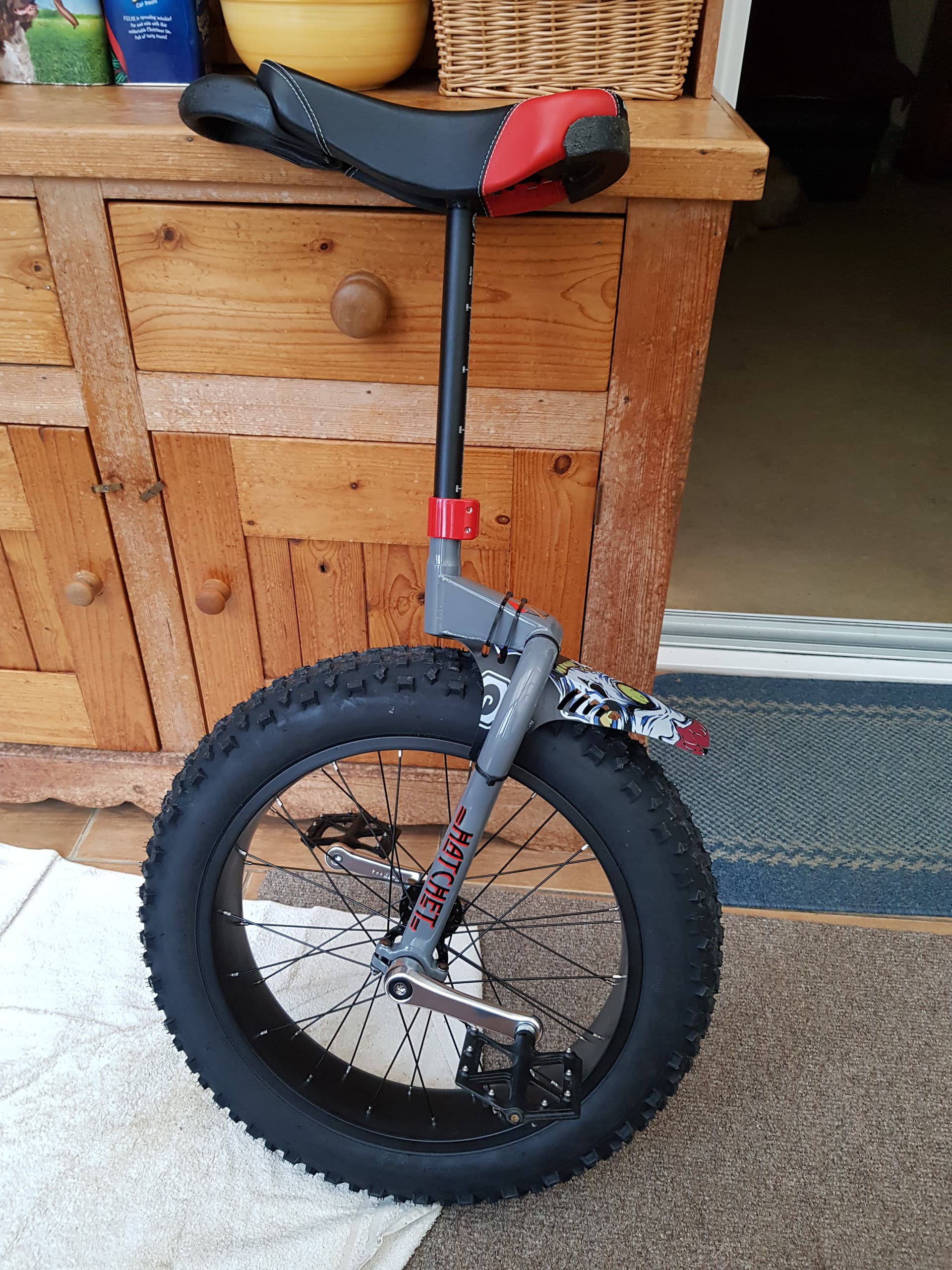

@Setonix The mini 20" is a great fun and every bit the hatchet. Its much more functional now after a few modifications. That big fat 4" tyre makes it feel bigger than it is. Feels and rides like its bigger brother. Light and agile and very easy to get on with. ISIS/brake converstion works and makes it very functional

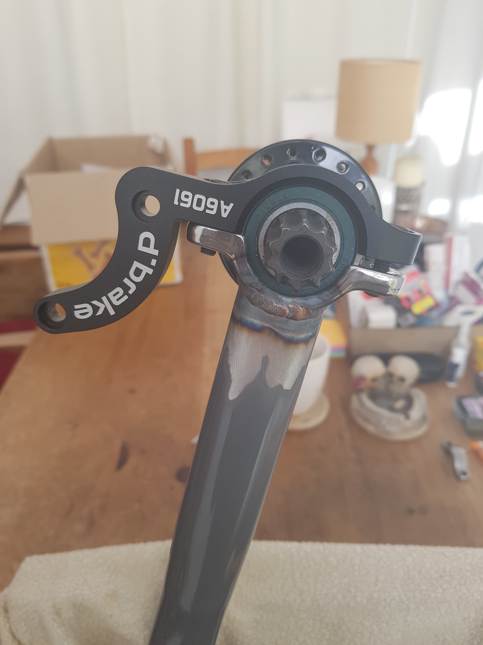

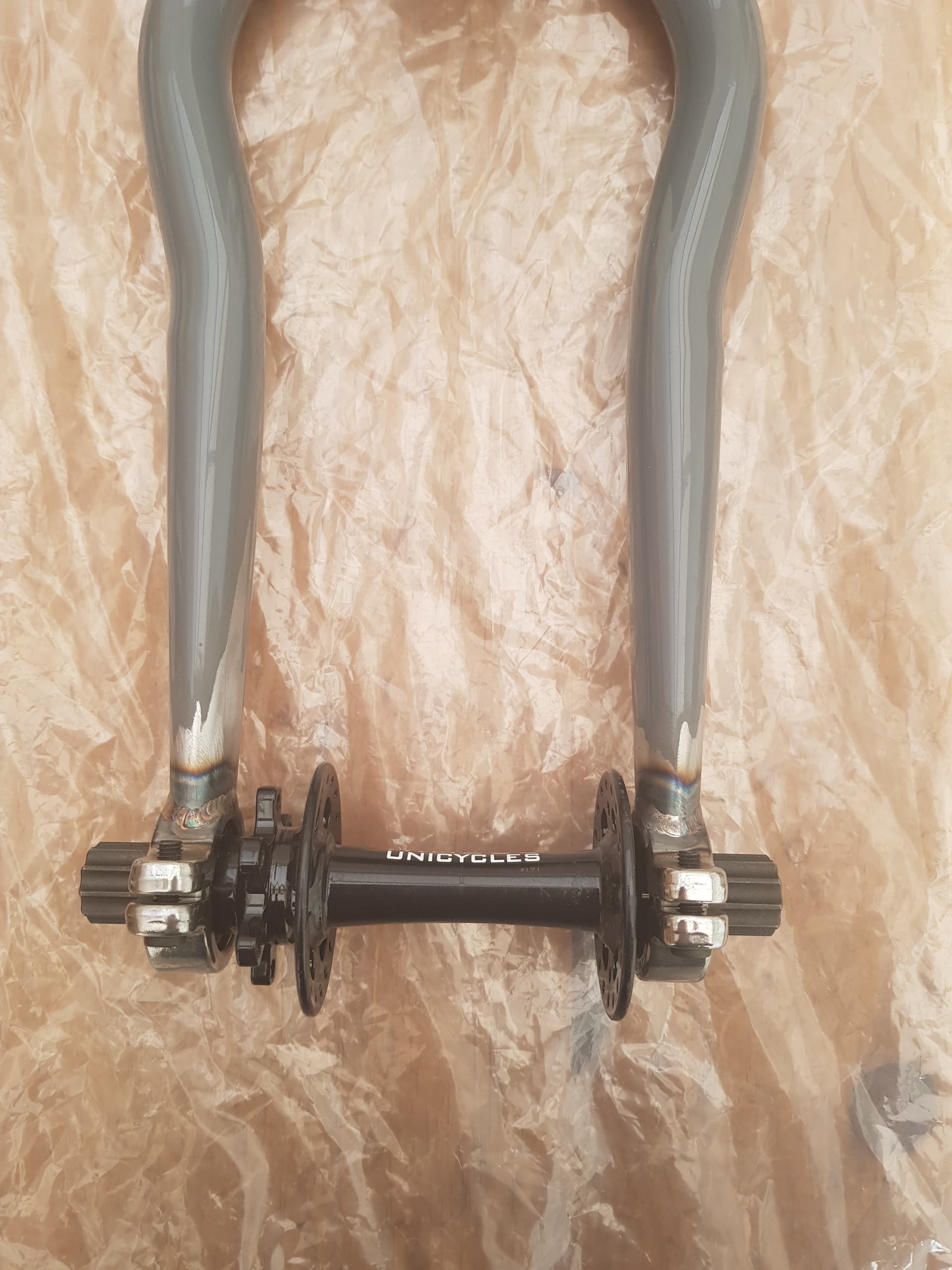

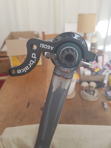

I am too short to ride anything taller than 20" and I want to get into Muni. So I looked at the Hatchet Mini and really the thing that turned me off was that it has cotterless cranks, not ISIS, and really no Muni should have cotterless. Is there a way to convert it to ISIS?
Where are you ?
I have some second hand unis available in France
Replace the hub or replace the wheel. Mount ISIS cranks.
The Hatchet is a beast, stock 26" will tackle just about any trail you put in front of it, unless it’s concrete lol. Concrete distance rides on those wide tires will wear you out really quickly. Since you’re fairly new to the uni game, I agree with quite a few folks above, check out something more in the middle. Check out the Nimbus 26 or 27.5 options. If you plan to give both muni and distance riding a shot, you want a grippy, but semi slim tire, 2.5 - 3 inches wide. Chances are that if you decide to stick with the sport, you’re gonna want to upgrade in one or both directions. So don’t overspend now. Get a semi casual bigger wheel that can comfortably tackle different terrain. You’ll have a brake mounted Hatchet 26" and a Nimbus 36" in your collection before you know it.

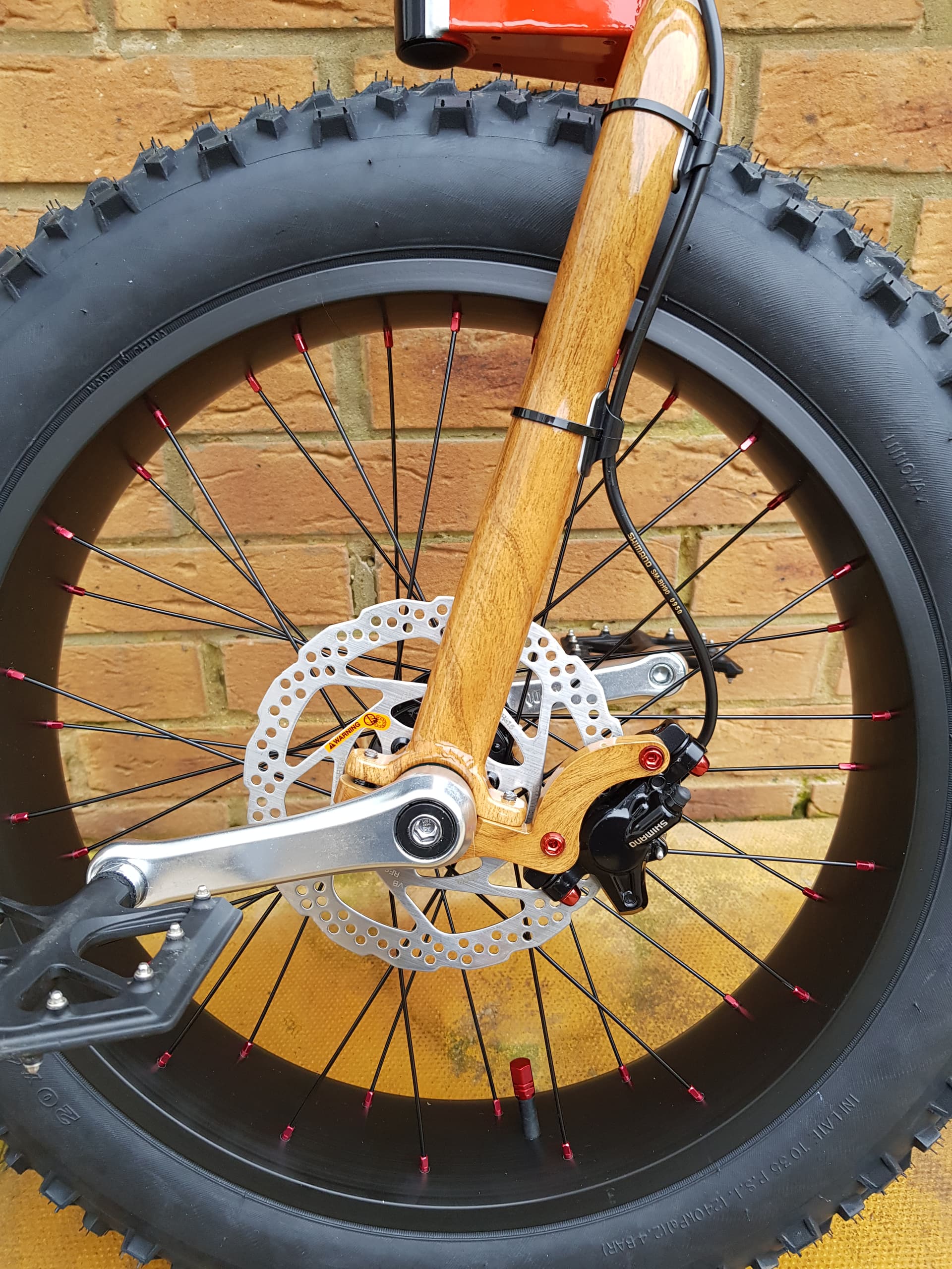

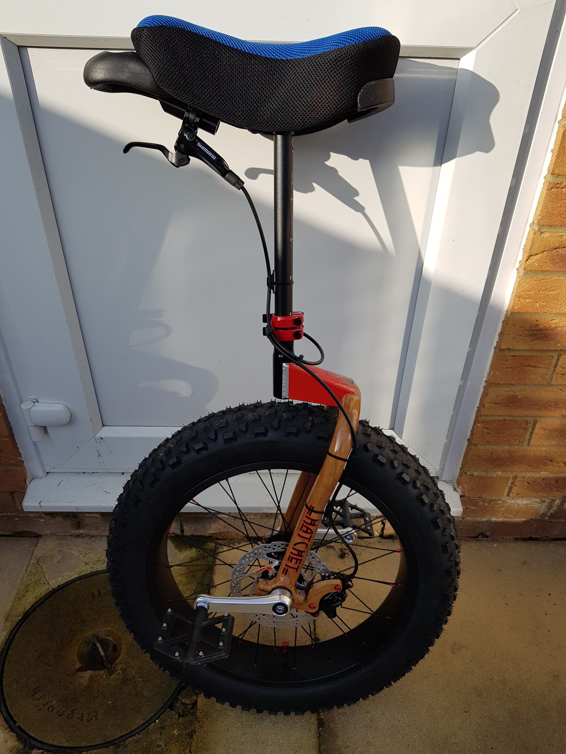

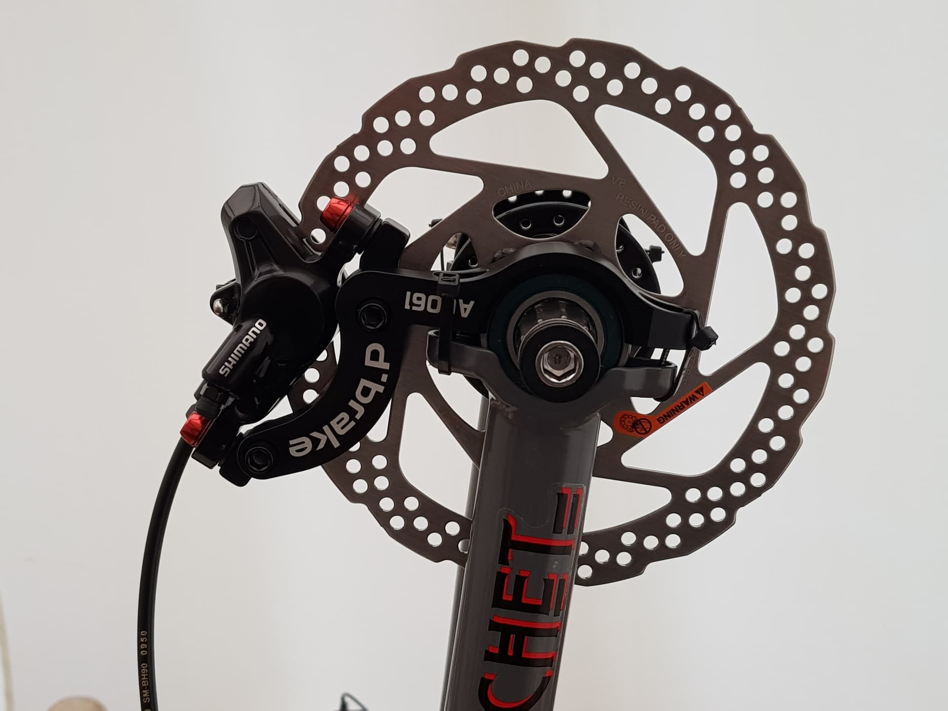

@ManiusTerentiusPullus. Yes you can convert the cotterless to ISIS. You have 3 options that will work. See photo. Full ISIS brake nimbus conversion. It all fits just fine 160 or 180mm rotor.
