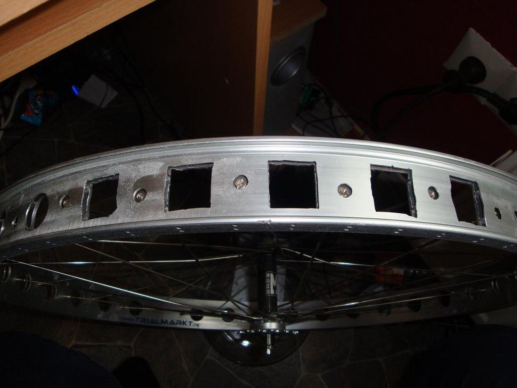

For the weight:
  • Drill out the rim
    If youre only riding XC and not really hard dh, it should work. Do what the biketrialsrider do :smiley:
  • If you find the tire that suits you, go tubeless.
Thanks Marco. The rim is holy already (TryAll 26"x47mm) so no need for drilling. But for tires there are a lot of options out there. Kind of hard to decide for one over another.
I’m also wondering if wire bead is always better and often there are different rubber compounds available too. Sometimes there are also performance versions that cost much less than the other ones. I wonder if they’re any good for my purposes. Now if there was a white TryAll Stiky available anywhere I think I’d give it a go.
Like this?
:wink: You can even safe a little more weight when making the square holes bigger.
Haha, that’s extreme. Na, I’ll just keep my rim the way it is. It’s light enough like that, I think.
