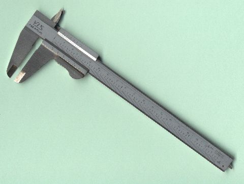

I measured it with this
Fit the tire in the jaws.

Flattening the tread and measuring across the max width of the knobs yields 2.8" for the wide row, and 2.34 " for narrow row of knobs. So I don’t see any way to make the tread pattern 3" wide, a wider rim could only move out the sidewall some.
