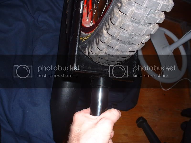

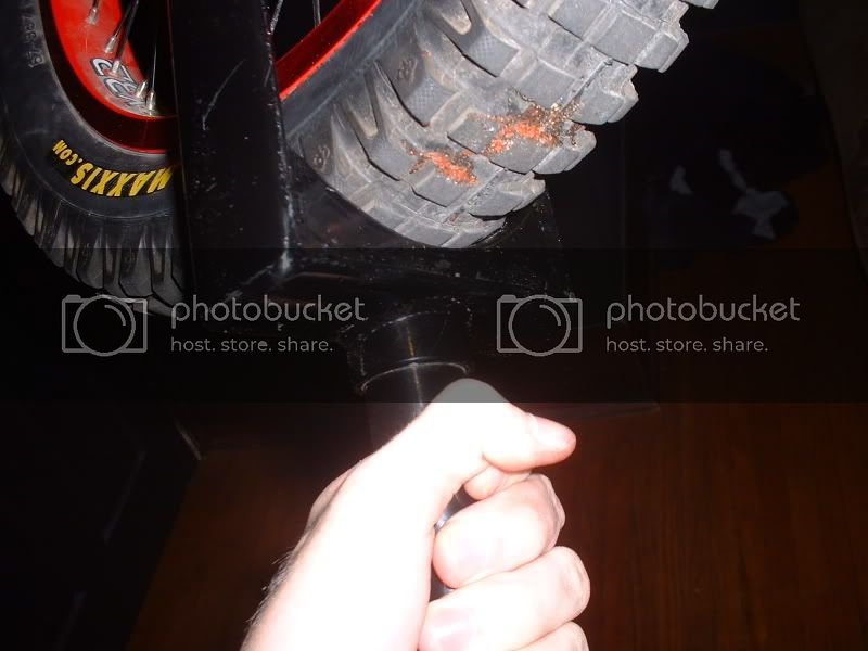

Shortened DX Frame.
Took all of like 20 minutes.
Hacksawed the frame legs. Grinded a curve in the bottom of the legs at equal length much shorter than original. Welded with crappy fluxcored welder. Grinded down hideous fluxcore welds. Next step, someone buy me a MIG and a TIG welder with actual settings, not 1-4 on heat and 0-10 on feed.
There is about 2mm clearance. 1mm at the bob in my tire, time to true up my wheel.

Thanks for the support guys!
My issue with the frame was… I’ve been trying to learn wheel walking lately.. and all the paint on the corners of the frame crown has worn off… because my feet hit the frame. This makes it very hard for me to learn wheel walking… as my feet kept hitting the frame and not the tire… maybe I’m not doing it right, but I know when I learn gliding later on… I’ll have even more problems…
Anyways, it looks much nicer now. When I get it painted sometime in the next 20-30 years, I’ll post up some pictures of the whole unicycle. I also cut off and ground down the brake mounts… who the hell needs them? plus they wouldn’t work now that there is… 1.5" taken off of both frame legs!
Also, if I get a new tire, I’m going to have to shim the wheel for sure :wink: But I plan on running this one till it’s a slick.

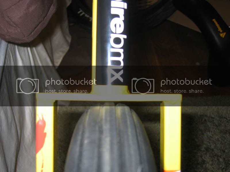

I’ve got you beat on clearance
Lets see you put a trials wheel in there :slight_smile:

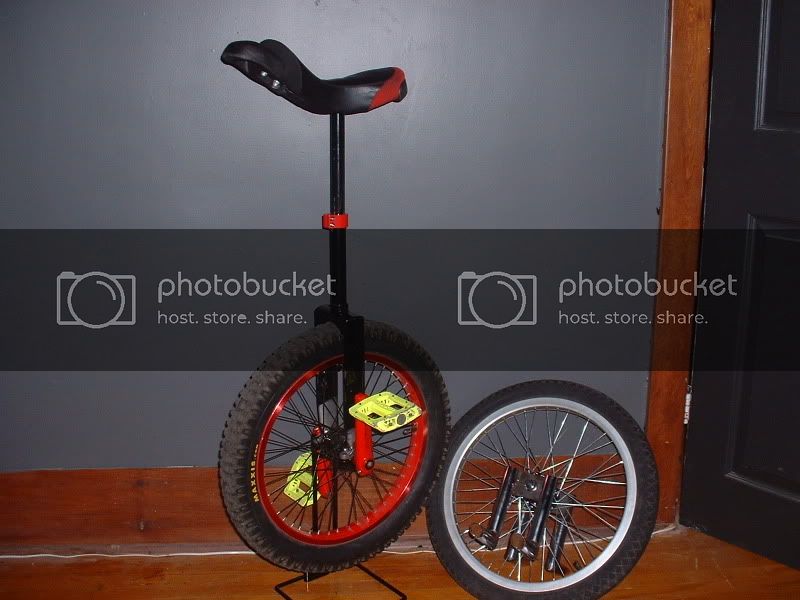

Ok, fine, I’ll post a whole picture of the Unicycle and my BC.
Most of the paint up to half way up the legs has been destroyed from welding it, but I want to repaint it anyways, maybe orange just to spice it up.
