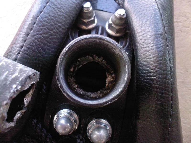

Pele.. you should take a picture… for some reason… my brain is not registering what you are talking about…
P.s. I think i could fix that seat post

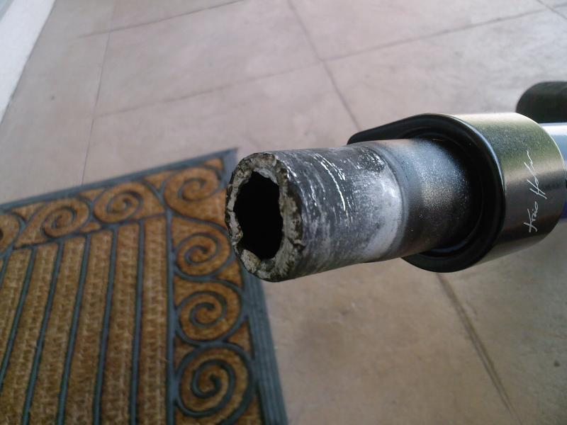

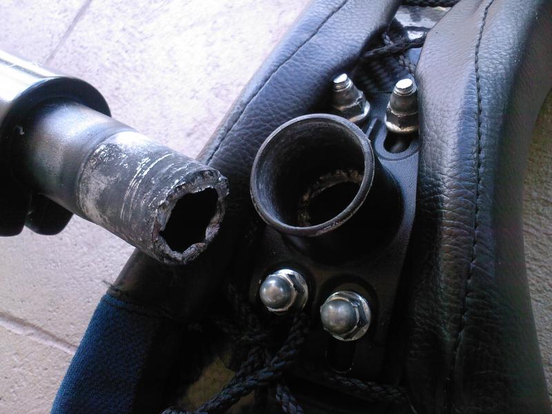

I was looking at the post and saw that they were all breaking in the same place with the exception of Peles and was thinking that it would probably be a good idea to have that neck slowly fuse into the post.
I’m working on some solutions. Since the forged piece isn’t breaking, improving the join shouldn’t be too hard.
Note - all 2009 KH forged posts (those that arrived in shops in Jan’09 or later) have a pin reinforcement across the join between the post and the forged top piece, in addition to the weld, to help resist twisting that seems to occasionally break the weld.
If you have a post like this and it breaks at that weld within the 1 year warranty period, yes it’s subject to warranty. Just send it back.
Kris

That sounds broken to me - you should send it back.
Kris

mine broke exactly the same as that
mine broke on a douleback too
Is this covered by warrenty then? do i need to send it back to unicycle.com?
