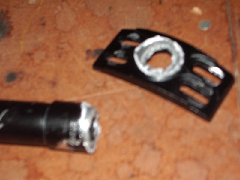

Bad news about the KH forged post.
Today I found something terribly wrong. The forged piece that slides over the post itself has recently started wiggling on the post a bit. I’m afraid it will break off completely soon.

The new post has a 1-pieced forged top plate with a sleeve. The post part presses up into the sleeve and is welded on the top side (the side against the base of the saddle). The weld is required to resist twisting inside the sleeve, but unlike the old post it is not needed to resist front-and-back breakage. I haven’t seen it yet, but that sounds like a warranty replacement to me (e.g. a faulty weld). Pele- let me know when it breaks.

It broke today…
But it didn’t break were I thought it was broken. Instead of the sleeve coming off of the post (which is what I was SURE the problem was), the forged piece broke were the old welded ones usually break (except it broke COMPLETELY off, instead of just one side).

Niles broke his too:
Here is how mine broke

did the weld at the top of the plate not penatrate the seat post ?
to me it looks like the post was pressed into the base and welded but not very well.
huh?
It was… Until it broke. No welds or anything.
