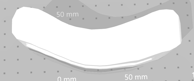

Design Started
Guys,
Here’s a first look at the design we are looking at. We will likely print it this week, and then just try it out for feel. It will have foam padding added to it. I’d add the STL model file to provide a 3D look, but the forum won’t allow that kind of file.
This is a copy of a seat we have now. It is, I believe, a “nutcrusher.” Net steps would be to flatten out the front to make it non-nutcrusher, add curves (a radius) to the top of the sidewalls for comfort.
-Andy
