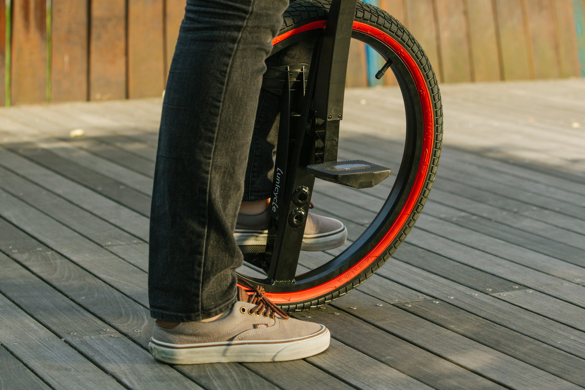

Keep in mind that the shin guard things serve a second purpose - getting your feet closer to the ground. Basically like a “dropper pedal”. I think this might be the biggest benefit to helping first timers learn to uni. The only bad part I’ve noticed so far is, it feels a bit weird jumping off of… like you’re a bit locked into the thing, at least from a beginner’s perspective.

I also don’t like the design of the leg braces. They seem to assume that you are going to put your ankle over the pedal… does anyone actually ride like that? Fitting into the calf brace almost requires bending your legs a lot to angle into them, but I still kept popping out and having the curved edge of the brace dig into my leg.
Also, at least for someone without any experience of classic ultimate wheels, the narrow “Q” is disconcerting.
I’ve half a mind to take the tops of the leg braces off, try to bolt some aluminum risers to the rear side of the pedal hangers (so closer to the ankle) and top those with some poly cutting boards (perhaps faced with pieces of camping pad) that would provide sideways stabilization and shield against tiring rubbing, but not try to capture the leg and constrain its angle and position.
And yes, I’m more than a little tempted to try the drop pedals on a normal unicycle wheel and cranks (maybe even a 26") though that would probably cause the opposite Q extreme.

Personally I would have preferred if it were round, in fact I may try substituting the wheel from my 20" to see how it compares.
I’d also prefer if it were a bit larger, maybe 24", I suspect the size was chosen for manufacturing/shipping cost reasons rather than ideal performance. Apart form the oval it seems to have strong heritage to a UDC type ultimate wheel, wouldn’t be surprised if they started by experimenting with the pedal mechanisms on those.

Aside from that I am sceptical about the egg-shaped wheel, which probably slows down the rolling. For UW you need a certain speed to keep going or the wheel will flop and with that it will give a good speed I guess.

If the threads for the foot cradle thing are the same as a standard pedal it would be interesting to try the oval wheel with regular pedals, or the foot cradles on a standard round Ultimate Wheel to see if the oval thing is useful or a gimmick. I haven’t played with different unicycle setups for quite a while now but this shows promise :slight_smile:
