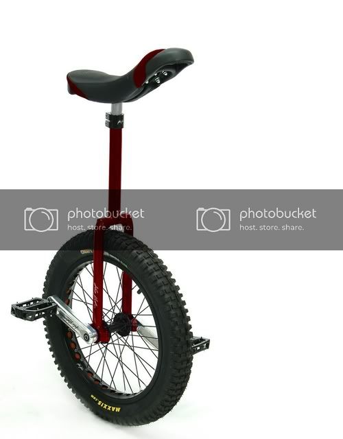

It is a curved post. I used to cut the insides of my knees om my Onza crown. It is shaped just like the Qu-Ax, Koxx and Nimbus crowns. I note that the weld is not round but that the seat post tube is notched at the botom so that it fits over the top of the crown. This improves strenght. Another way to improve strenth would be to cut a hole into the top of the crown and slide the seat tube post into it and then weld the seam. This way the weld is not at the end of the tube. Whatever happens, I don’t want to see the basic shape of the crown altered.
Unicorn
^what you described there is pretty much what the Black Domina crown is.
Like this:
But… not fook it up like Koxx did.
eh im pretty sure thats the signiture frame and not the black domina…
Uhm, the black domina has the same welding :roll_eyes:
Just black paint over it.

No what I discribed is not the same. I said cut a round hole in the “top” of the crown bar. The crown bar would still be one whole bar and not a right and a left like in the KOXX models. The botom of the seat post tube should also be curved to fit snugly onto the botom of the crown bar.
Unicorn
That’s what the 1999 red KH frame was like. I’ve thought about it but the challenge is that if you increase the diameter of the top tube (to allow the seatpost tube to fit through), you would need to also increase the diameter of the fork blades accordingly (so that the fork crown weld fits properly at the corners of the fork crown). Right now there is a good balance between the two, and I don’t want to change that. An alternative might be to hydroform the top tube so it is non-uniform in diameter, but that would add quite a bit of expense. It would also mean that the tube angled slightly back towards the edge which would not be quite as good an angle for keeping your foot on the frame for gliding.
