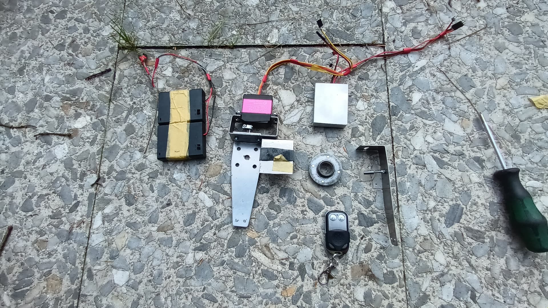

Just to prove it is possibel
A few parts for my old schlumpf
Put off the Button
put on a long m3 nut on
put on the mountingplate, it is just screwed into the crankpuller thread.
put on the servo ( i built two microswitches inside, it is moving 360 degree and is stopped with the switches in the two positions of 180 degree)
put the lever on
put the batterie 12v/6v and the receiver on
position high gear
position low gear
looks a bit like a fluxcompensator.
The batterie and the receiver are too big.
A for shift down , B for up.
I allready tested it and it works, so it is possible, but i think it is really unnecessary.

Impressive ingenuity there! It took me a moment to work out what you were trying to automate, then a realised it was the gear changing element of the hub.

Not to discount your technical skills but can you tell us about the frame and bearing caps?
It’s an original Schlumpf frame.
Ok, Very interesting I have never seen one before. Thank you.
Yes it is a Schlumpf frame, but the tubes are not orginal. The orginal oval diameter are really hard to get.
