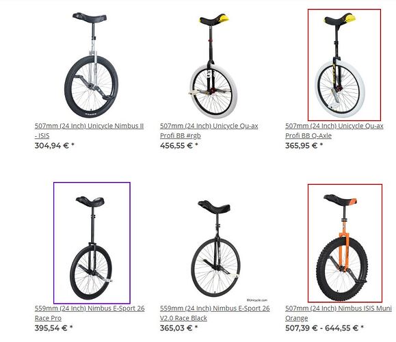

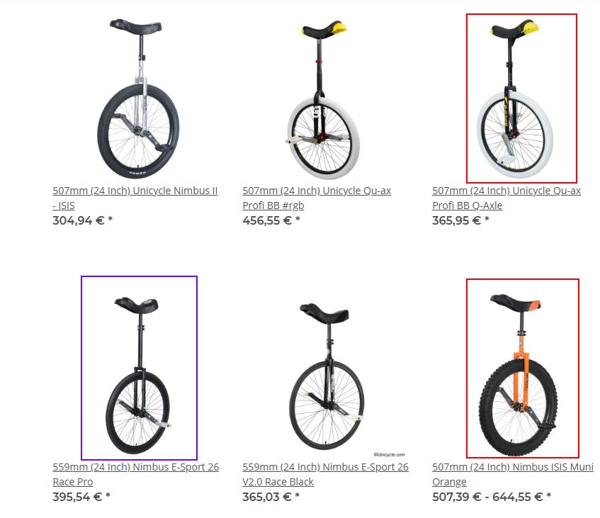

Yesterday my wife asked why I don’t sign up for the Dutch unicycle competitions anymore. I only did the 10K in 2019 with a 32" uni. So I figured I can try the 5K run with a 24" uni in 2027.
I currently own the 2 uni’s on the right in the red squares, and I wonder how much speed I could gain with the E-Sport uni in the bottom left.
I suspect that the sport uni is more twitchy and it still depends on my legs in how quickly I can make the wheel rotate. So I have my doubts in how much speed gain I would have on it. Also I am around 90kg and Im not sure if the wheel can handle my weight.
The E-Sport will have an incredibly light feeling wheel which with practice can be spun very fast. For example the Duro tyre on the 24" muni is 1.5kg, the tyre on the E-Sport is 300g.
Unfortunately don’t have experience with the E-Sport (UDC UK doesn’t stock them) but have spent time with a 700x28c. It requires a different riding style as tyre foldover (even at 100psi) is a thing so you learn to not cold steer. It holds zero momentum but is lighter than a freestyle.
90kg might be OK for the tyre, it might not. I suppose it’s going to depend on the surfaces you plan to ride it on.

The Quax Profi is already pretty good. Although the E-Sport is optimzed for track, the difference is really not noticeably until you really learn to spin fast. As has been stated above, there is a minimum crank length of 125mm. So one of the high-end optimizations is getting a tire just under the maximum diameter. The E-Sport will have this. As a cheaper alternative, I would try and find a tire for the profi that will be just the right diameter.
Oh: I’m pretty sure the E-Sport should do fine with 90kg. Frame is strong, just need to keep the spokes tuned and tensioned.
Note: I have the E-Sport with the 24" tire (not the track version with the 26" wheel), as a) I’m slow anyway and b) the 26" narrow wheel is not good for much else like wheel walk.

There are some subtle differences between E-Sport and Mad4one Race (I have both, and I am a bit disappointed by the limitations), but these differences are less obvious and less critical. Both use 26x1 tire anyways.
Basically, you raised a higher-level question: is 26x1 solutions better than 24x2 for you to compete. For you, I would say probably not. You seem to already have a competition-grade 24x2 uni, and it should be fine.

I understand with muni you will want lower pressure to more easily traverse bumpy terrain. My 24" is the freestyle version (top right in the picture of the first message in this thread).

You would not gain much speed with the E-sport, compared to the Qu-Ax. The wheel being lighter only matters at the start (acceleration), and the wheel being slightly larger results in only 1 or 2% top speed increase. The Muni tyre is probably larger than 618 mm (outside diameter at riding pressure, not loaded) and hence not allowed at the Dutch nationals.
Your best bet to gain speed is not to spend money, but go out and practice. Even if you plan to participate only in 5K, do practice sprints, as it brings your base speed up. That said, if you are going, I recommend that you also register for 100m and 800m, because why not.
