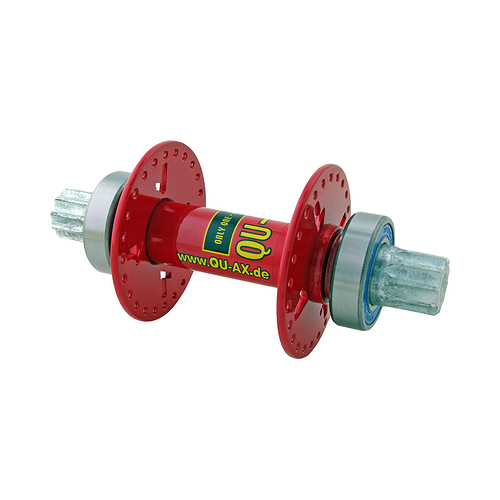

The only source I see for 48 spoke parts is from QU-AX. They have yellow and red hubs. I don’t know if there is any difference other than color and price. They also have 24" rims with 38 and 45 width. Anything else available out there somewhere?
I have had old square tapered trials unicycles, all chrome with 48 spoke rim setups. Only QU-AX seems to have a 48 spoke Trials uni. Why are these becoming rare?
The difference between the red and yellow hub is their strength, the yellow one is mor heavy duty. Nimbus also has 48 hole hubs available, just not complete wheels as far as I am aware.

Do you know what is the actual difference, other than price?
I could only find the red model listed on the Qu-Ax site.
In the specs I found at another site they were virtually identical. Both CrMo axle and flanges. The Red is listed as five grams heavier. They look identical except for the colour in the images.
http://oddwheel.co.za/shop/brands/qu-ax/qu-ax-yellow-isis-48-hole-hub/
Probably uni hockey? The tennis ball does not get stuked in the narrow distance of 48 spokes.
I’d think they use different grades of steel, possibly the yellow one is hardened, while the red one isn’t. You are right, they look identical side by side, and are probably the same shape.
But maybe QU-ax has been tricking us and sold the same hub for two different prices for years.
Both are 22mm axles. The yellow one shall be made from better material or hardened or sth. like this and thus, has a lager hole through the axle that makes it lighter.
red: M8 bolts, 810g (incl. bearings)
yellow: M12 bolts, 805g (incl. bearings)
The calculated difference between M8 boring (6.8mm inner diameter) and M12 boring (10.25mm inner diameter) shall be a bit over 40g. So when the yellow one is only 5g lighter, maybe they used the remaining 35g to stiffen it at some other point?
