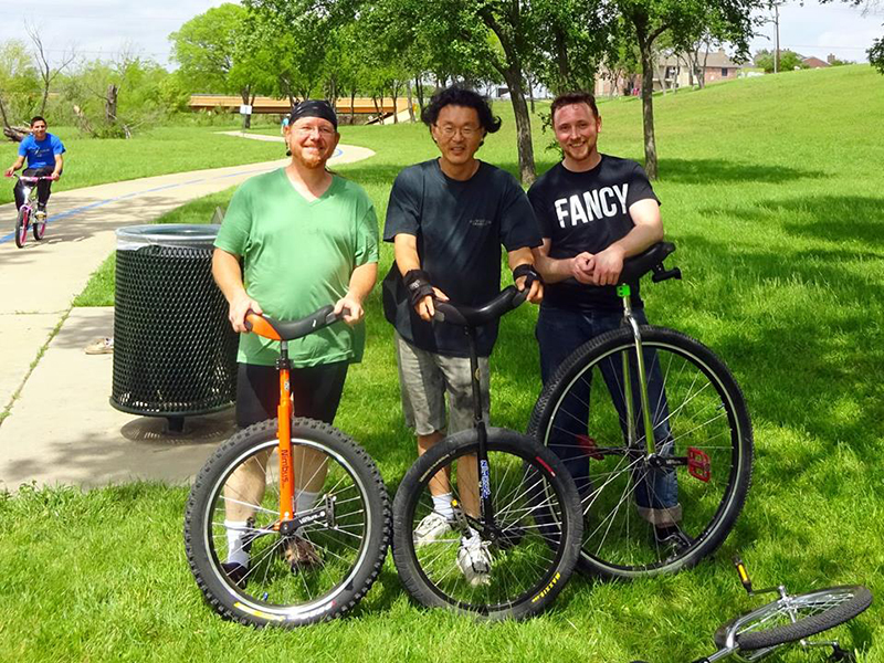

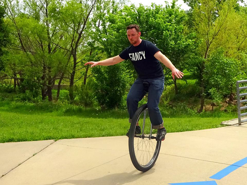

I checked out the DFW Unicycle Club’s Facebook page today, and Katsu, the guy in the middle of the 1st picture below, owns the 36" and posted pictures of us and my friend Nick riding it in the second picture (darn him and his longer legs!). :slight_smile: Maybe someone will recognize which 36" it is.
Was the seat post as short as possible?
If the unicycle was only about an inch too tall as is in the picture it should be quite easy to get a standard 36er to work for you with minimal modifications.
A non-adjustable standard welded seatpost (with no collar) could be all you need to get the seat low enough.
KH freeride is also one of the thickest saddles available. Going to a slimmer saddle would also make a difference, but you don’t want to get anything you don’t find comfortable.
