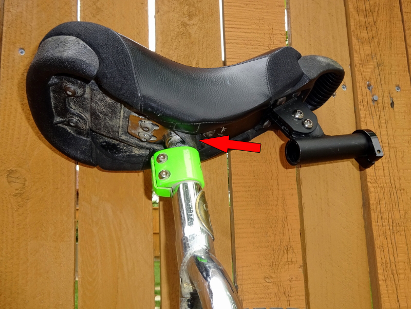

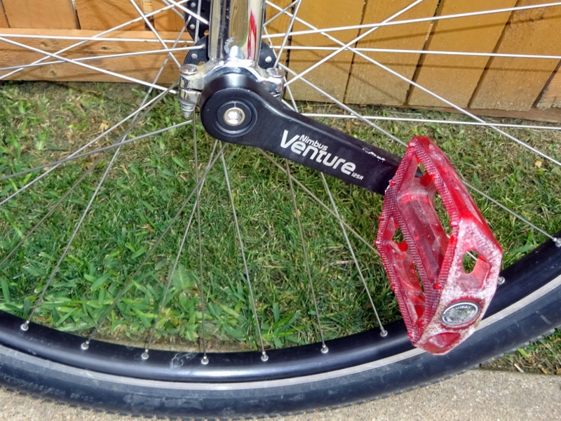

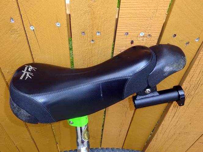

Bradford the 36" I brought to Carrollton Greenbelt Park was the Nimbus Titan. The saddle is Kris Holm Fusion Freeride and the cranks are Nimbus Venture 125mm (square tapered). I originally had 150mm cranks on this but after switching to the 125mm cranks I raised the seat post an inch or so, to compensate for the shorter cranks. Here are some close up photos:

It’s a little hard to tell from this angle, but if you look at the photo below where the red arrow is, you might see a small, black plastic part that hangs down from the bottom of the saddle, just in front of the seat post that is in direct contact with the seat clamp. If it were removed somehow (not that I would recommend that), or if a different saddle were used, I could imagine the saddle sitting a little lower. One of these days, I’ll make it up to your meetings. I’d like to meet everyone and I’d certainly like the opportunity to try out a Nightfox.
So the saddle could have been set lower since it was when longer cranks were installed.

The piece hanging down under the saddle is probably part of the seat cover. In any case with how it is set up at this time with the 125mm cranks, the seat can still be lowered one more inch. But that’s about it. It may or may not work for you.
150mm cranks give you more control whereas 125mm cranks give you more speed. There is always a compromise, but yes it might be good to start out with 150mm cranks, which is what I did.
Oh, OK, cool. I didn’t realize that it could be lowered another inch. I saw that there was some seatpost exposed above the clamp, but I thought the part I mentioned was preventing it from going lower. Good to know!
