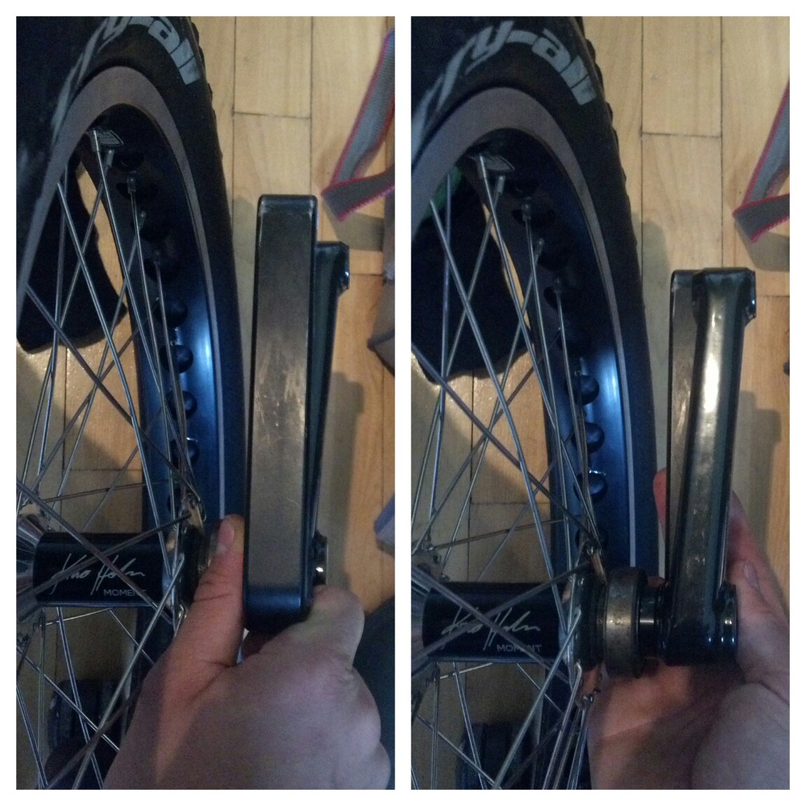

Also Moments (137mm on that uni) have a couple mm more Q-factor and Spirits one or two more than that. It seems most don’t like QF, I do. I’ve ridden cranks w/ much more QF than Spirits and never tried a crank that had too much for me.
I am not a huge fan of cranks with no q. But I broke a 2012 frame so I can’t say much

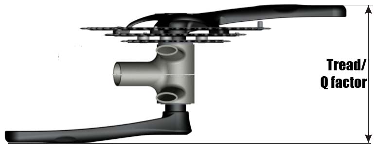

  1. what is Q factor?

Q-factor is how much the crank bends outwards. So if it has zero Q-factor, the crank is completely straight and if there’s 10mm Q-factor the pedal end of the crank is 10mm further away from the hub than the other end of the crank. Generally a bit Q-factor feels more stable when doing for example trials.

  1. The distance between both pedals.
Here is the difference between q-factors
