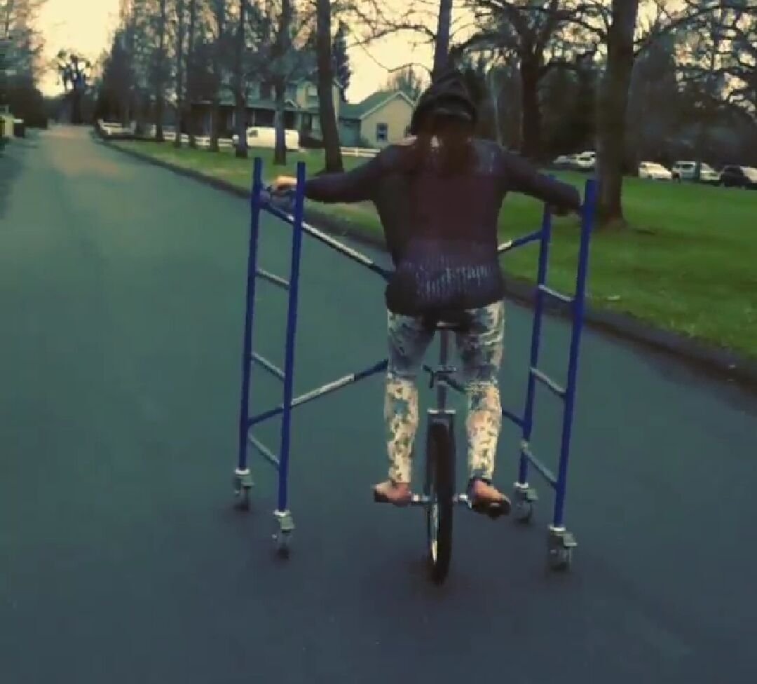

There was also another interesting idea which is shown above, which uses some sort of shelf with castor wheels.

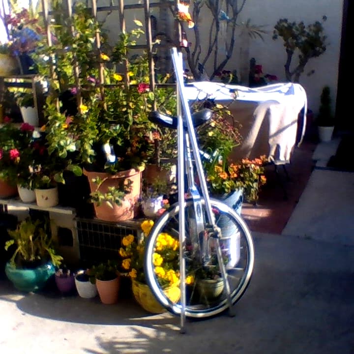

Schwinn’s answer to Unicycle assist training in the early sixties, Springy Poles.
(John, do you remember these?)
A chap I work with said he used walking sticks as part of learning how to unicycle. He also did most of his learning on grass, which is pretty difficult. I remember trying to unicycle on grass when I was learning, and I just kept on sinking in and getting stuck on all the imperfections.
Stick/poles may be a good way to learn, as it simulates two people holding you. You still get a lot of wobble and you can gradually reduce the assistance as you grow more confident.
Although now I am thinking, has anyone got a pole in the face!?
These Schwinn training poles are telescoping and have a really long screw and a spring inside and have about 6" of compression. Of course you could get one in the face or you could “Face Plant” without them. Unicycling is about taking that chance out of your comfort zone, or just ignoring taking any chances and being a “Milk Toast” all your life.
